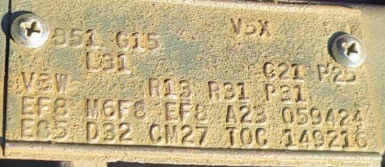

E86440-4 Barrel High Preformance
D32H-D A-727 TorqueFlite Trans / Some Years A-998
CM27C = Chrysler
M = Medium
27 = Convertible
T0CT = Unknown
0 = 1970
C = Jefferson Avenue, MI, USA
149216Sequence Number '149216'
EF8Paint Code: Dark Green Metallic
M6F8Trim Grade/Style/Color
M = Medium
6 = Vinyl Bucket Seats
F8 = Green
EF8Upper Door Frame: Dark Green Metallic
A23Date Built: 10 / 23 / 1969
059424Order Number: 059424
V3WRoof Type OR Color: White Convertible Top
R13Astrophonic am radio
R31Duel Rear Speaker w/ R85
P31Power Windows
L31Hood / Fender Mount Turn Signal
C21Center Seat Foldown Armrest
P25Power LS Bucket or 50/50
B51Power Assisted Brakes
G15Tinted Windshield Only
V5XBlack - Mouldings - Protective Insert Body Side

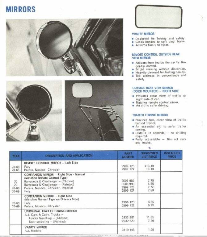

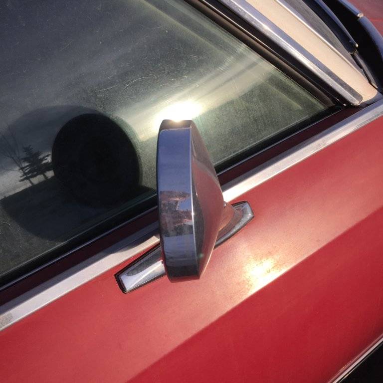

Easy to tell if it's a dealer added mirror. If you see screws, it's dealer added. No screws, it was probably assembly line.
Assembly line mirror:
Dealer added mirror:
From the 1970 Dealer Accessory Catalog, Page 20.

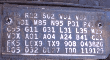

@Ruger 's loaded FK5 1970 Polara 'vert, DL27T0D119129 , has the G31 fender tag stamping -- see here
Those cars are both Belvedere-built. The approach taken at other plants is known to be different (Belvedere and, especially, Newark tags are way more talkative than the Jefferson Ave ones).

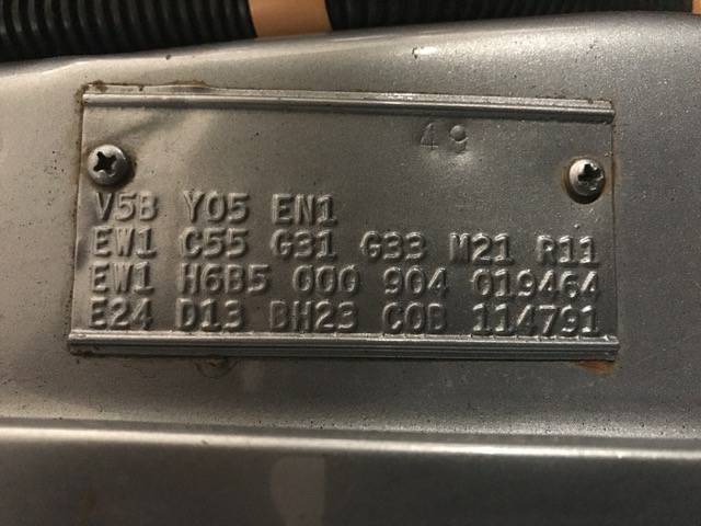

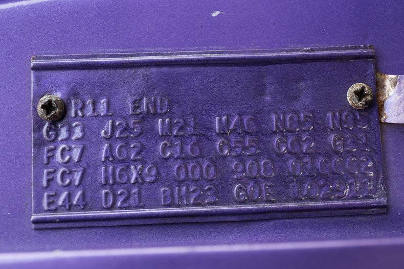

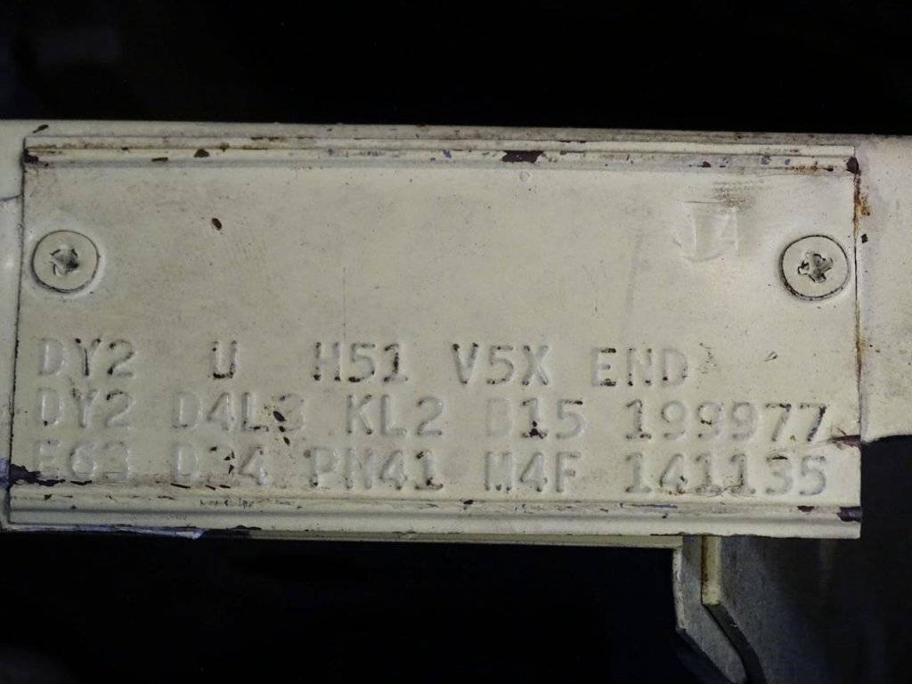

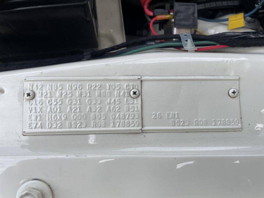

This is probably not relevant to any of yal C body fellas but the Hamtramck plant would sometimes put G31 on the tags.
Also the LA plant would put G31 on the tag. The purple car is an M46 car. That's what I am always looking for, M46.
For the majority of the time the G31 will only be listed with G33 together on the tag.
That should be across the board for A,B,C and E body cars.

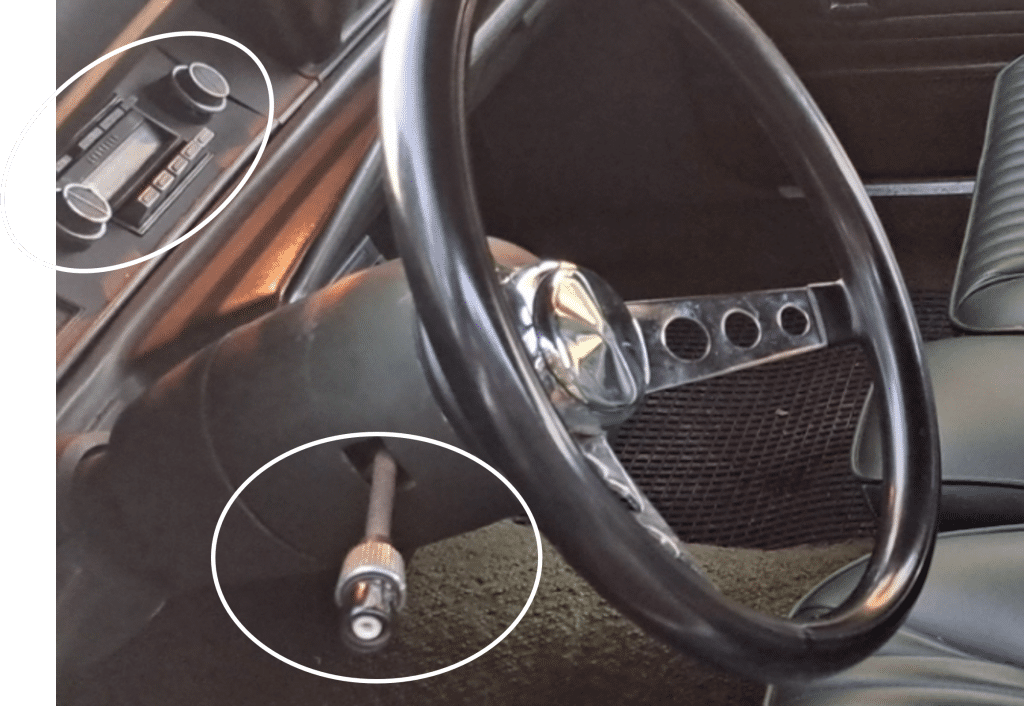

Now I'm "twisting the knife" but my 1970 Three Hundred doesn't have the Auto Speed Control code N88 on the fender tag either. And ASC seem original in the engine room and interior. My car radio is "Search Tune AM/FM Radio (5 1/2 Watts)", code R23 but in the tag it is R13. There is lots of mistakes in my car's tag or they are misinterpretations on my part.
