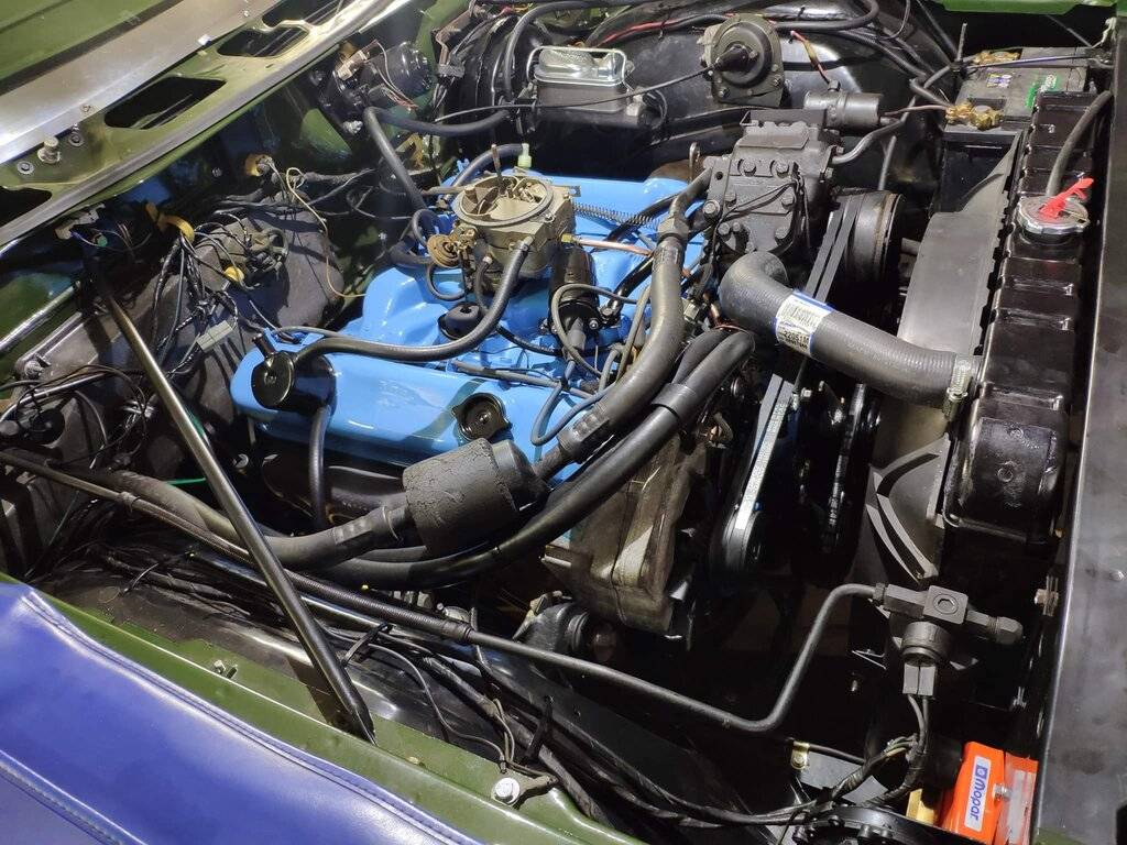

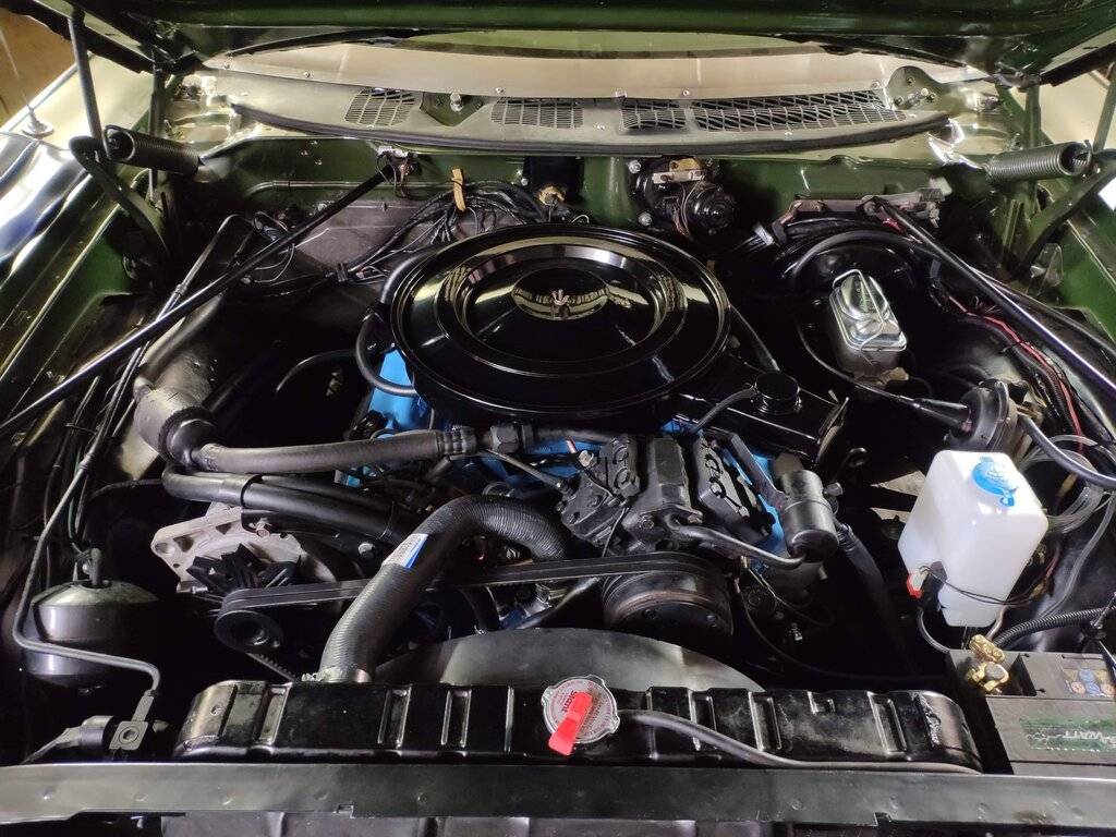

That retaining spring set up looks weird to me! Is that the position it´s supposed to be ?
At my car there´s no tension on the spring as long as the throttlepedal is untouched. As soon as
you push the pedal it´ll extend. The one at your carburator seems to be extended permanently so
it might snap into pieces after a certain time ( maybe months, maybe years ). You don´t
want to deal with a snapped retaining spring when cruising at 60mph that really messes up your
day.
day.
That isn't too unusual for the longer springs on the two barrel carburetors that have the high number of coils but I do believe that use of a secondary spring within the primary spring to help close the throttle when the larger springs do eventually break and you otherwise go to WOT right away - Chrysler started that practice in the 1974 and up era as I recall for safety reasons, and I encourage doing it on our older models too to avoid a very bad day as Marv says above. When I restore my cars, I do use new primary springs that are still available from nos suppliers where the springs are not fatigued due to many cycles and I do try to add a secondary lighter spring that does increase throttle pressure a little, but it is well worth it IMO.
That´s what I did as well. I tried to go with a dual spring set up but it increased the pressure that much that it became uncomfortable to drive on a longer journey.
So I went back to a single spring, brand new hoping that the quality is good and not having to deal with unexpected material fatigue. It either works or it doesn´t, no sign of deterioration. Just like the master brake cylinder. Never be cheap on those essential items !

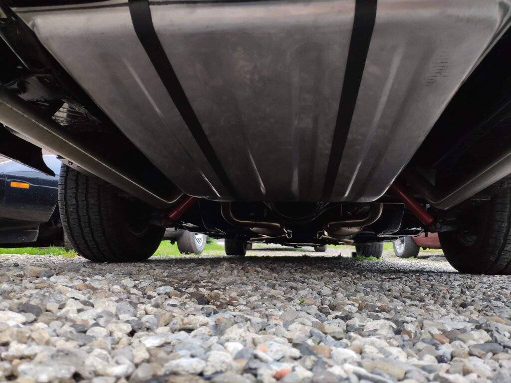

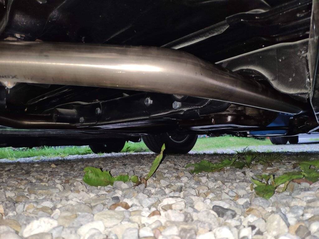

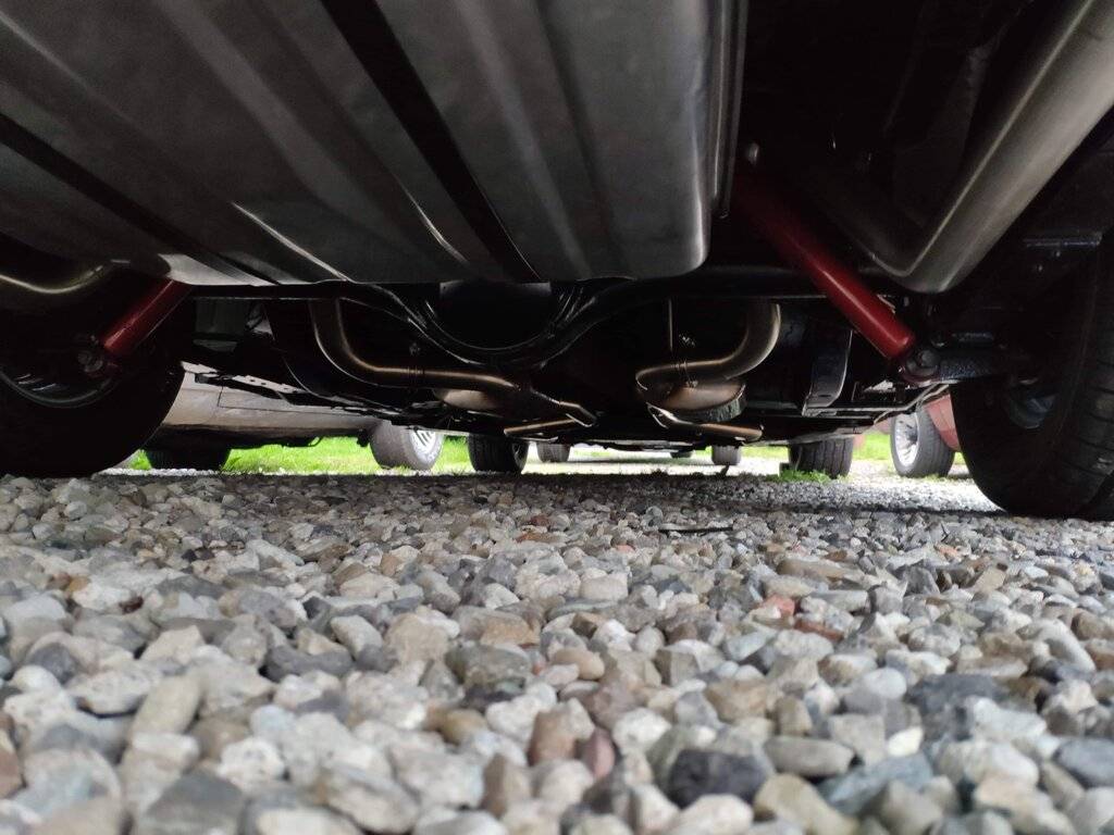

Custom made dual stainless steel exhaust ready to go - original style :) . The shop has almost finished my ride, just going to have the driveshaft remanufactored and balanced, and thats gonna be it... looking sweet.
