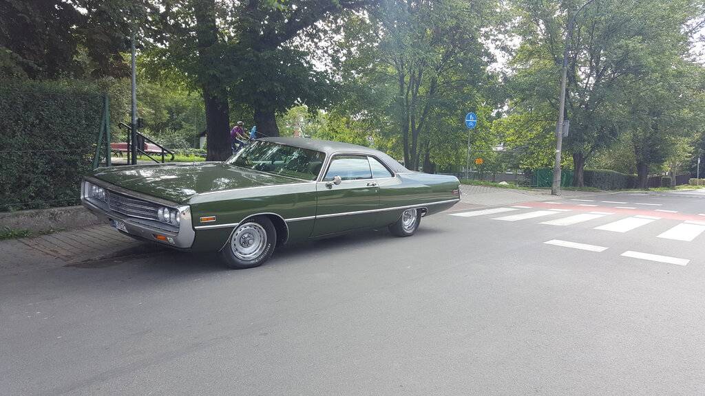

1971 Chrysler Newport Custom 383, rebuilding in Europe
Cruising along with my friend the other day. He has a nice early 2gen Firebird (a 70 i believe), and is currently rebuilding a 72 Ford Torino Sport. Nice day out.
hey!
I've almost done 800 miles since July :)
Yesterday when parking the car, my daughter noticed something dripping from the back, and sure enough i'm losing gas... upon further inspection after crawling under the trunk, it looks like it's going from the locking ring on the front of the tank. The tank is new, but i remember reading somewhere on this forum that the repro locking rings are sh** and better to use the stock/old one... well this seems to be the case. Have to get this sorted, there's a lot of fumes around the back now, wouldn't want the thing to go up in flames .

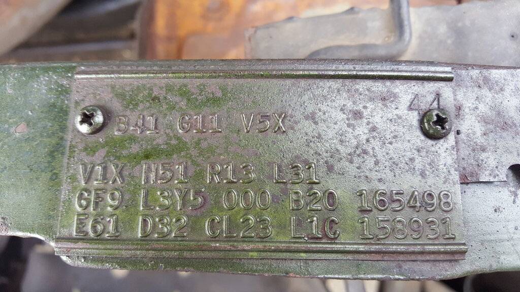

@Unix -- I don't think you've posted the tag for your car. I'd be interested in seeing it or, if you're not comfortable posting, at least knowing if the interior is S3Y5. Thank you!
Yes, thanks for reminding me about the TAG... the body shop actually forgot to put it back on, i haven't spoken to them yet but there's a chance they might have lost it (in that case i'll have a new one made). Luckily i have a photo of it.
Can someone please help me decode it?

Wish I'd seen your post sooner. Sorry you wasted your time on the decoding. Here goes, after editing slightly the suggestions of the automatic decoder at MyMopar - Mopar Forums & Information - 1969-1974 Mopar Fender Tag Decoder. I have added links to relevant pages from two great sites, Fuselage.de and the Hamtramck Registry:
CL: Chrysler Low (Newport Custom)
23: 2 Door Hardtop
L: 383 2BBL 8 CYL
1: 1971
C: Jefferson Avenue, MI, USA (auto plant)
158931: Sequence number
E61: 383-cid 2-barrel V8
D32: Heavy Duty Automatic Transmission
GF9: Avocado Poly (metallic dark green)
L3Y5: Trim - Low, Cloth/Vinyl Bench Seat, Gold
000: Full Door Panels
B20: Build Date: November 20, 1970
165498: Order number
V1X: Full Vinyl Top, Black
H51: Air Conditioning with Heater
R13: Deluxe AM Radio (5 1/2 Watts)
L31: Hood/Fender Mounted Turn Signals
B41: Front Disc Brakes w/Standard 10in RR Drum
G11: Tinted Glass (all windows)
V5X: Side Mouldings Vinyl Inserts, Black
