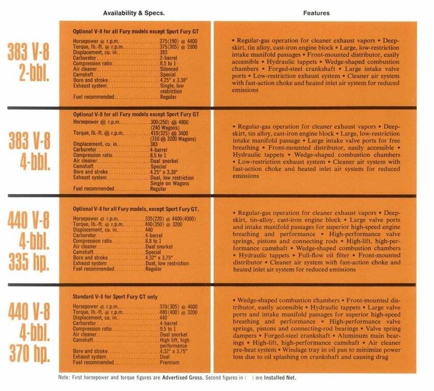

I am more puzzled by the dual snorkel on a T-code car (E85 engine). @robio — do you have the build sheet?[/QUOTE]
my 71 T code 440 Fury Custom Suburban (PM45T) has a dual snorkel which it came with from new.
heres the bigger 71 engine choices, you can see the dual snorkel was standard on the T code
View attachment 422108[/QUOTE]
Thats exactly where I was going .

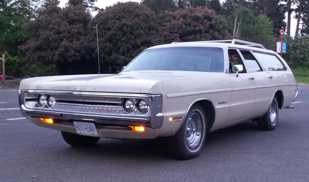

ive posted about it before, cant seem to find any links. 2 seat 6 passnger
factory 440 tow pkg, 3:23 s/g, dual exh, got original bill of sale, lots of records and the typical old man spiral wire bound notebook documenting pretty much everything
sand pebble beige w green interior
ive added green buckets and console shift from a 69 sport fury ( original split bench front seat was long gone)
Id love to check it out do you have a thread?
LOVE that grill
