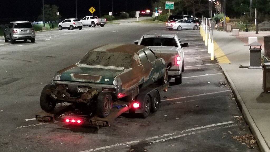

I will get some pics of stuff next time I am by her. I saw a button on the lower left side by the column, must be the trunk button.

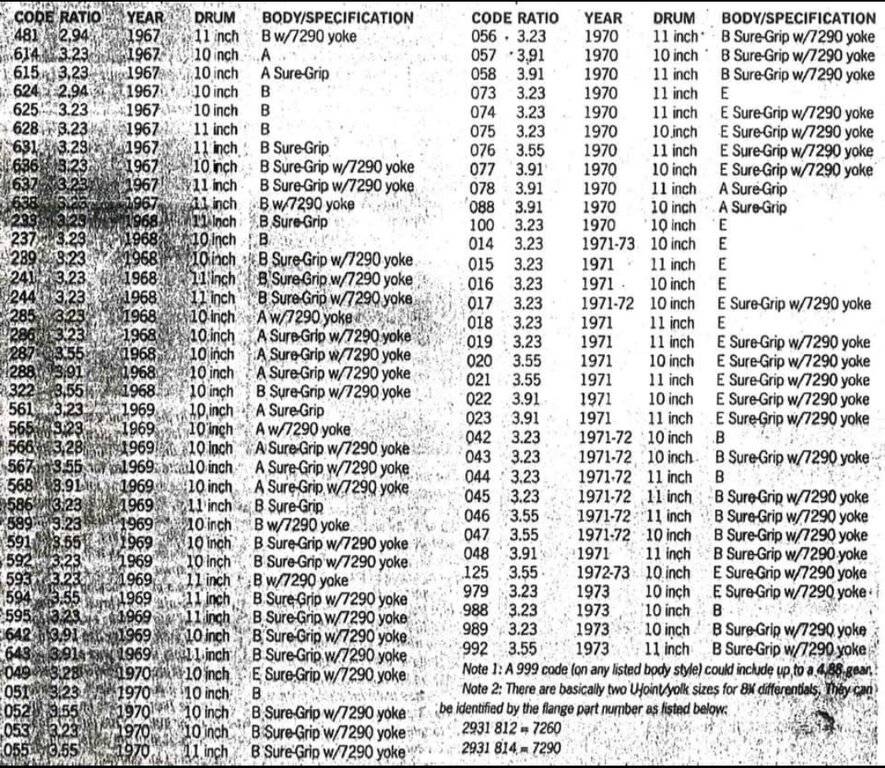

Ideally would like to find a list such as below for all '71 models. I dont know where one would aquire such a list though..
Not a progress update quite yet, but there has been some interesting discussion around here with some of the locals about this car.
The Roger Mauro dealership tag started some good stuff. That family was into far more than just a dodge dealership. One old timer pointed out that the mauro name is huge in Colorado racing history. I checked and there is lots listed online about them and their accomplishments.
Nothing directly related to this car, but might shine a light on why so many uncommon options and how it came to be. It is clear it is not the garden variety 71 police car. No direct proof, but maybe there were some knowledgeable people who understood how to get the maximum performance from the pool of parts available, and also knew how to get what they wanted through the ordering process. Makes sense to me.
I am working on trying to meet some relatives, and also some retired tires troopers.
More pics in a few days.

Axle sub-assemblies are listed in the book. However upon closer analyst the 8 3/4s are listed housings separate from carrier & gear (for obvious interchangeability reasons). All other axles are complete housing+diff assemblies. (section 3-03-3, pg 3-3)
http://www.mymopar.com/downloads/partscatalogs/70_71_Mopar_Parts_Catalog.zip
that section refers to the carrier, “pig”, “pumpkin” unit. It’s one part of the total assembly. The axle assembly listed on the Broadcast sheet comes with shafts and brakes.

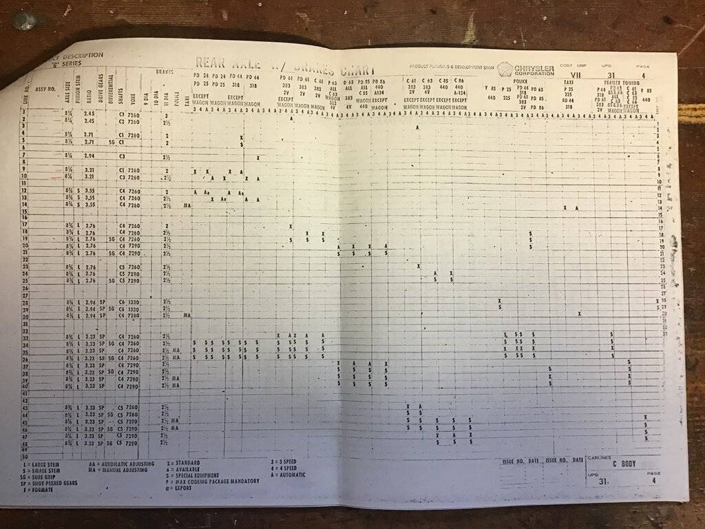

thanks to @Big_John we have a partial answer. (This is from the file you gave me at Carlisle.)
Shown is a spreadsheet grid of available axle assembly combinations for 71 C bodies. Column headers show applications for wagon, non wagon, P,D,C applications; police, taxi and trailer towing sub broken down by engine combinations.
So this tells you what the various assemblies the factory planned for production. What it does not tell us is the assembly number.
With some decent research of broadcast sheets, one could reverse engineer the coding and complete the grid.
On point, this shows us what assemblies the factory accounted for in 71 C body police cars with a 440. It just doesn’t give us the actual assembly number.
This is one more reason to find and save as much factory info as possible. Every broadcast sheet helps fill in this grid. Every file and every piece of paper helps answer a question at some point.

Glad to see that info being used!
