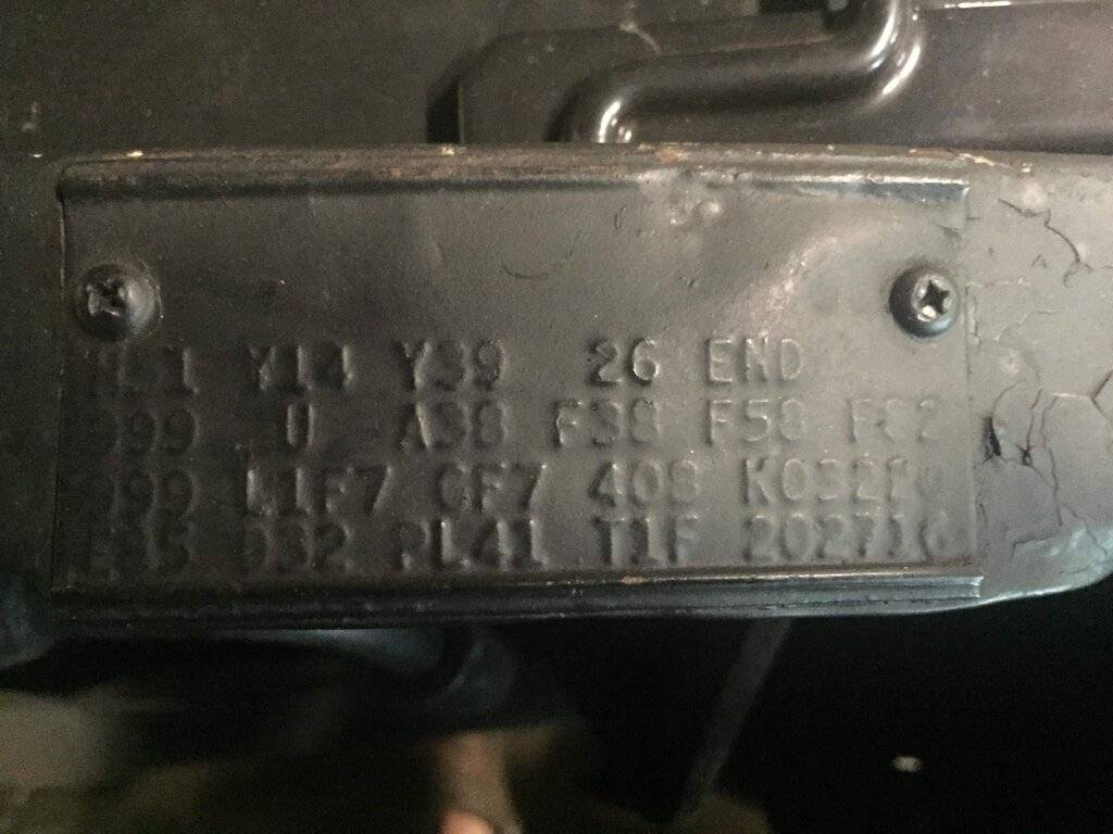

Robio, you've definitely picked up an unusual car. Its configuration raises a number of questions. Not having seen the entire VIN, and just looking at the photos you provided including the fender tags, I see the following:
1. E85 = 440 motor
2. A38 = police pkg.
3. F36 & F37 = possible right & left 5" spotlights
(F33 & F35 were 6" spots)
4. F38 = reinforced roof for light bar
5. F58 = right rear reinforced weld
6. Y39 = special order
7. EW1 = white exterior color
8. V01 = monotone paint
9. Correct police aux. map light
10. Correct interior trim
Things that are unclear:
1. Whether speedometer is certified (although quite blurry, it appears to exceed 120 mph).
2. Whether the floor is carpeted or industrial rubber.
3. Presence of mounting holes on driver's side roof for red light, but unable to determine if matching holes are on passenger side. You claim two red lights were removed.
4. You state you observed "serious exhaust hangars and brackets." This could be consistent with the F58 "reinforced RR weld."

Taking all of the above into consideration, notwithstanding some of the inconsistent items, I'd have to say you've stumbled onto a bona fide CHP unit. Perhaps the 2-door cars were used by various state agencies for special purposes, such as pursuit or senior management (and not necessarily prisoner transport or confinement). Well done, and good luck!

Engine call outs on the bottom of the fenders were standard on all '71 Furys with a 360 or larger engine.
A38 package would include a certified speedo (140mph in the case of Plymouths & Dodges) & the HD rubber flooring.

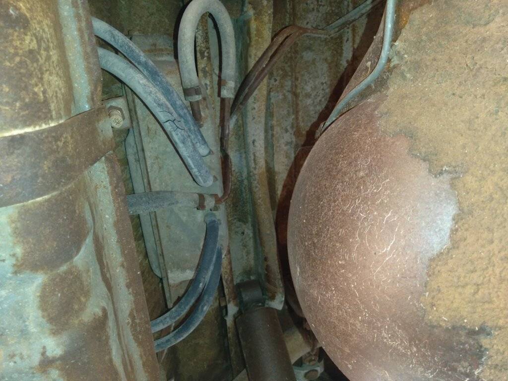

There is one thing I need to do before I put the tank back in..
Here is a photo of the vent lines. It was a little shock at first, I never worked with one of these tanks with so many vents.
I know that no one will see them, but I want to do it right. Can I buy these stock clamps and a crimping tool still? I havent started the hunt yet. I dont want to just throw in a bunch of hose clamps
I think they go by a variety of names. Not sure but I think the official term is Oetiker Pinch on Hose Clamps. They should still be available from many sources.
