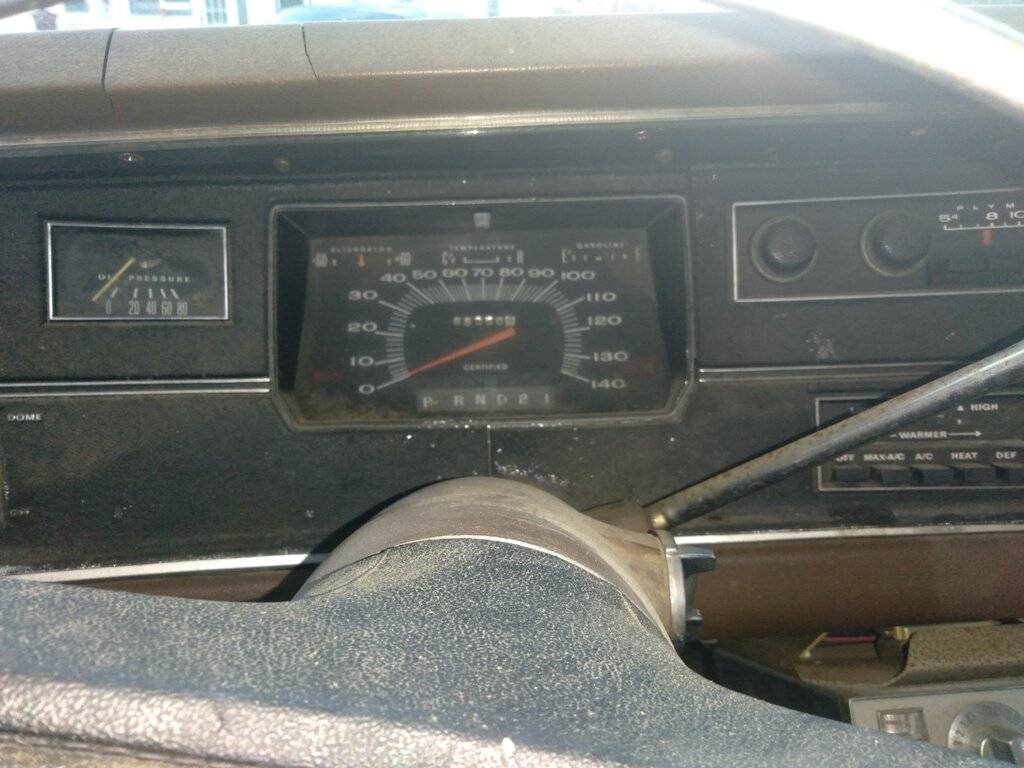

140 speedo and oil pressure gauge.

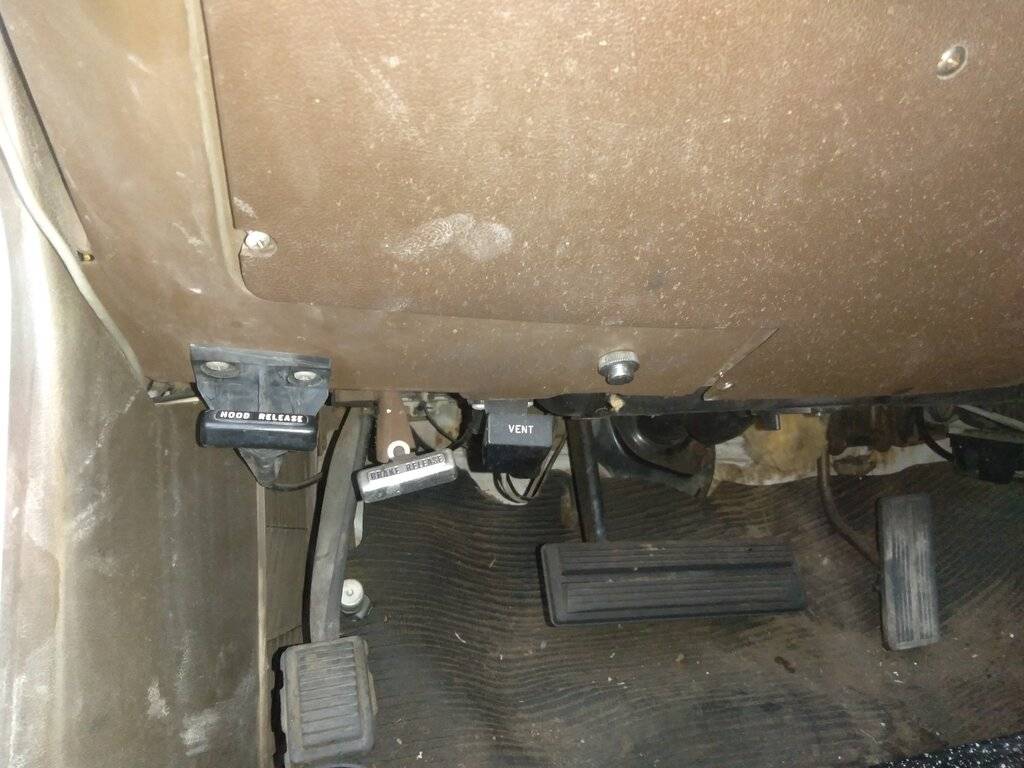

Trunk release button.

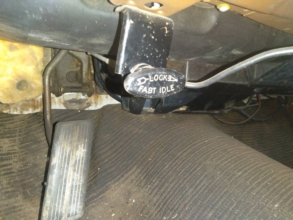

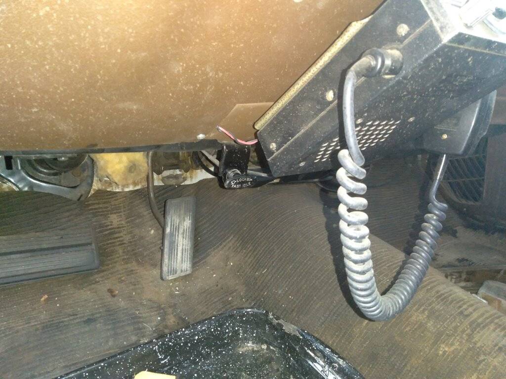

Fast idle throttle handle is there. I didnt see it before, it is kinda hidden behind the cb..

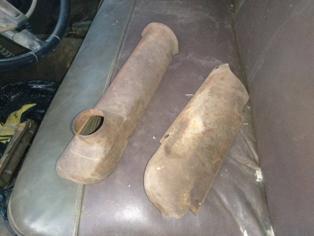

And the heat risers. Found them between grill and radiator when I was cleaning out weeds and mouse nests a few weeks.ago.

That is the heat stove, not the heat riser. Heat riser is the butterfly valve at the end of the passenger side manifold exit. Heat stove hooks to the driver side manifold and a flex tube runs to the air cleaner to warm the intake air and prevent carb icing on low temp start ups.

Ahhhh, sorry about the wrong name. Knew what they were, just never heard the stove thing before.
There is a broken bolt in the manifold. Like you say, at.least they didnt throw them in the scrap pile when they wouldnt go back on.

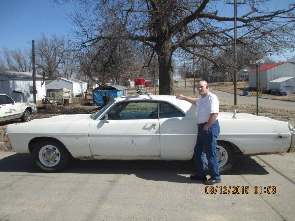

I think I figured out how to post a few pictures on here-I hope. To get you excited about getting to work on yours. These won't be in any order, I just snapped a few pictures as I went. This is the old guy that sent my car to the junk yard. I let him drive it after about 29 years.

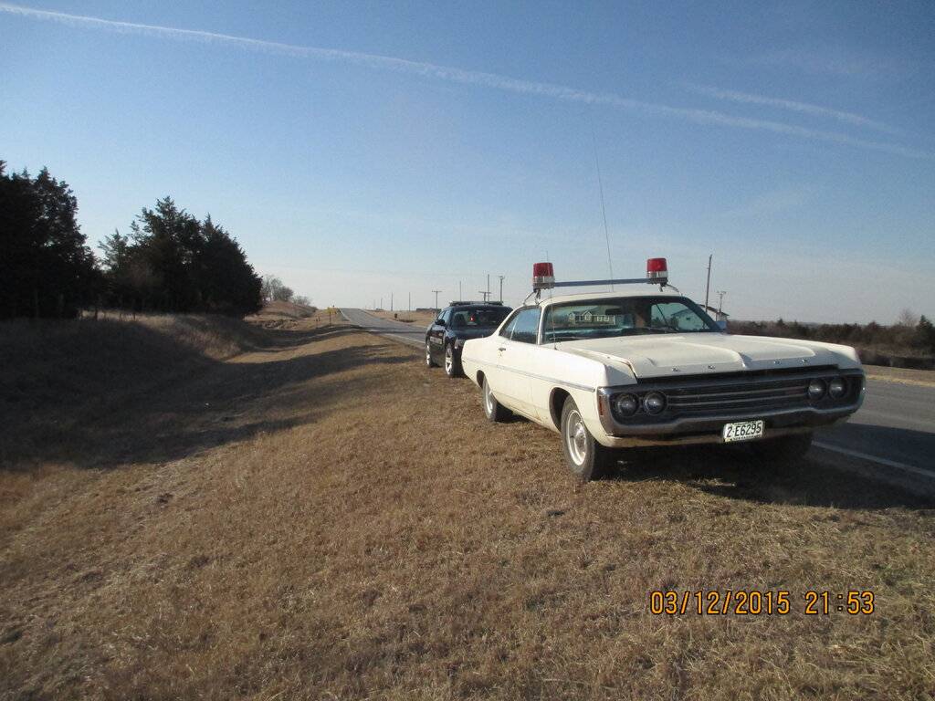

I stopped one day when I seen these two patrolmen standing along side the road. They told me they were glad that I stopped. We visited for a good half hour. They took some pictures, had me turn my red lights on, it was pretty cool!
