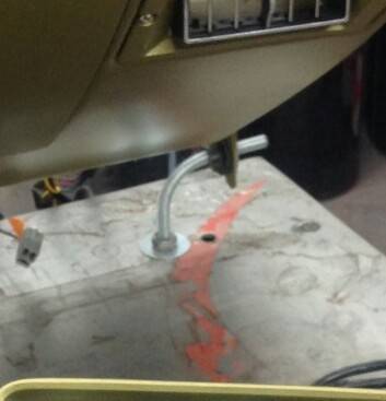

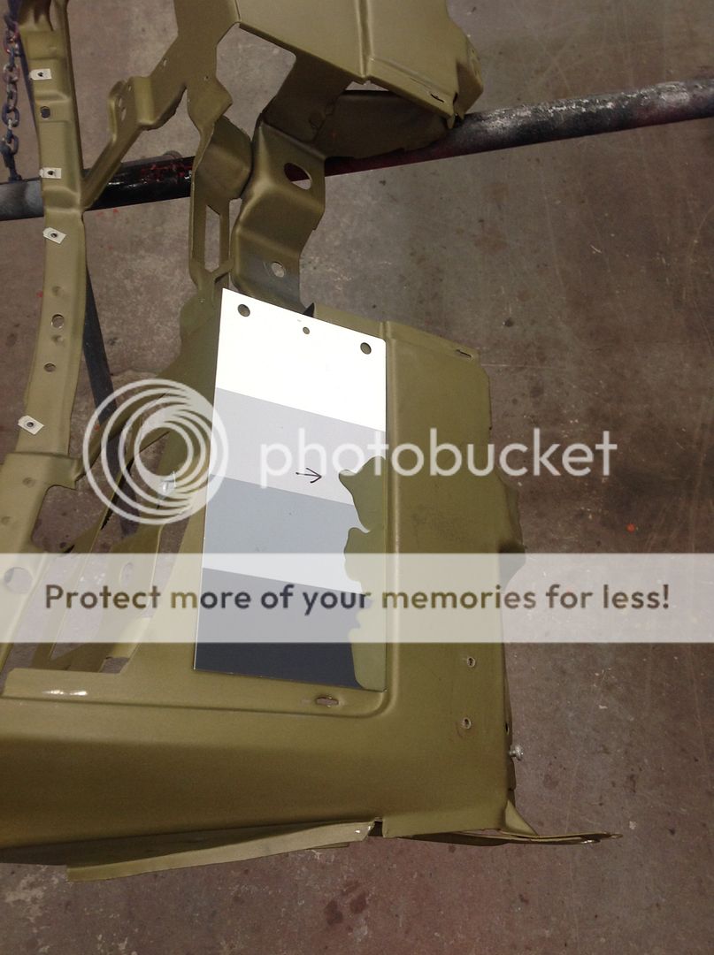

You mean on GTs or All Cs? Mine is correct for 71 Polara/ Monaco. Which is why I need to be sure. Until today I never saw one located where Critters and Wolfens is
I have a number of 71 300s and a 71 Monaco that have the optional hood release, and they look identical in terms of the mounting bracket, but the actual handle is black plastic on the Monaco and chrome on the Chrysler/Imperial models. And they are mounted in the same place on the Monaco, but on Chrysler models, they were mounted a little further under the dash to not interfere with the a/c spot cooler bezel. With Chrysler, running changes were the norm so you might have an early build car that could have had a different setup. I checked my 73 Monaco, and it too has the same bracket as my 71s, but the handle (black plastic again) is oriented vertically instead of horizontally as in the 71s.
Also, the park brake release is normally protruding where the manual choke cable pull knob is located in Derek's GT, so someone moved the brake release on Derek's car.
