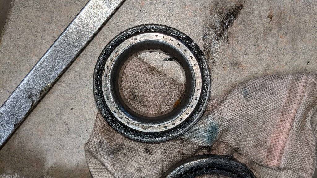

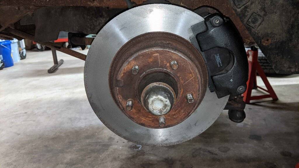

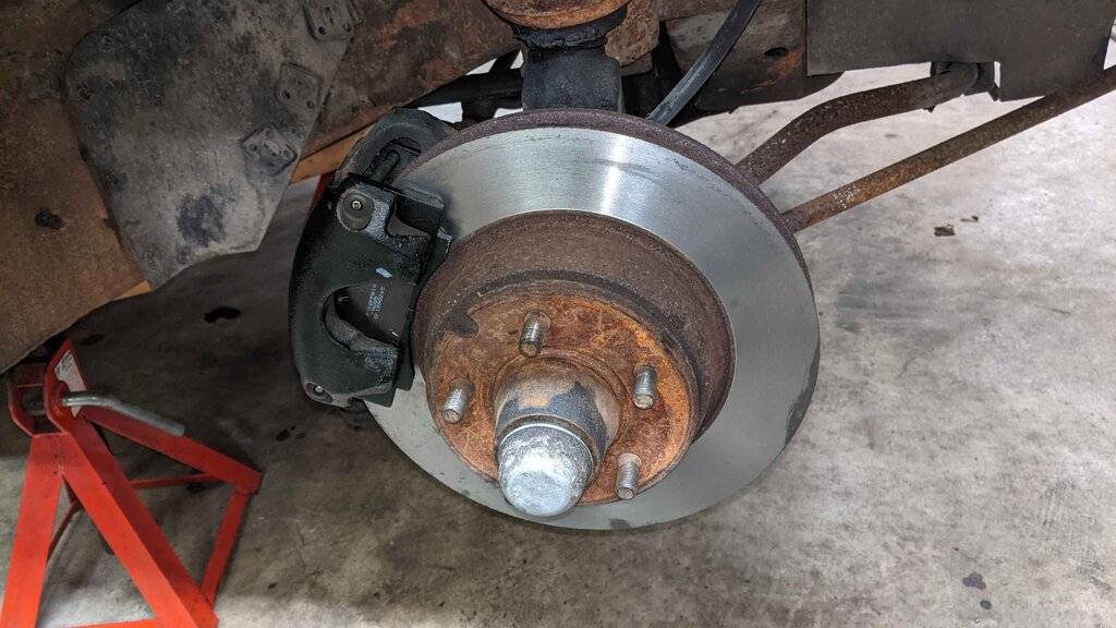

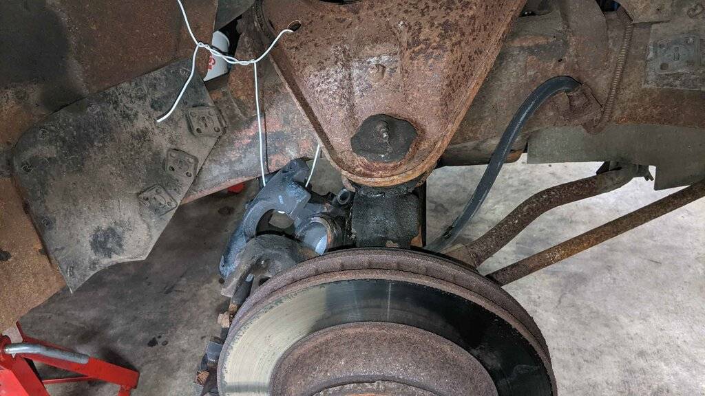

· Brakes: the front brake rotors became warped, which is common for the 1969 through 72 2 – piece rotors. The pedal and steering wheel chatter quickly became intolerable.
· I had the rotors cut for $20 each. Hand greased the bearings.
· All Good now

Cut and installed. Brakes are excellent!

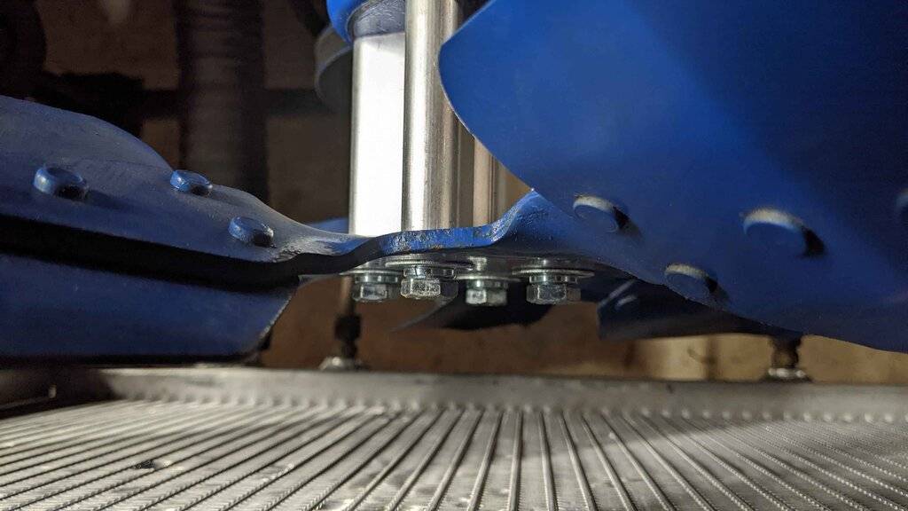

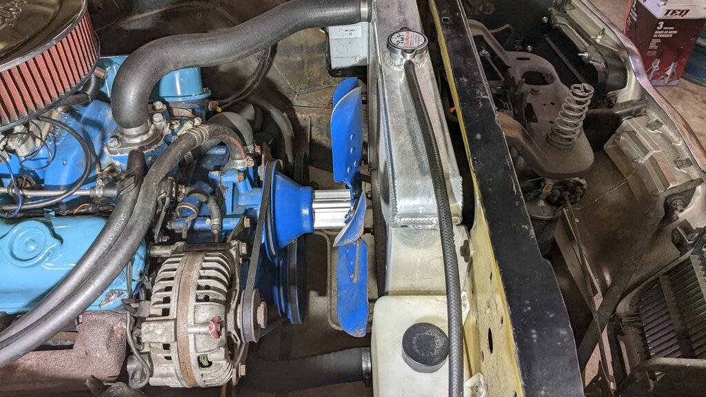

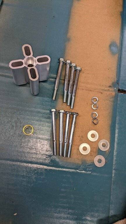

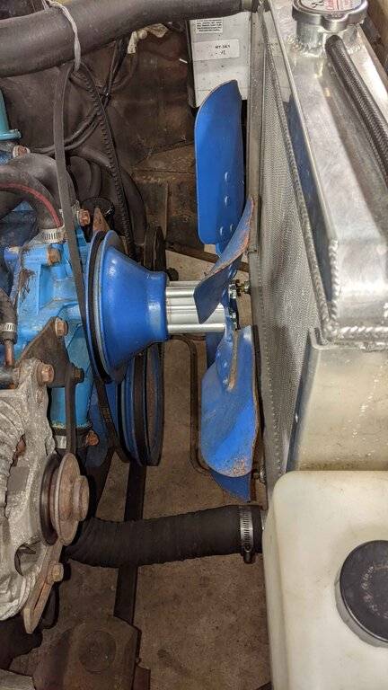

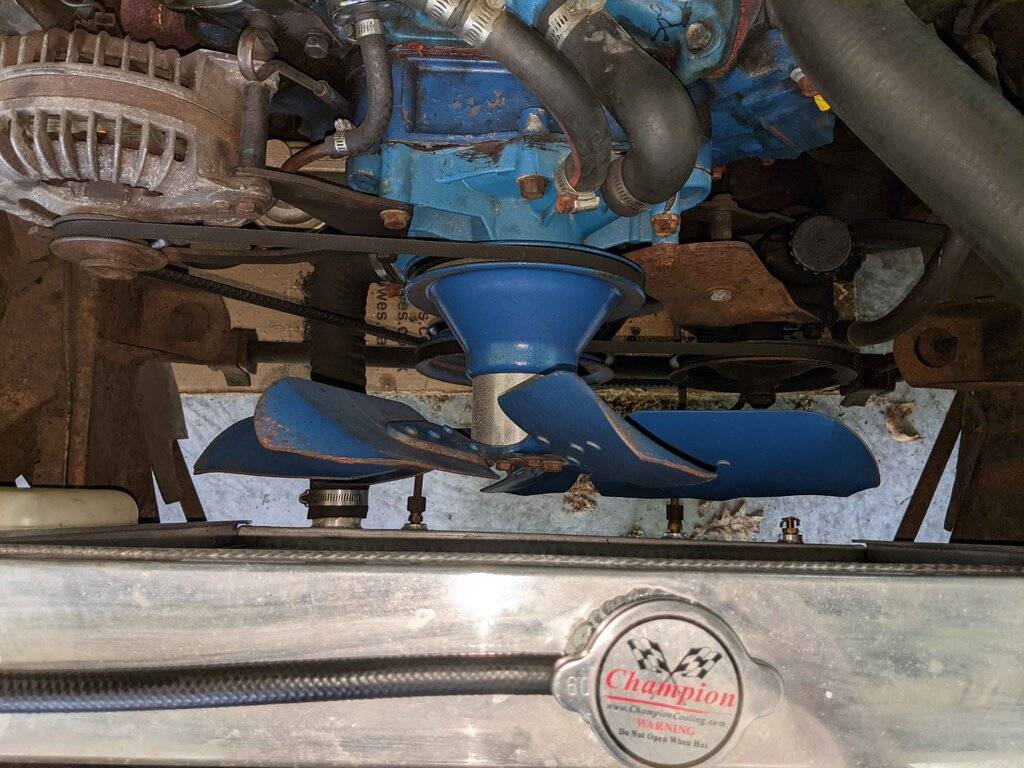

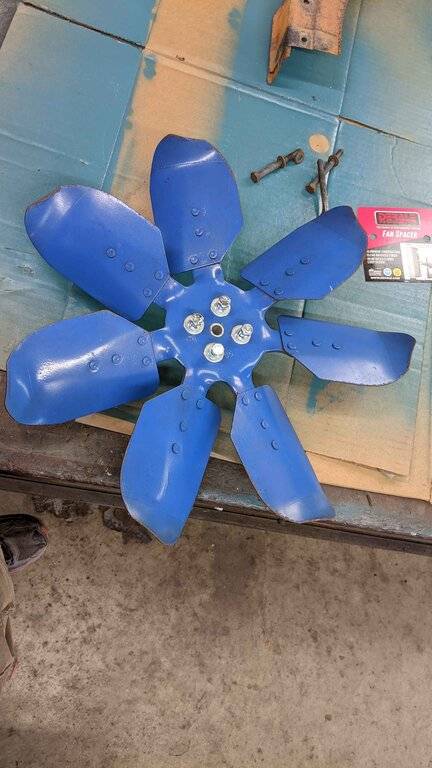

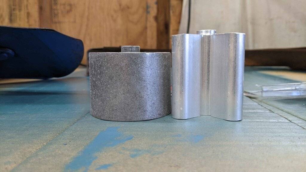

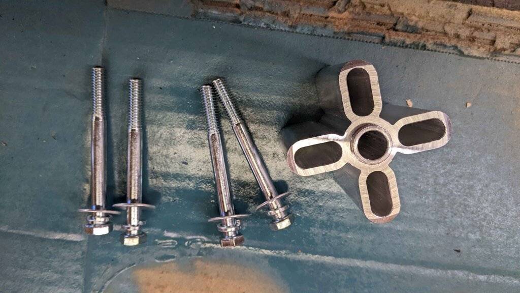

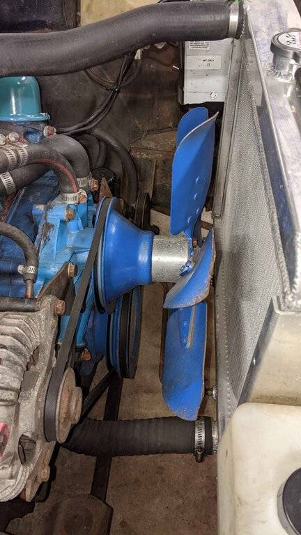

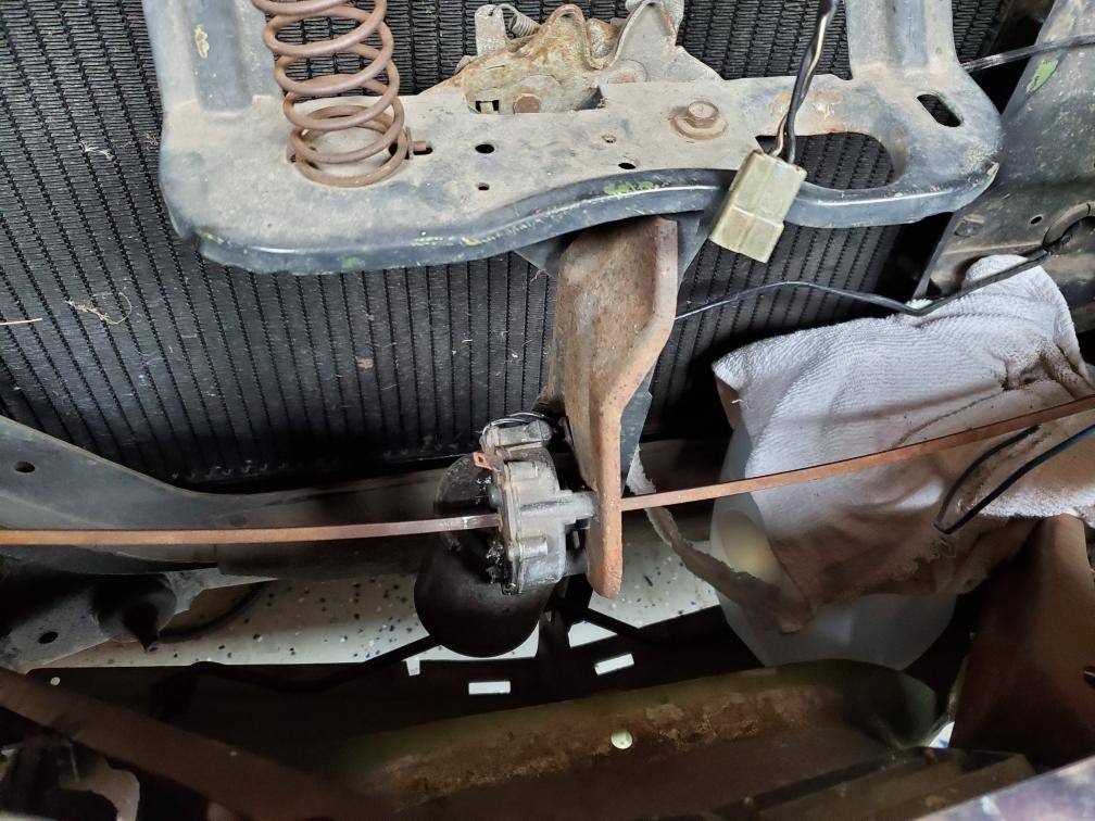

Another small problem that I have encountered is that on extremely hot days, like 90°F during the summer, on take off from a stop light the engine will bog slightly between 40 and 50 mph. I think the problem is that the fan was too far away from the radiator to draw sufficient air through the radiator when the car is at idle. I used a 2 ½ inch spacer kit to move the fan .5 inch closer to the radiator. Hope this will cure the problem. If not, I have a 22 inch radiator shroud kit from a 1967 to 68 Chrysler C body. My problem with installing that is that the radiator that I bought, like the radiator original to the car, has no shroud mounts.
The problem happens rarely and only on extremely hot days after the engine has effectively had a heat soak.
Before
KIT
Old vs new

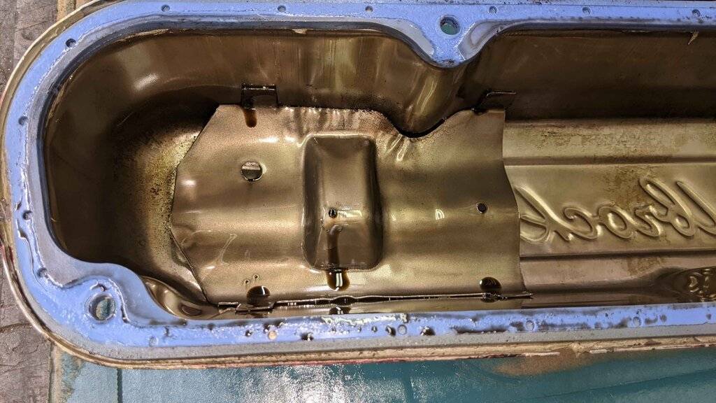

72 Fury 360 Oil Usage
It has a problem with using oil. It uses between a pint and a quart per tank full.

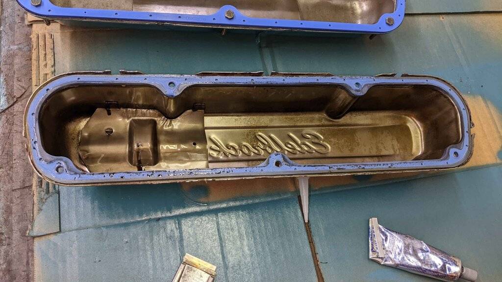

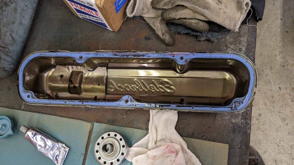

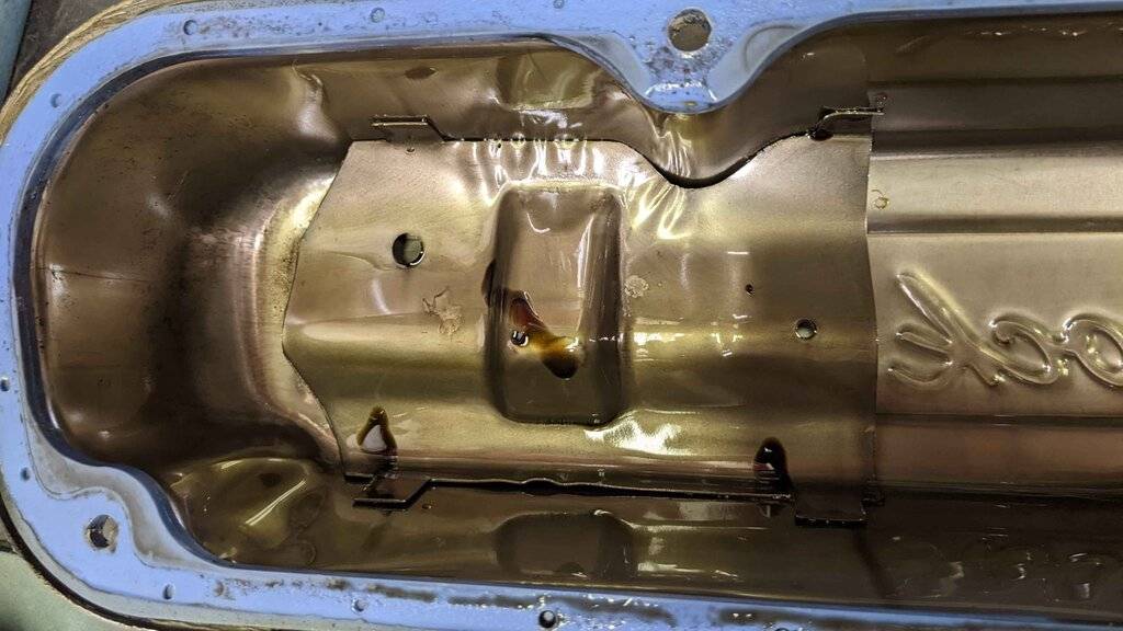

It has no leaks or blue smoke at the exhaust and the car runs fine. @CBODY67 Willis advised that the PCV system in my Edelbrock valve covers may be drawing oil from the oil cloud under the valve covers.
· per Willis, aftermarket chrome valve covers with short baffling like Edelbrock can allow the PCV system to suck up oil. This may be the reason that I burn nearly 1 quart of oil per gas tank full, although I see no smoke at the tailpipes and very little drip underneath. It’s worth a shot to clean and install OEM valve covers just to see if I can stop the oil consumption.
· ALSO, IN THE STUPID DESIGN CATEGORY: The Edelbrock valve covers have no oil filler cap and it takes forever to add 1 quart of oil. You'll see why.

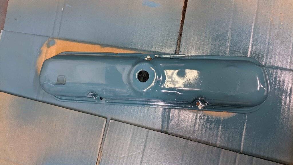

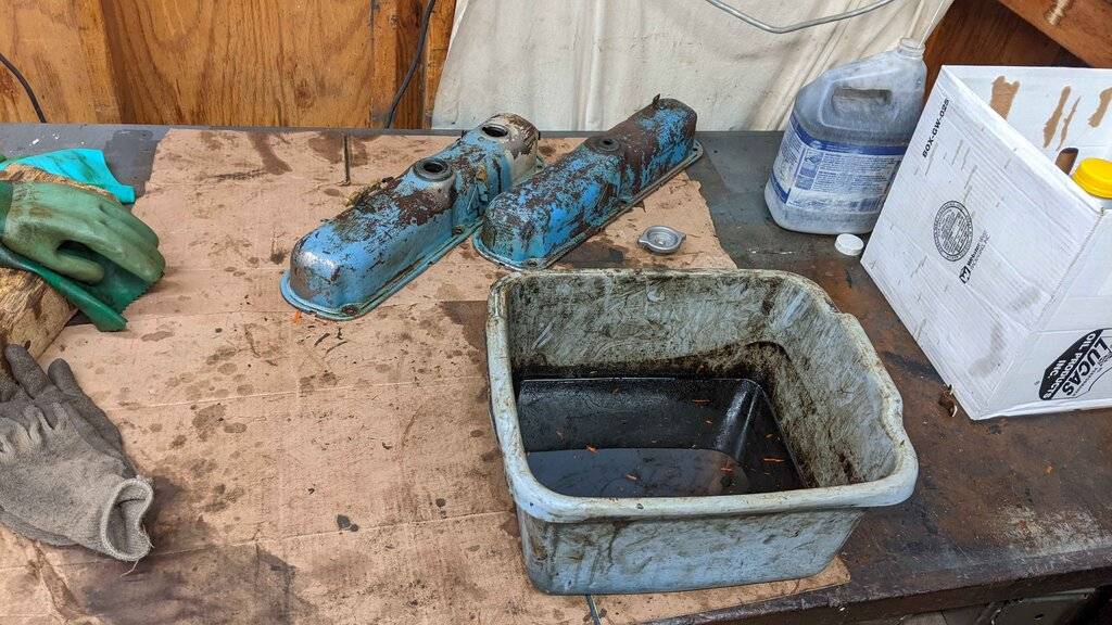

OEM Valve Covers, on hand for 20 years., siting in garage loft, waiting

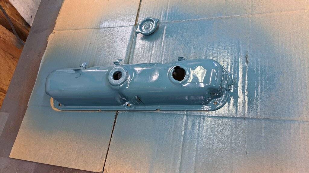

· RSVC: clean in tub of degreaser, metal scrapers, Brillo pads, rags. Cleaned outside and inside, but left oil cap in tub overnight
· Valve Cover Gaskets, Moroso 93050: eBay order $52.44 includes tax and free ship
· Oil Cap: clean, Brillo pad and rags
· Clean exterior and mtg surface: WW, Roloc discs, die grinder, 100 grit sp, CRC brake cleaner, rags
· VHT SP126 Early Chrysler Blue: 3 coats

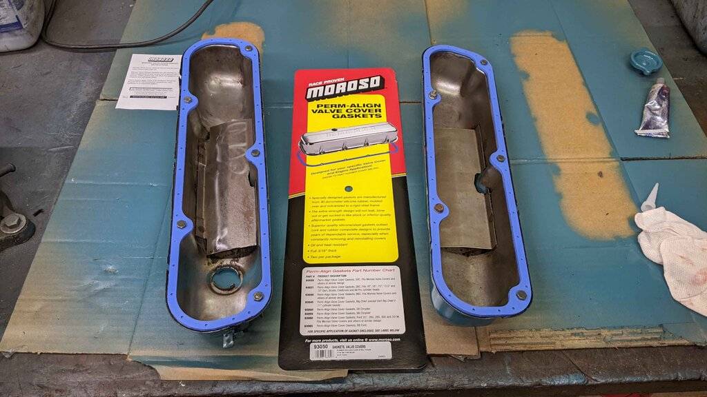

Moroso 93050 Valve Cover Gaskets
· Coat VC mtg surfaces with Permatex Black RTV. Gaskets on mtg surfaces. 10 bolts to keep gaskets aligned while RTV hardens

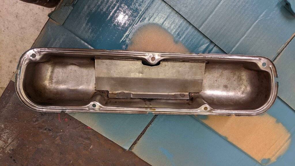

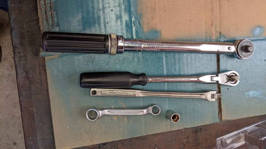

80"lbs torque is double factory spec. Used triangular torque spreaders to prevent denting at valve cover bolt holes

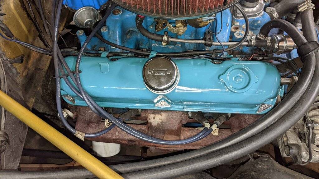

OEM Valve Covers with Moroso 93050, Install

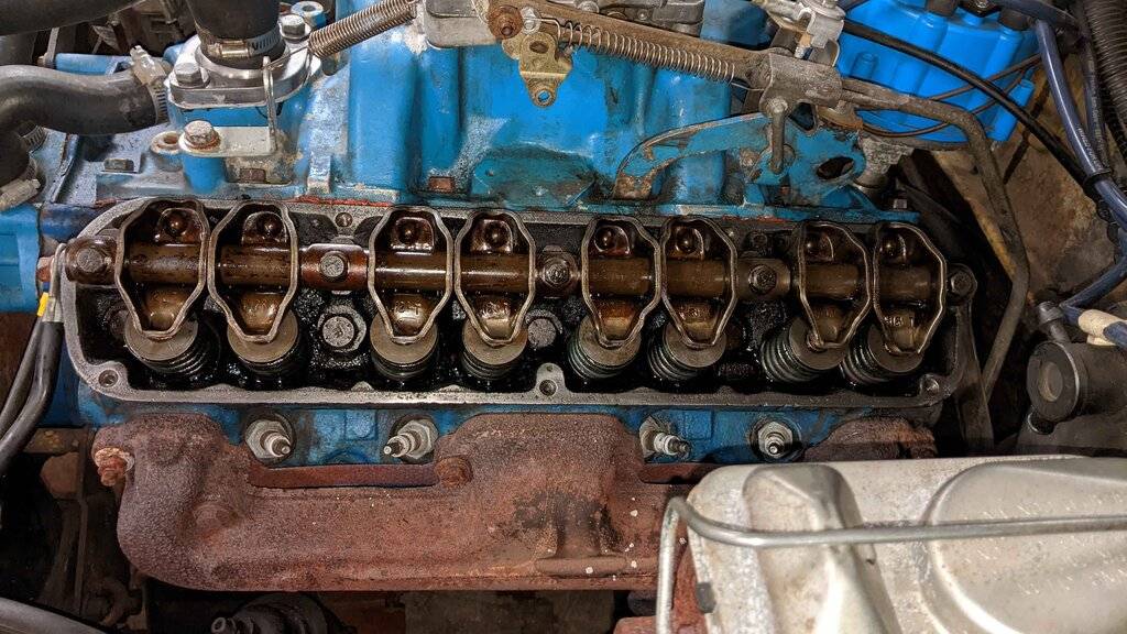

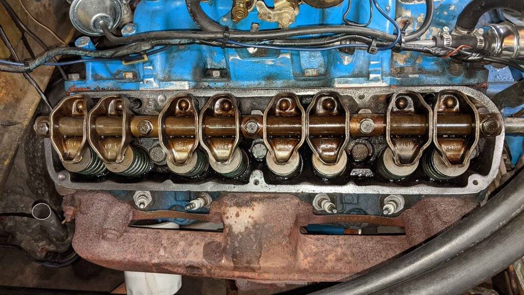

· RS Edelbrock valve cover, breather side, remove: remove spark plug wires, zip tie wires and distributor vacuum hose to fuel line, move heater hoses out of bracket and bend bracket towards the front of the car. 5 bolts: 7/16 short socket, 10 inch extension, 3/8 air ratchet. Short baffle
OEM Baffle, same both sides
· Valve cover mounting surface at heads: clean with die grinder, discs, 100 grit sandpaper, 240 grit sandpaper, brake cleaner in the bolt holes, Q-tips in the bolt holes, brake cleaner across the surface, rags

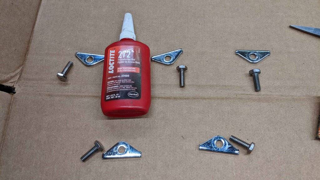

· Valve cover install: valve cover bolts are 3/4 inch length thread. Clean on wire wheel. Coat with Loctite 272 red thread lock. Install with triangular torque distributors. 7/16 inch short socket, 10 inch extension, ¼ stub ratchet. Torque: 80 inch pounds in accordance with Moroso directions, 3/8 torque wrench and 3/8-1/4 adapter.
· Reinstall spark plug wires, wires and distribution vacuum hose in clips at intake side of right side valve cover, heater hose bracket in original position and hoses in bracket.
· Breather: used ¾ inch ID heater hose, three-quarter inch length, on the bottom of the breather to widen it enough to fit the OEM valve cover grommet. Sil-Glyde on the grommet. Push breather into position.

Evil PCV oil sucker

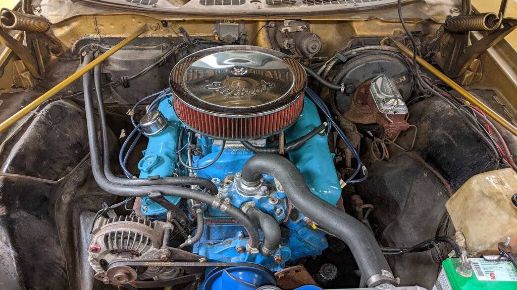

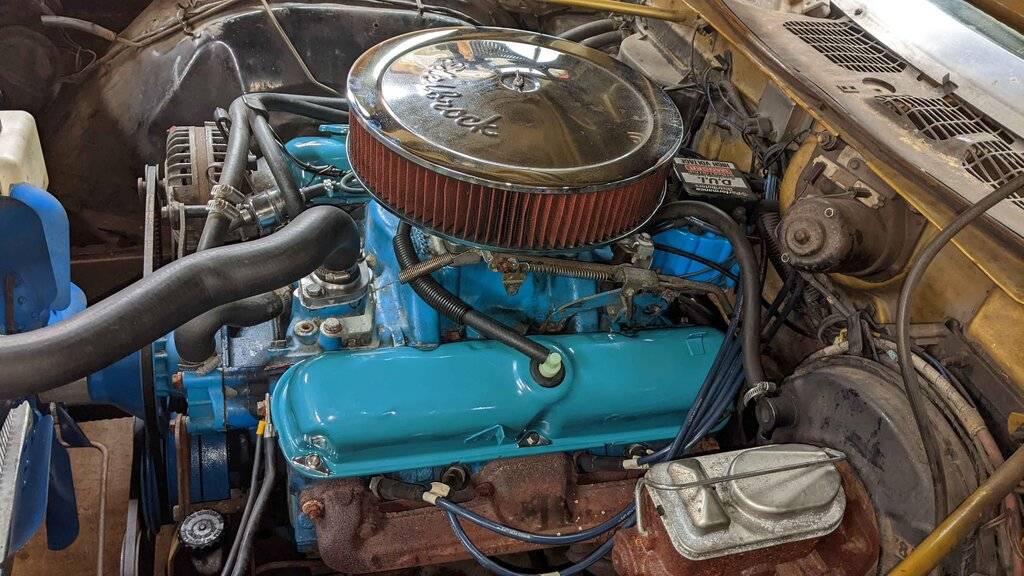

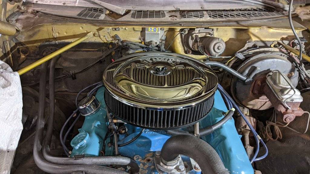

· Air cleaner: clean top of Edelbrock air cleaner with Windex and rags. Install.
Hope this helps! Difference between engine rebuild or paint job on engine.

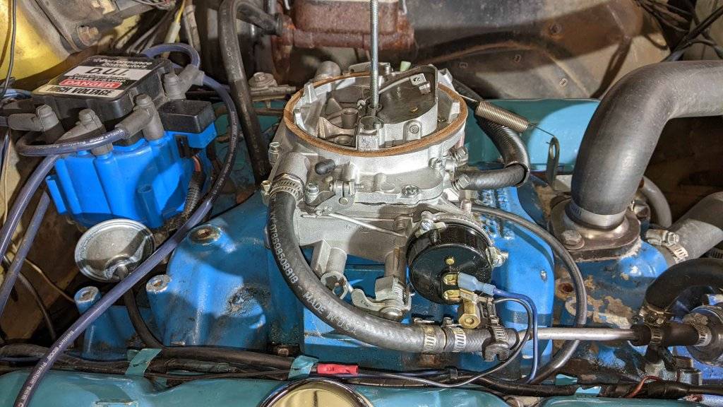

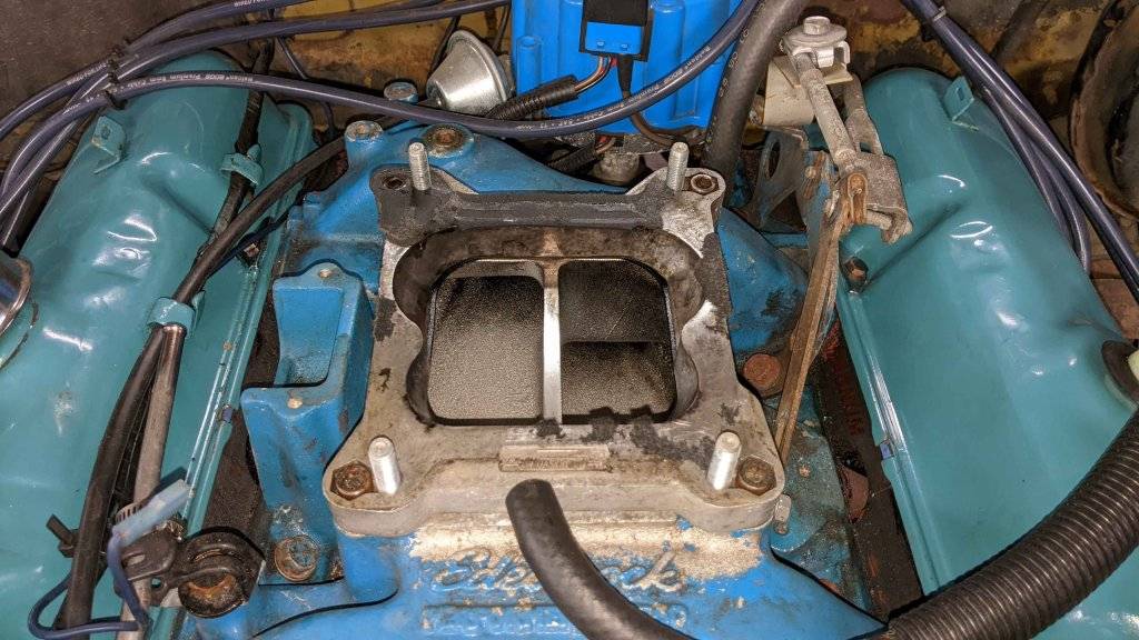

CARBURETOR SWAP

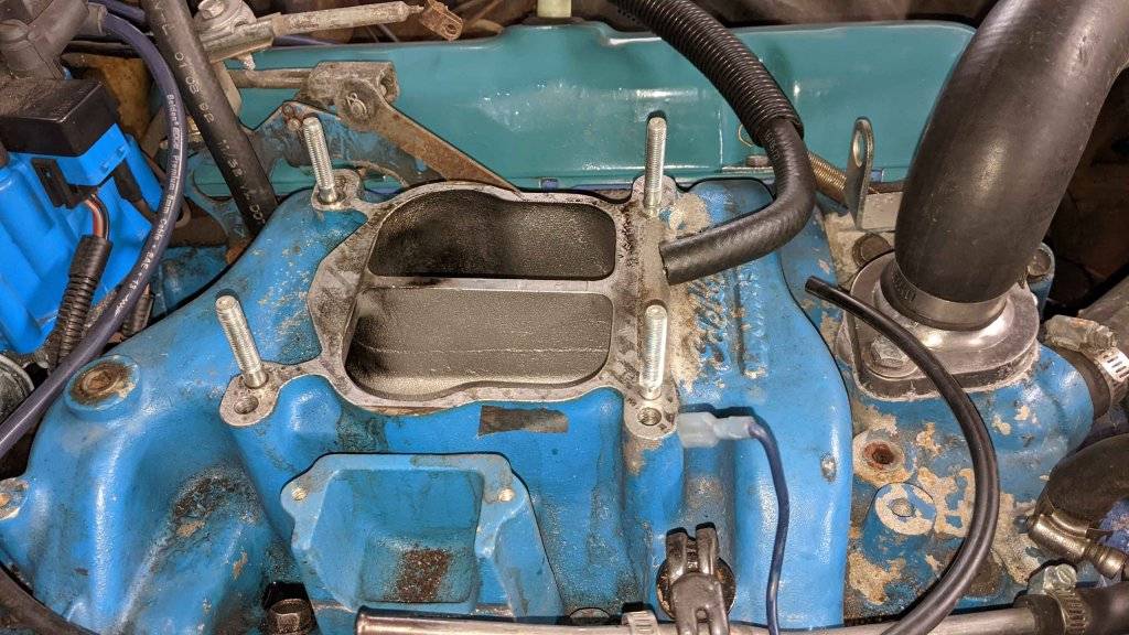

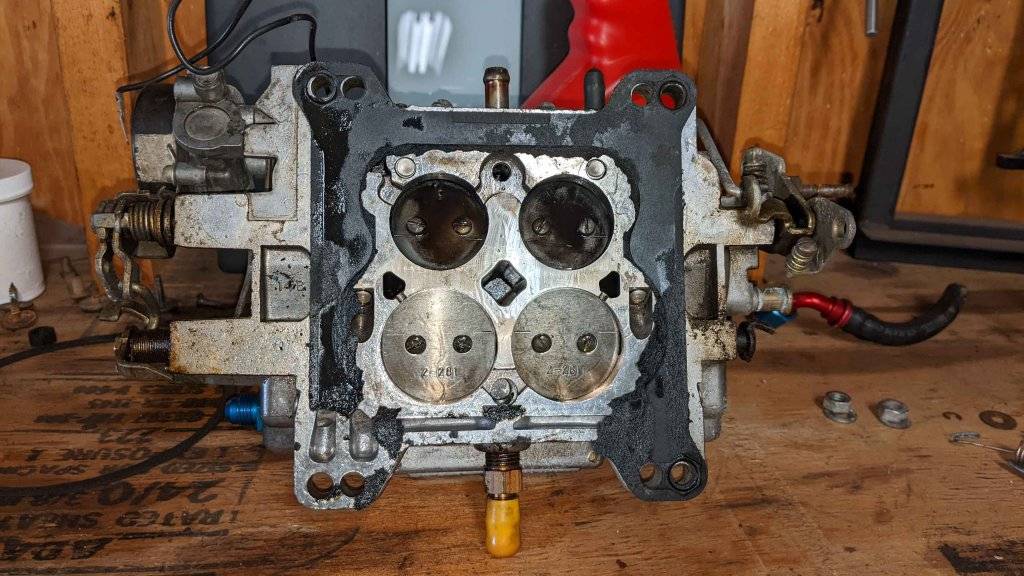

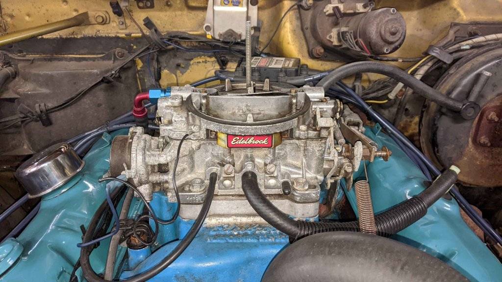

Edelbrock 1406 removed because car running extremely rich. Settings: idle screws 1.0 turns out, max vacuum. Also choke valve bolt missing. Looks like PO bent choke valve plate a little. See right side of picture.
OIL CHANGE: oil turns black after 1 tank of gas

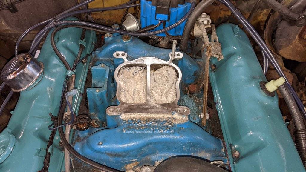

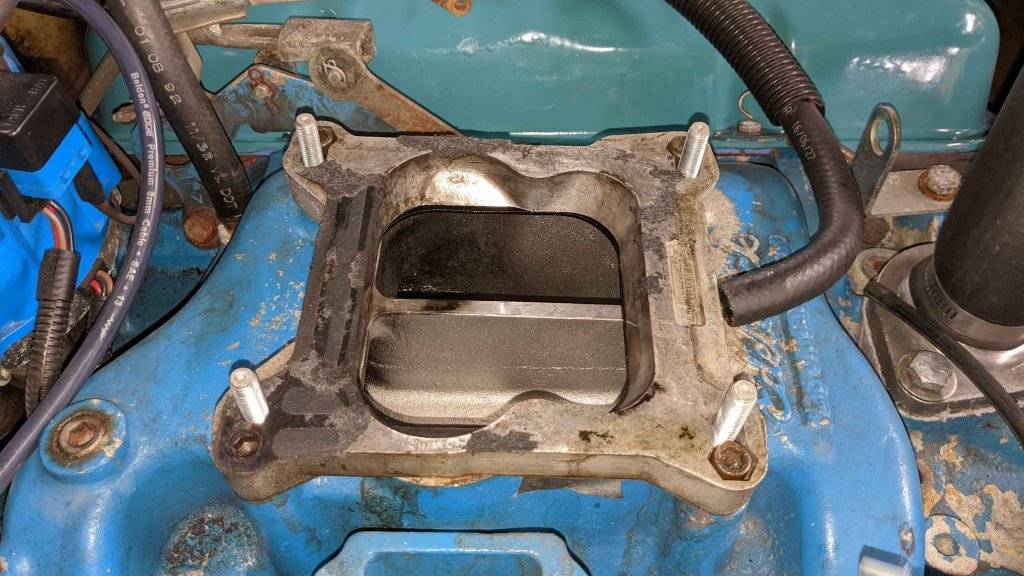

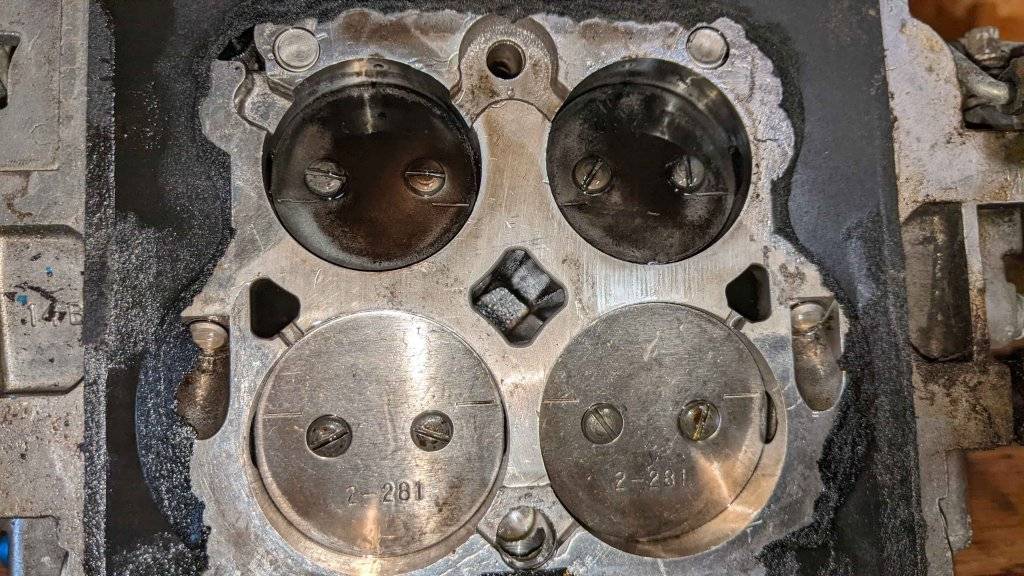

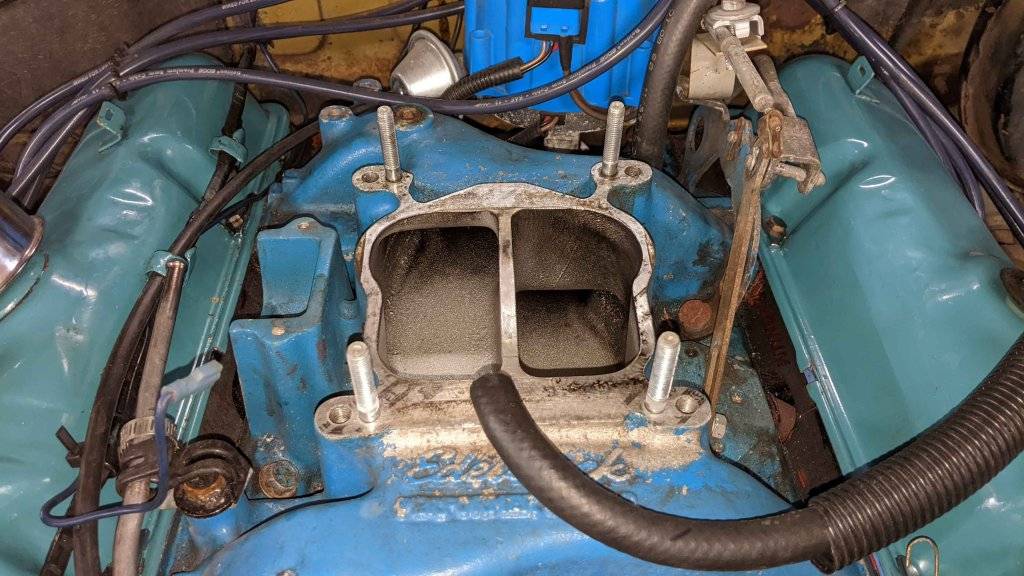

Underside 1406: primaries are culprit
Edelbrock 1” open spacer: remove and recycle. It was not helping vacuum signal on dual plane intake. That hurts torque, which 72 Fury definitely needs.
Edelbrock SB intake, spreadbore with no EGR. Unfortunately out of production.
Left side looks worse then right side
I've had problems with a new 14 series Edelbrock 750 cfm manual choke carb running rich, so it may be something inherent to the design.

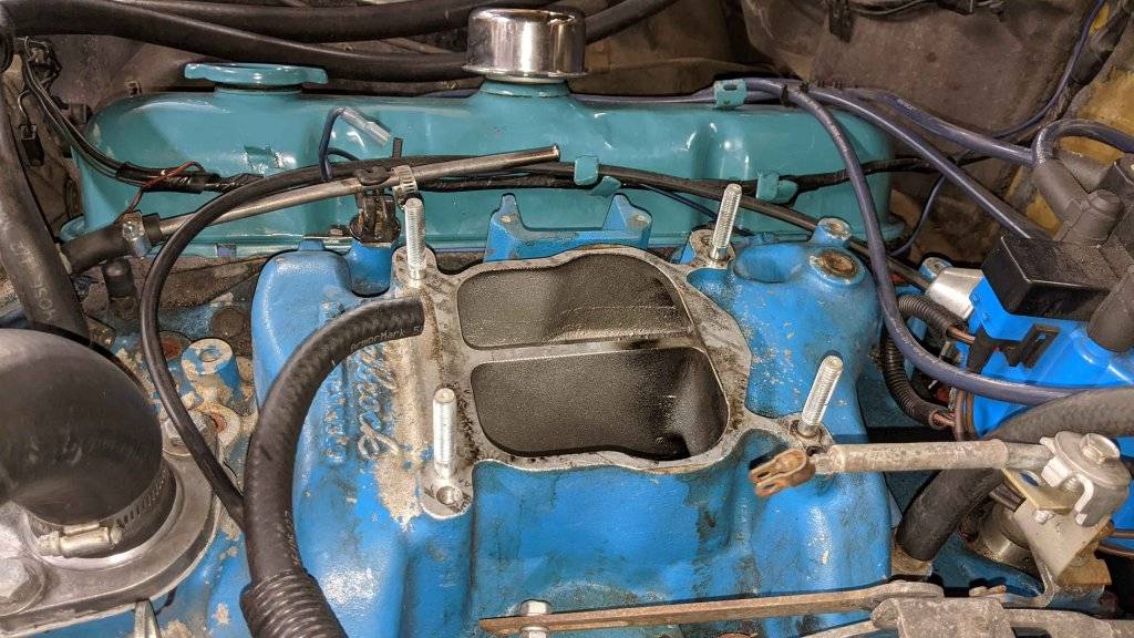

Intake mounting surface: clean with die grinder, scuff discs, and rags.

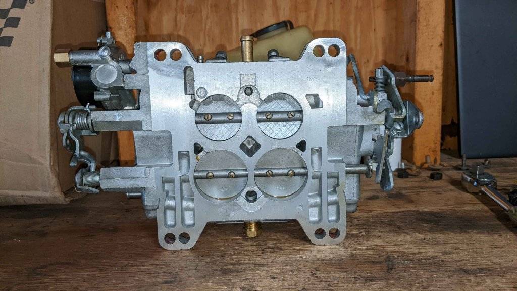

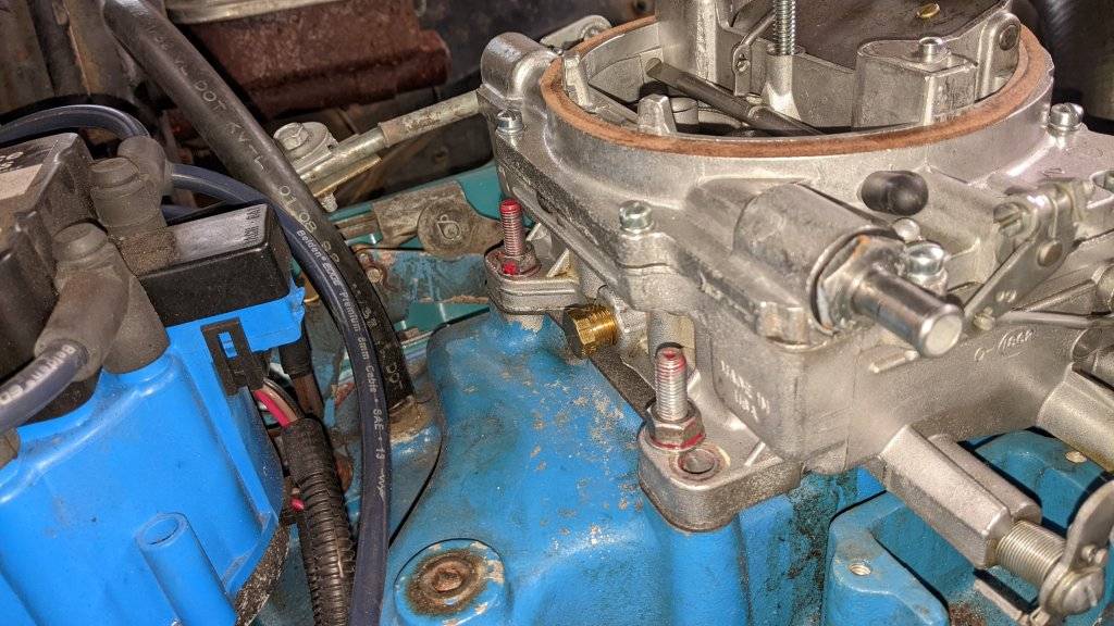

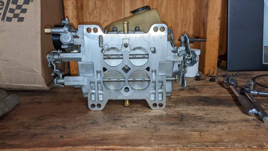

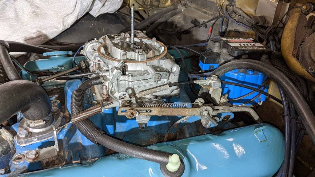

Carter AFB 625 CFM 9625SA. Light cleaning on bottom of 9625SA.
Guaranteed Carburetors, refurbished, all rebuilders over 20 years experience. $258.99 + $29.00 ship ordered from eBay, expected 12/21. Originally installed on Monaco. Removed to test 72 Fury and see if rebuilt carb would help with black oil 1 tankful after oil change
Test fit: throttle valves don’t hit. Not surprising. Small spreadbore carb on spreadbore aluminum intake

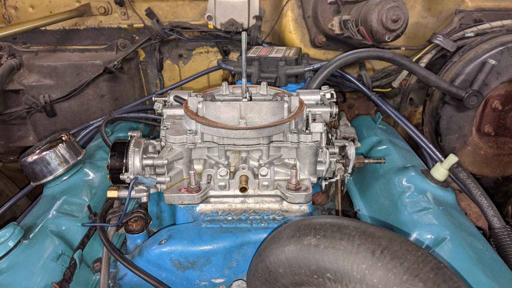

(2021-12-21 Drill 5/16” hole in throttle linkage, drilled with left hand, held linkage with right hand, vise-grip, cloth in jaws. Sandpaper, install Chrysler accelerator cable/KD linkage adapter, ½ & 7/16 wrenches)
Install carb and square gasket, red thread lock on studs, vise grips. Red thread lock on nuts 55-100”lbs, ½ ls, 10 ext, 1/4 R & Torque wrench
Rear PCV plugged by rebuilder
Accelerator cable bracket: bend down slightly, so cable end reached adapter with throttle valves closed.
Kickdown linkage, attach to adapter and adjust such that trans lever all the way back when carb at WOT.
Fuel Hose Fitting: 3/8 hose, s/b 5/16. (Thread is not 3/8 inverted flare or 3/8 MNPT) eBay: order brass 3/8 – 5/16 reducer, $7.32 incl tax and free ship from Kennesaw GA. 3/8 fuel hose to reducer. Cut 3 3/8” off fuel line and single flare. Attach hoses from filter and reducer. Tighten clamps on line, ¼ ss, 3 ext, ¼ R
Choke power input: no mods
Choke ground wire: extend to firewall
Monaco Drop base air cleaner fits tightly. Moroso lid. Moroso base crumples fuel hose, so mix and match
Test Drive: performance excellent. Started 1st turn of key. Light to medium acceleration 1-2 shift 20 mph, 2-3 35 mph. Hard acceleration 2-3 50mph. Kickdown is best it’s ever been. Acceleration excellent. Really impressed!
