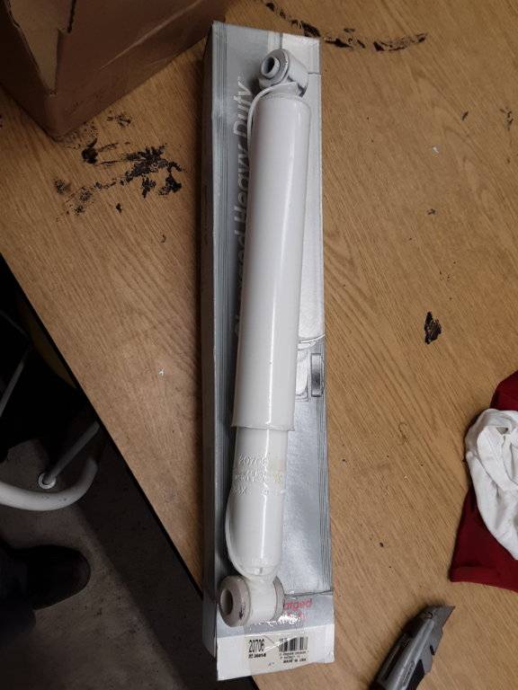

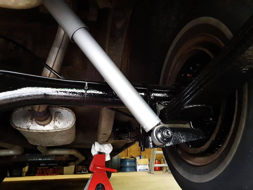

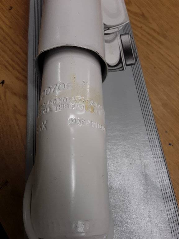

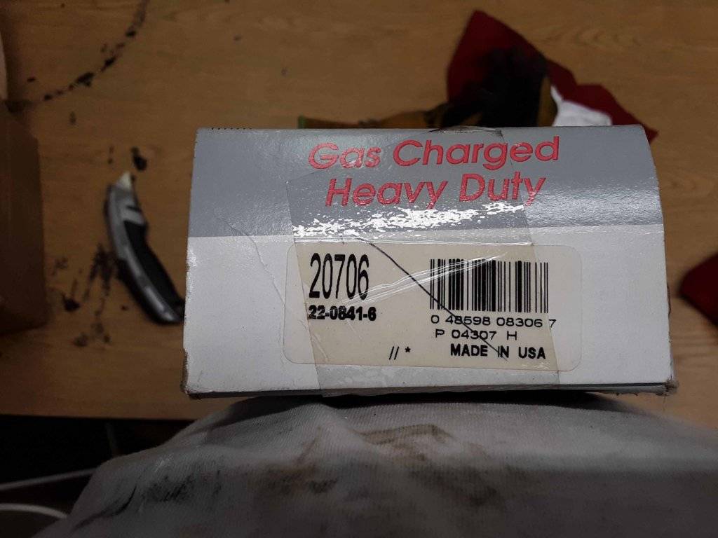

What shocks are on the car now, and in the pictures?

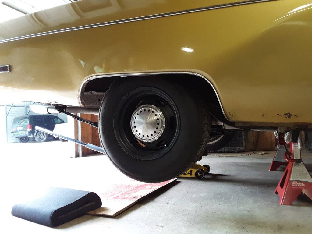

I agree, but too short to install a tire is a different thing.To be fair, I don’t think any of the shocks I’ve put on the rear of my C Bodies have extended to full droop.

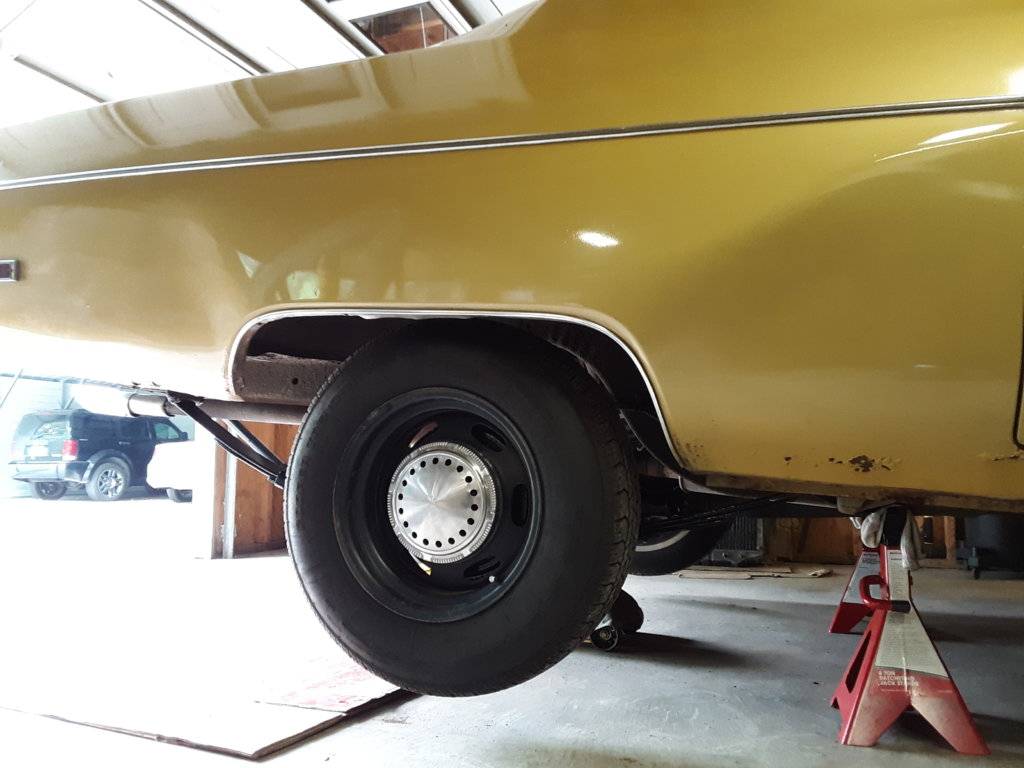

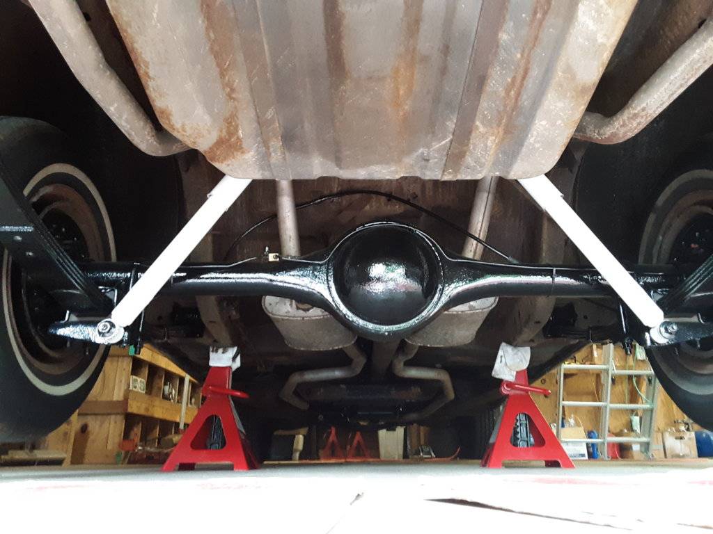

KYB KG5512, 22.6" extended lengthWhat shocks are on the car now, and in the pictures?

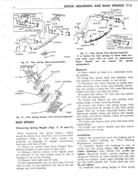

Hi Scott. Spring Travel: with KYB KG 5512, installed rear tire is 5 ½ inches above garage floor. With shock removed, rear tire is 2 ¾ inch above garage floor. Loss of that 2.75 inch of spring drop is what did not allow me to install my tire on the right side.What shocks are on the car now, and in the pictures?
Hi Scott, Isolator: FSM 17-5, below shows it for Plymouth, Chrysler, Imperial. Dodge?Do all '72 cars have the isolator around the leaf pack? That's the shock that works on my '66's, but I don't have anything but axle pad on spring, so the shock mount is higher than yours. Can you cross reference a stock shock number to a KYB part number?
So the KYB 5512 works on your 66 cars?Do all '72 cars have the isolator around the leaf pack? That's the shock that works on my '66's, but I don't have anything but axle pad on spring, so the shock mount is higher than yours. Can you cross reference a stock shock number to a KYB part number?
I'm pretty sure that's what I installed. They work great on the gray car, the Polara 500 still needs new springs, but after that I don't see why they wouldn't work. Your shock mount is lower with those isolators, so I can see why they wouldn't fit.So the KYB 5512 works on your 66 cars?

Hi Scott, definitely a softer ride, but the shock still does it's job. You don't bounce up and down like the spring is unrestrained. Feels like car moves thru more of it's spring travel, because the shock isn't as firm. Floaty or cushioned might be the word. Feels like more of a luxury car shock. KYB is more stiff, like a sports car shock.Kind of sad that people have to turn into detectives to find the correct part for their car, because of inaccurate catalog listings.
Not as firm? More floaty feeling? I'm trying to find a shock that will make it so Laura can actually ride in a car of mine!
Good to know if I need a softer shock.Hi Scott, definitely a softer ride, but the shock still does it's job. You don't bounce up and down like the spring is unrestrained. Feels like car moves thru more of it's spring travel, because the shock isn't as firm. Floaty or cushioned might be the word. Feels like more of a luxury car shock. KYB is more stiff, like a sports car shock.

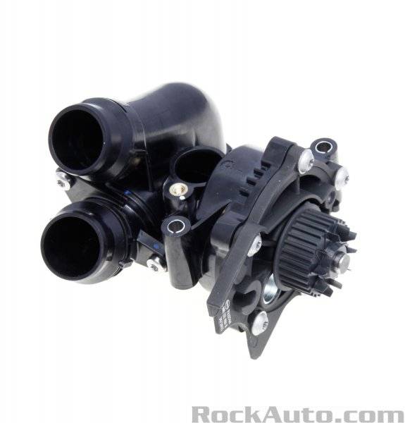

Now at work is a different story, I try to do the job as fast as possible with out any errors that would result in a comeback. I hate having to do things over. I was working on a VW Friday and it was eating my lunch. Come to find out it was my own fault.The thermostat only goes in the housing 1 way, if it goes in wrong the o-ring will leak, imagine that if you do it wrong it doesn't seal. LOL
