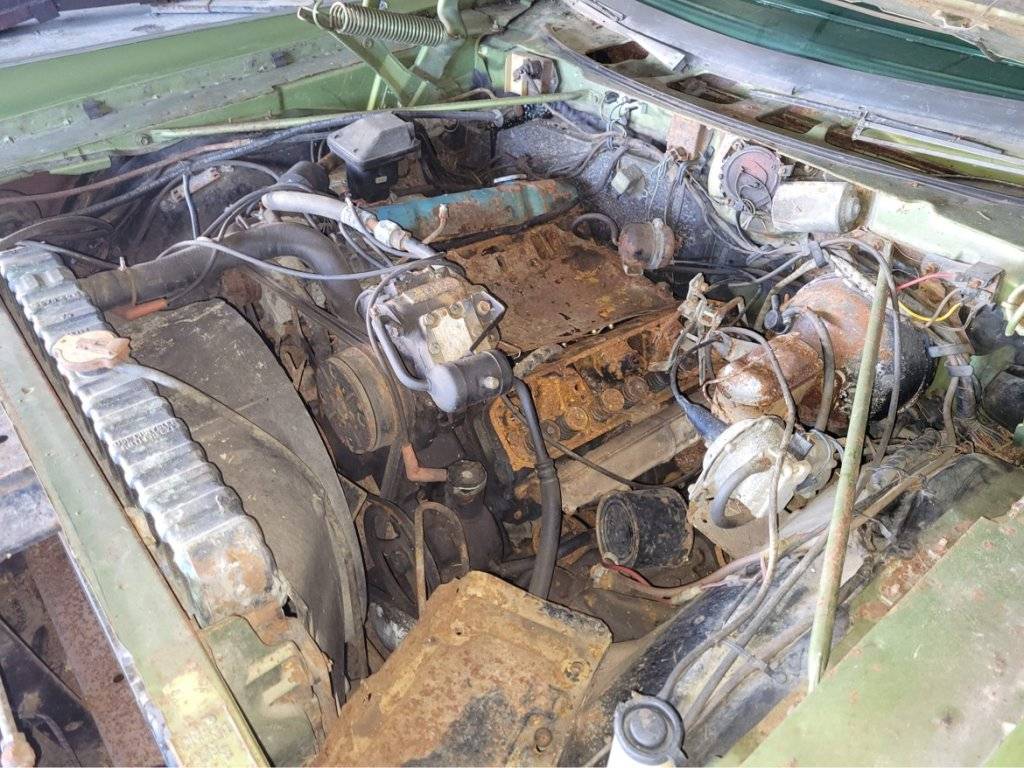

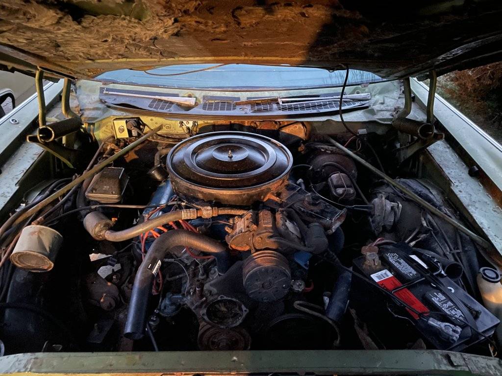

The car will run on ether but I get a huge fireball out of the carb. I have timing set correctly at 12°BTC.
I will be doing a few tests on the engine in the next few weeks. I suspect that the engine may have a damaged or sticking intake valve.

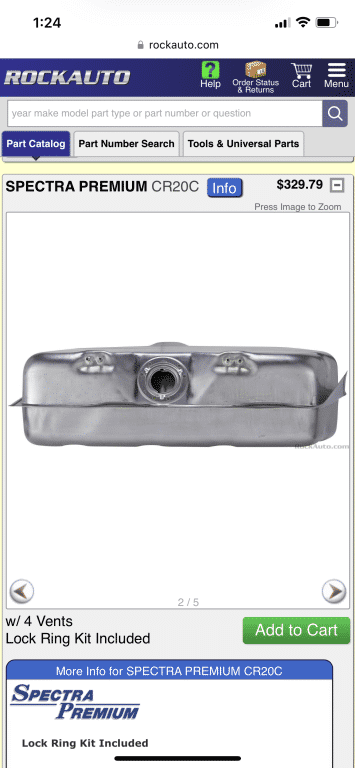

I ordered a new gas tank, straps and a sending unit and will be installing them before trying anything else. I will be reusing the original lock ring for the sending unit.
I will replace the carburetor and get the car running. Unfortunately snow is supposed to be on the ground for the weekend, but I will be ready for warmer days.

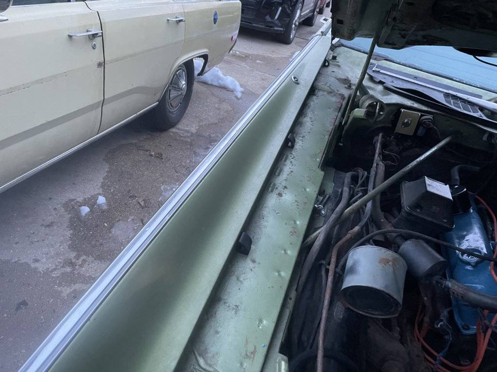

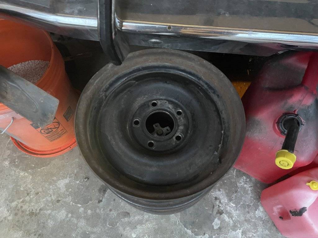

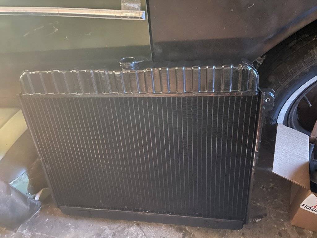

Some work done. I got my new gas tank in and six new hood bumpers in. I also got my radiator back from the local shop and three new wheels to replace the two incorrect wheels and missing spare.
Progress is always rewarding.
Just wondering, is that a 26" radiator or a 28" one? I am just asking because the factory setups seem to usually have thin rods across them for added stiffness I believe with the 72 and 73 models at least as I recall with the 28" versions that were standard with those Imperials. Did you rebuilder just leave them off or did you opt for a little narrower radiator? The workmanship looks good.
It is the factory radiator. The recore was $700. The shop did not put the wire back. I was a little bummed but I was told it is not an issue.

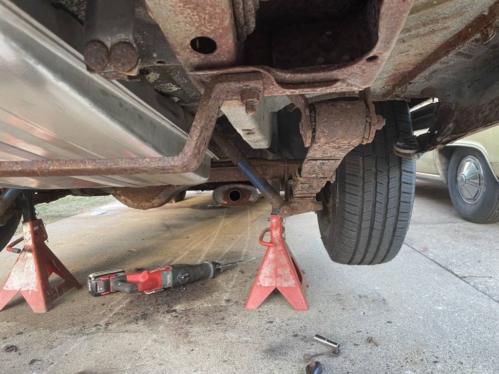

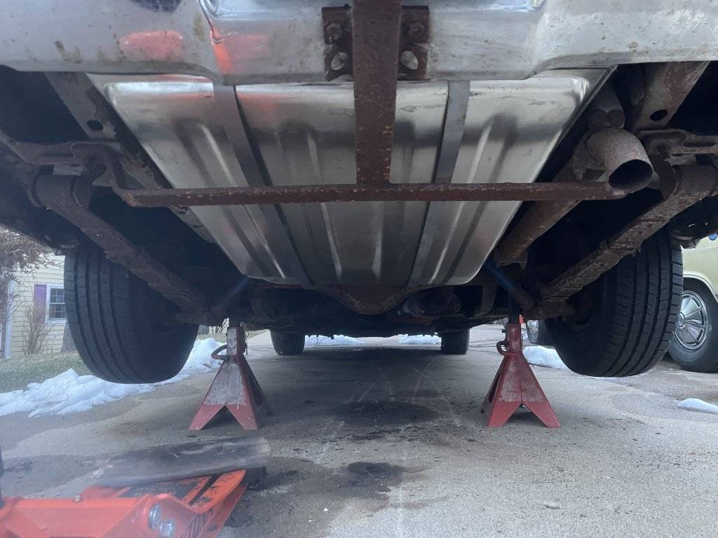

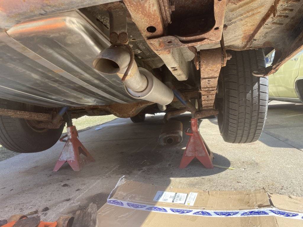

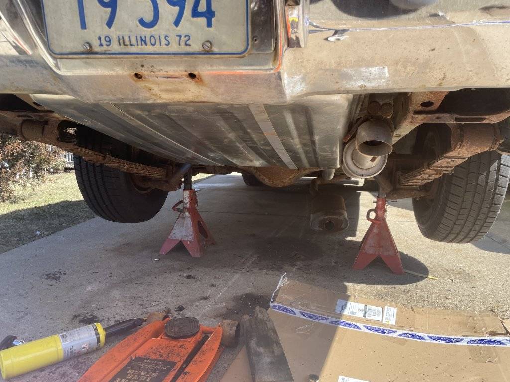

I got tired of the nasty, ratty tail pipe so I broke out the MAPP gas torch and the sawzall. I’m going to get the muffler removed next, and replace them with the NOS pieces I bought months ago.
I got the old trailer hitch off of the car and the new tailpipe mocked up. I am taking the intermediate pipe off to get the muffler off.
The pile of old parts is starting. I will be doing shocks and suspension soon.

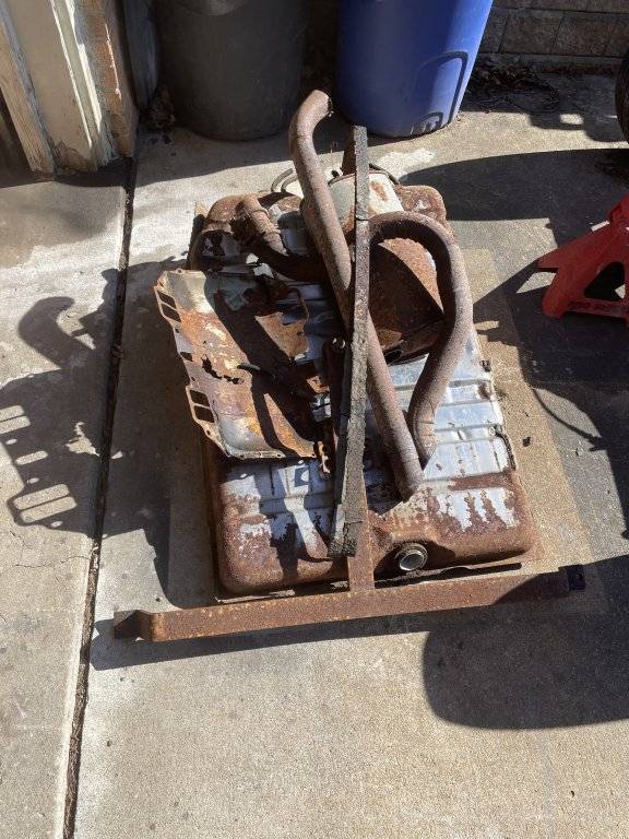

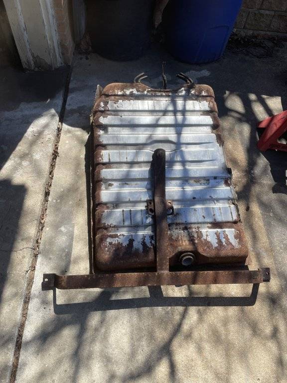

Here is the pile of scrap that came off the car. I may save the hitch but it is so light duty it needs work for towing a real trailer.

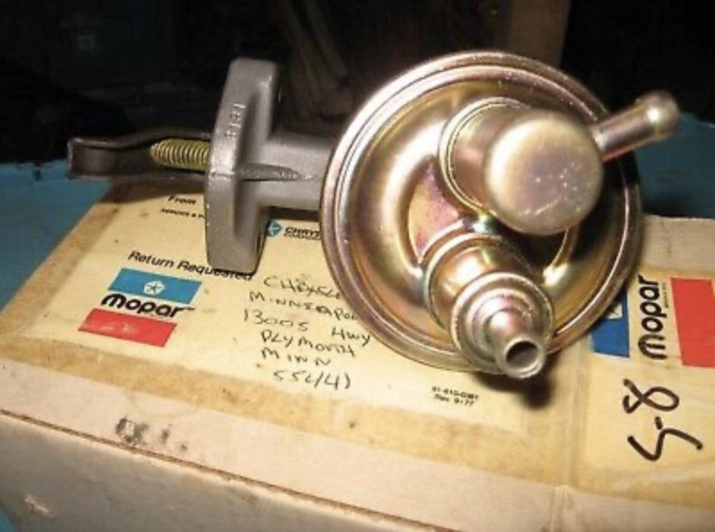

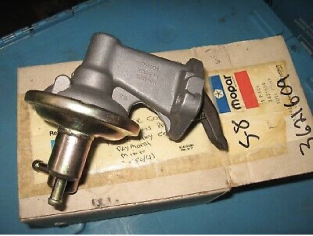

A new carburetor is now in place. I was able to get the carburetor stud installed as well. The fuel pump is the issue at the moment.
I hope your push rod for the fuel pump is okay...I had this happen, where I replaced the fuel pump but still had fuel delivery issues...turned out to be the rod.
No. The dipstick shows 10 qts. So the diaphragm broke and pumped 5 qts. of gas into the crankcase.

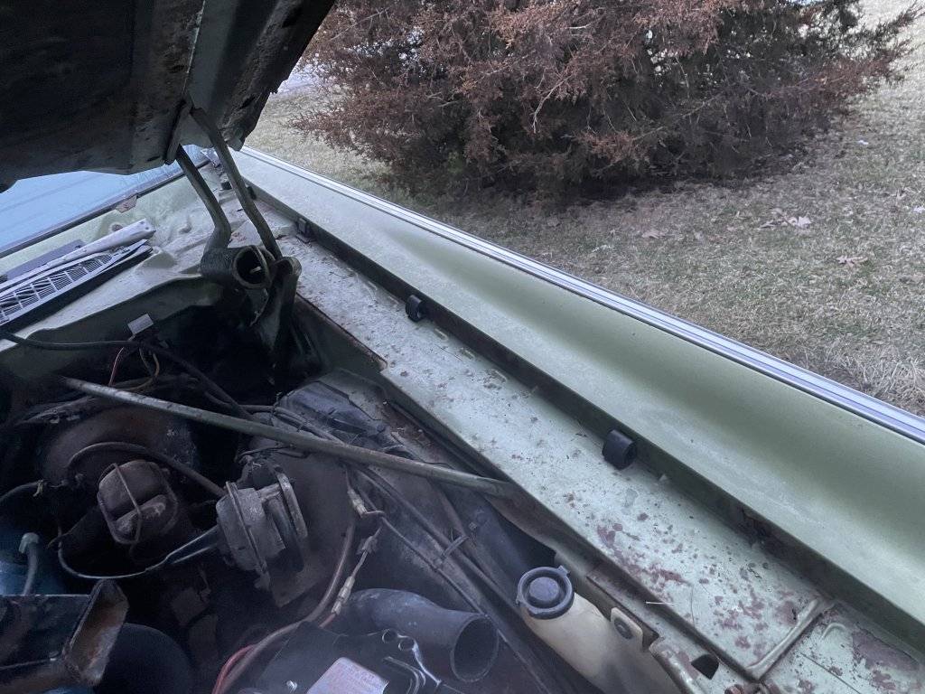

I will be reviving my Imperial this spring, but I am gathering parts and doing small things this winter to help me stay occupied. I am making this my progress thread if anyone wants to follow along.

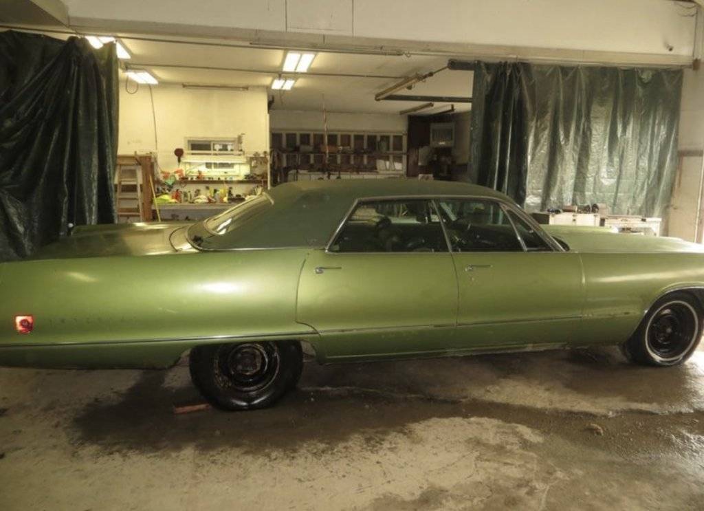

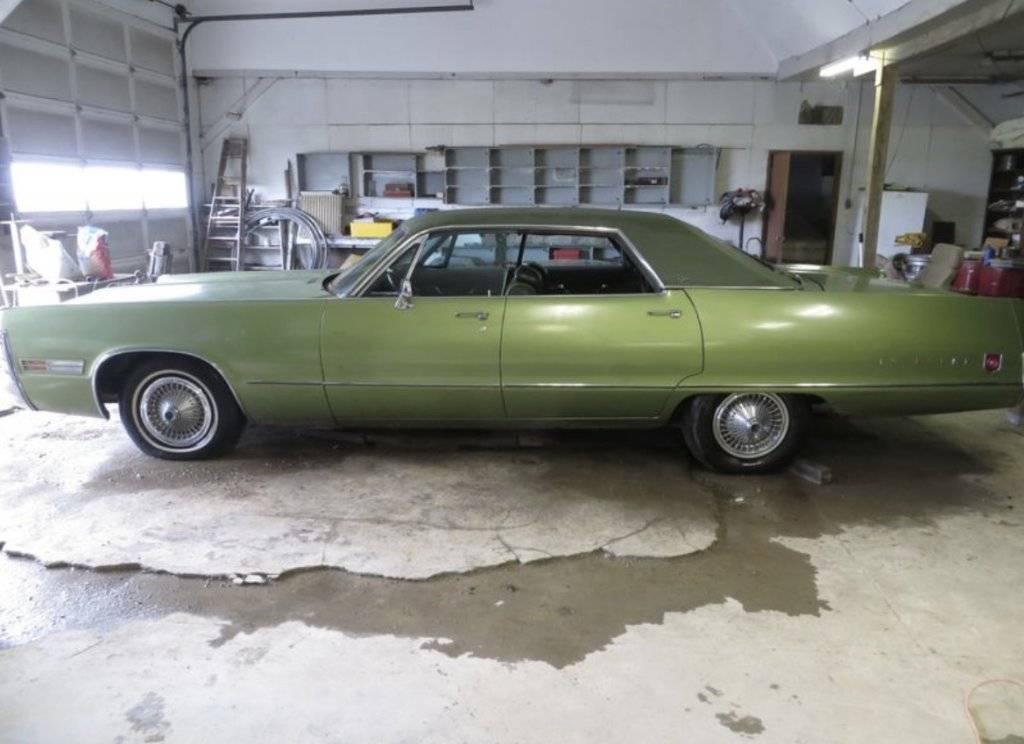

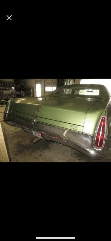

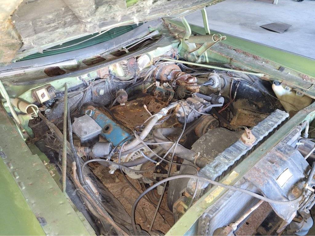

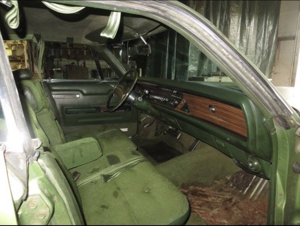

For those who do not know I went to Ohio and picked up this Imperial out of an old car dealership. It was originally owned by a man in Michigan. He is the owner of a plastic manufacturing plant that makes many reproduction Mopar parts.
It was advertised as a barn find of course. These are the ad pictures.

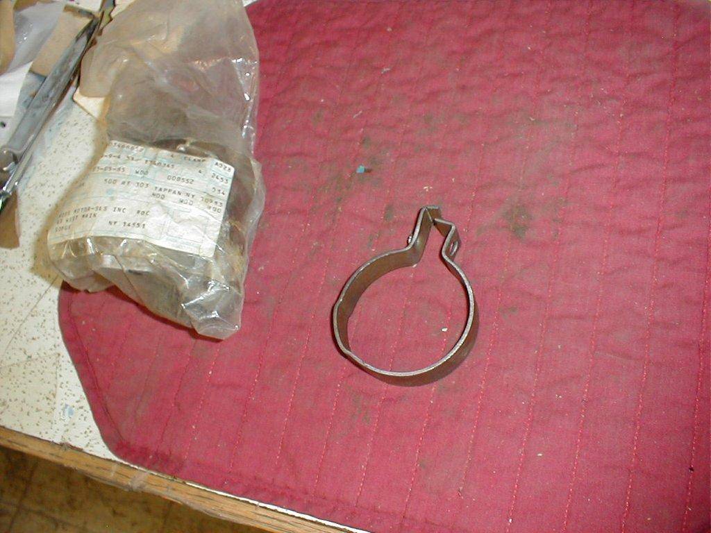

New hanger parts are here tomorrow, I will be ordering two muffler clamps from Accurate Exhaust once I measure the muffler inlet/outlet.
