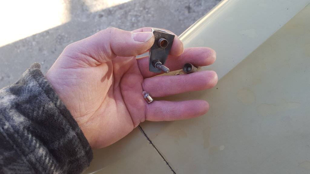

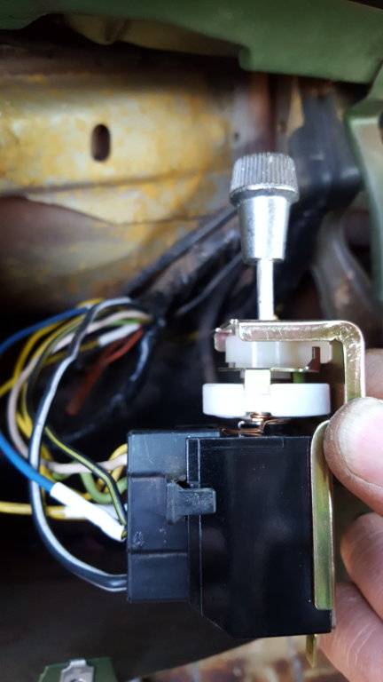

Soldered in some good wire and installed a new headlight switch. Lights seem to all be working now with the exception of the fender mounted turn signals, will continue investigating...
Blimp.. Remove the fender light from the car... One wire plug in..
Hook up to a battery.. If dead, replace bulb....
By removing the fixture you are creating a clean ground
to insure proper operation...
By unplugging it you are insuring the plug is clean as well...

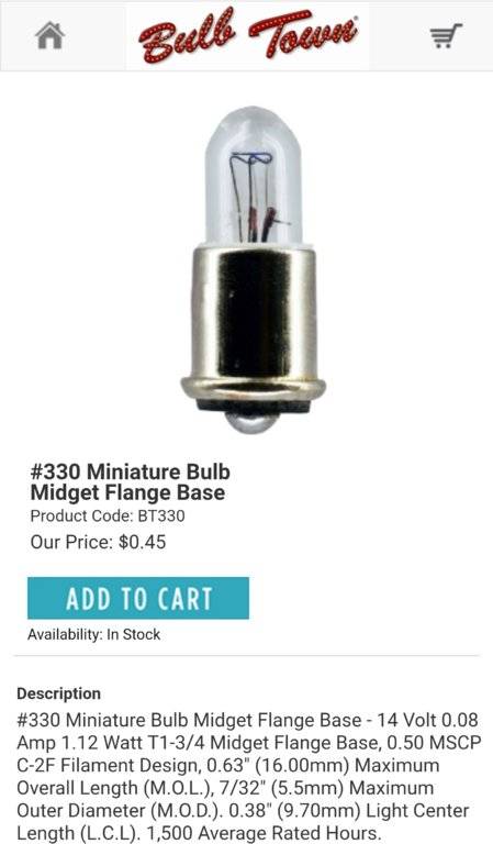

Thanks @Xenon for the tips. I found that one light was burnt out and the other was actually unplugged from the harness. New bulbs are on the way from Bulb Town...
Bulb Town: Buy Lightbulbs, Cheap Light Bulbs & Commercial Light Bulbs | Buy Bulbs Online

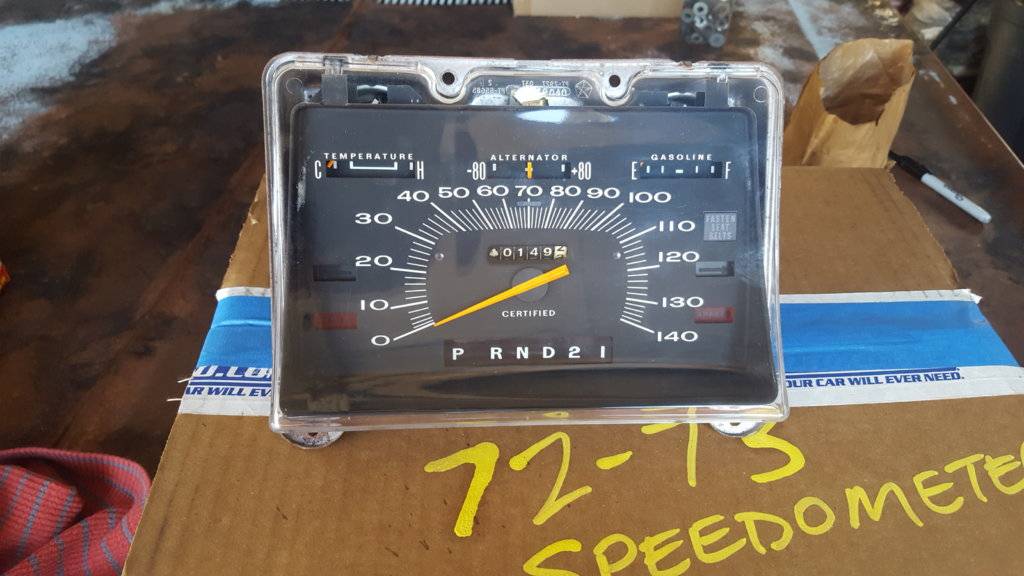

Figure while everything is apart I'll toss a clock in the dash and upgrade the speedometer.

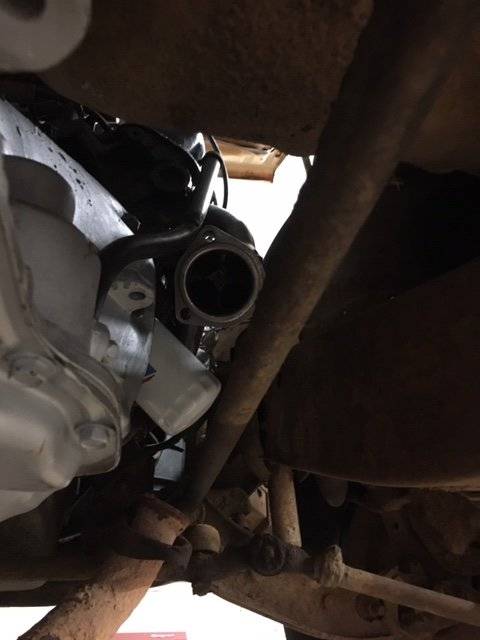

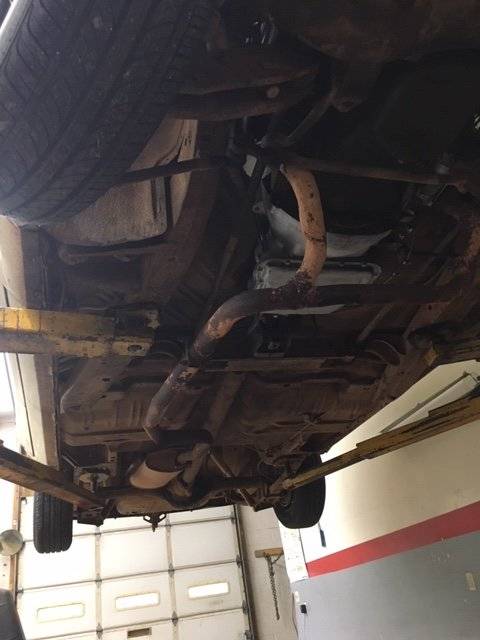

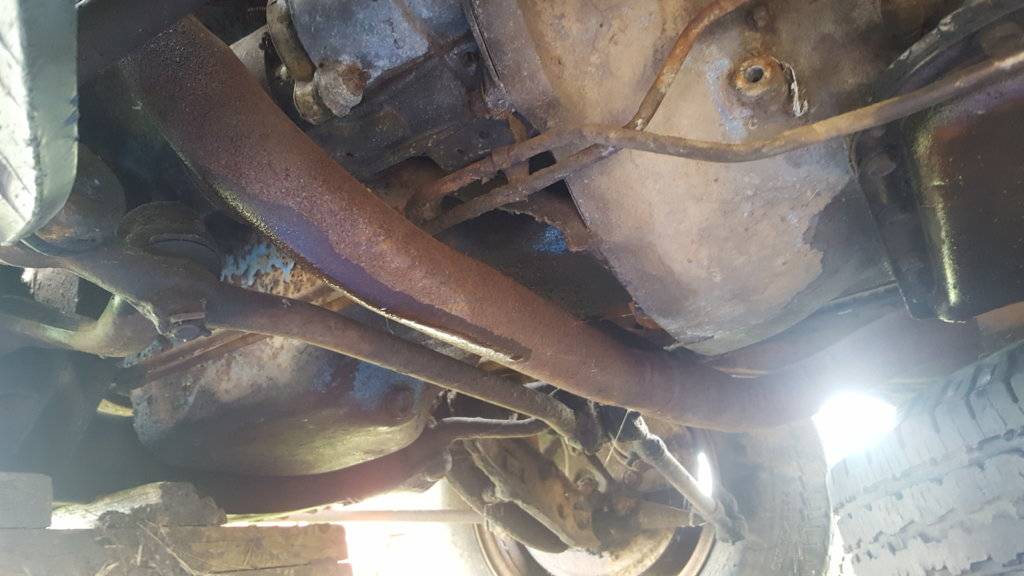

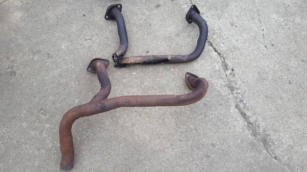

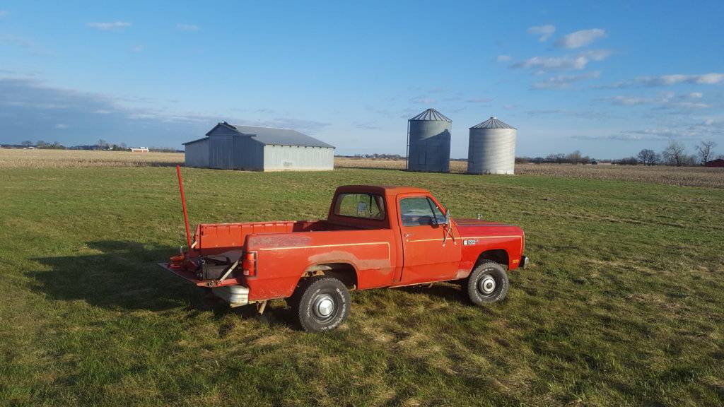

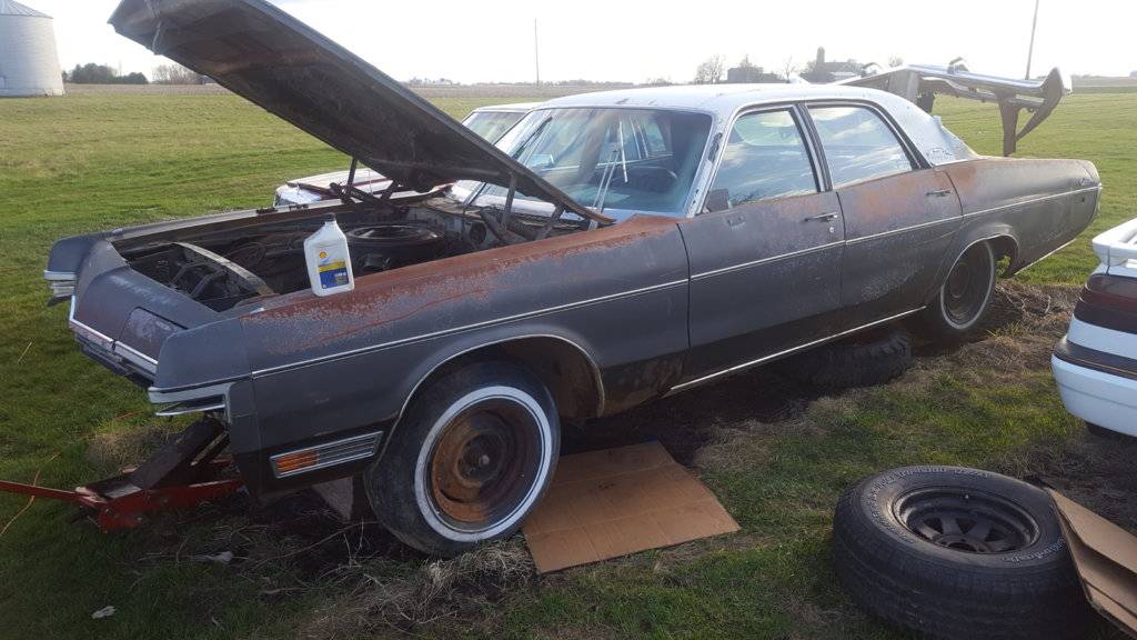

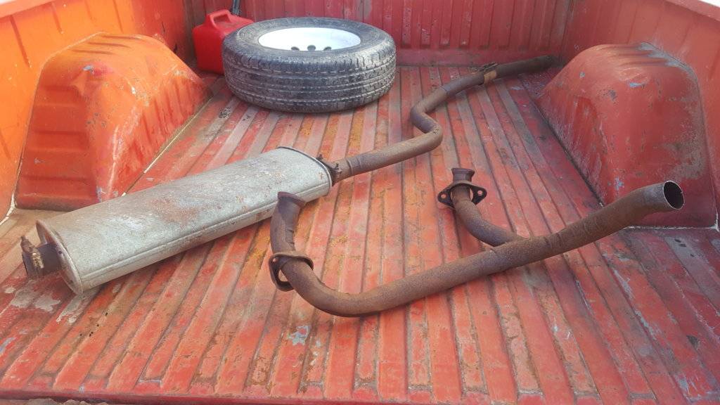

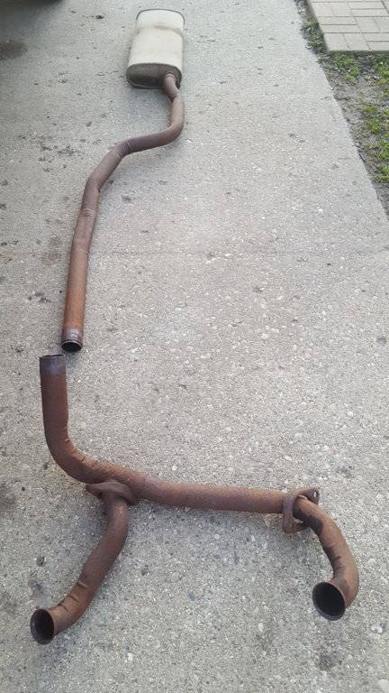

Monday I was very suprised to find that the junkyard parts car I purchased a couple years ago still has a very solid exhaust system, so it's going to donate it to the project.
The Monaco is being stored in my parents pasture, so this was a perfect opportunity to use my newly purchased Dodge Ram to haul it home.

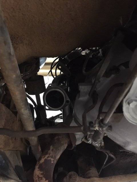

Was able to get what was left of the original downpipe removed, but in the process noticed that both engine mounts are torn apart. Guess all I can do is wait for another Rockauto order, hopefully that comes in by the weekend so I can get all this wrapped up.

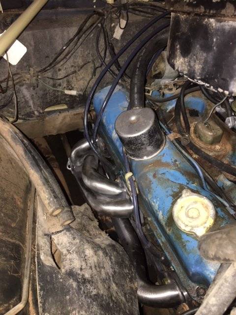

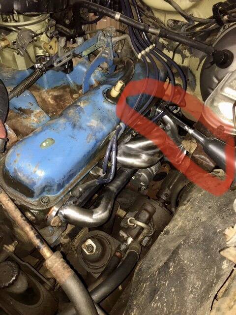

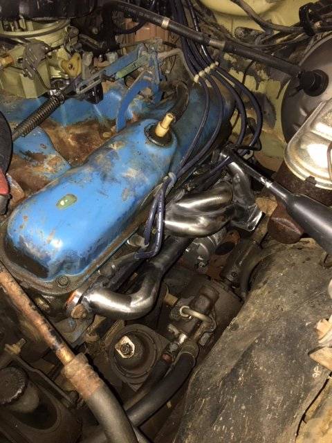

I went a bit sideways from the standard replacement parts, had some fun, bought a set of Sanderson DD7 block hugger hedders for Chrysler, Dodge, Plymouth A-Body 318-360 V8 engines, rolled the dice and actually got them to fit and work. Only alteration needed was to swap the original starter for a NAPA mini starter ( Part # 244-6415) and all seems good.

Anyways- I'll attached some pics of the hedder install as I'm not sure how many C Body wagon owners have done this.
Nice

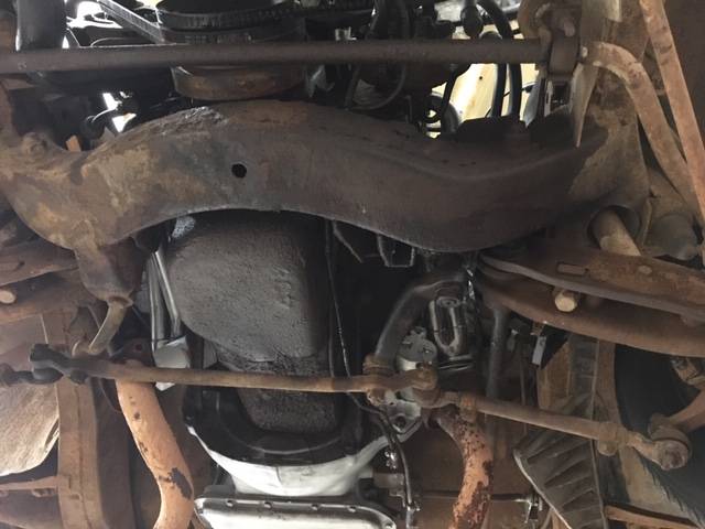

what is the thing I circled? A pry-bar?
@f1967franche hey those headers look great on there, what was the year/model for the starter you bought? I'm probably going to buy headers for this sometime in the future, but after realizing I had a decent stock setup I'm going that route for now. Thanks for the pictures, feel free to toss up more as you progress.

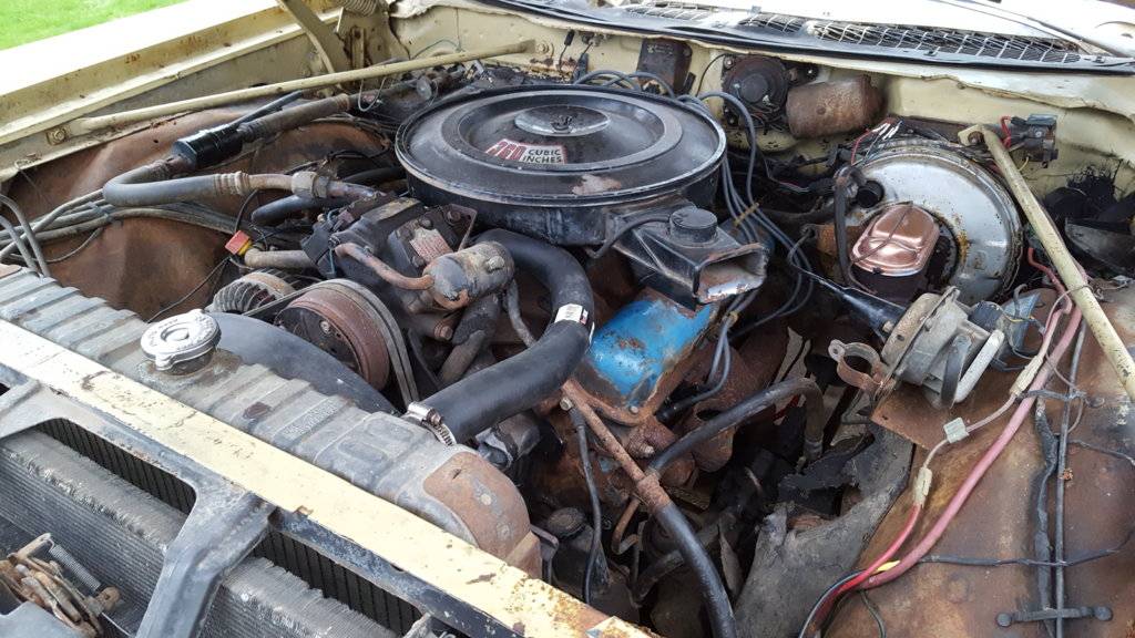

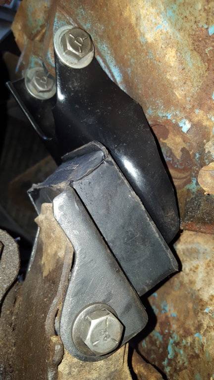

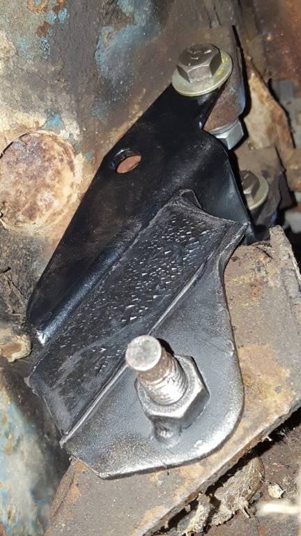

Installed motor mounts today. Went to the hardware store and replaced those darned locking nuts with regular ones and a lock washer. The engine sits much straighter...also installed the Y pipe and replaced some leaky heater hoses. Hope to get the muffler installed tomorrow and then take it out to buzz around.
Installed motor mounts today. Went to the hardware store and replaced those darned locking nuts with regular ones and a lock washer. The engine sits much straighter...also installed the Y pipe and replaced some leaky heater hoses. Hope to get the muffler installed tomorrow and then take it out to buzz around.View attachment 368105 View attachment 368106 View attachment 368107

Seeing that dash bezel and speedometer really gave me a fun flashback. Wish I knew how to fix cars back then like I do now... I could have saved her..
