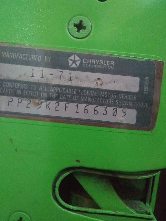

Here it is. Thanks
That's the vin vehicle identification number- I meant the silver colored one from under the hood that says gp2 etc as they're the car type, paint and upholstery colors etc, this one doesn't tell much except if a car is a cut and shut where it'll be different in the various places the number is located on the body.
My apologies for not being clearer before.
You may wish to check the numbers before taking delivery - if this number differs from that usually (I think) on a metal plate in front of the driver side windscreen, or stamped under hood somewhere due to being a replacement door then you won't get registration or insurance until sorted out. I only mention this as if the drivers door was replaced without the original tag being retained or documentation about it, you may have trouble.
Anyway, congratulations on your purchase and the usual cast of characters will chime in to suggest ways of spending your money.
As has often been said - we like spending other people's money.:rofl:

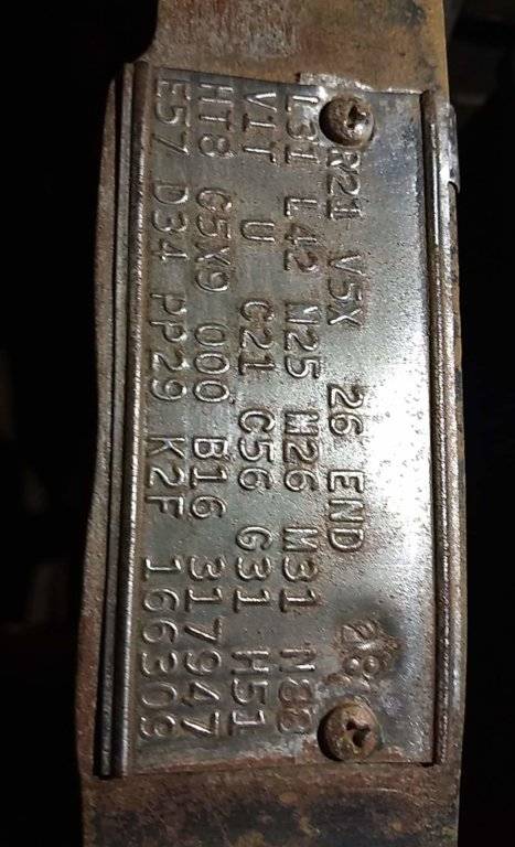

Hi, I have been able to decode some items. Can anyone fill in the blanks? Thanks:
Unknown
Unknown
Unknown
: Unknown
Unknown
Unknown
: Sequence number
E57: Exterior Color
D34: Trim - Luxury, Cloth/Vinyl Bench Seat, Unknown Color
PP29: Int. Door Frames
K2F: Build Date: 2F
166309: Order number
HT8: Top Color
G5X9: Unknown
000: Unknown
B16: Unknown
317947: Unknown
V1T: Unknown
U: USA Specifications
C21: Center Front Seat Cushion
C56: Bucket Seats
G31: OS RH Manual Standard Mirror
H51: Air Conditioning with Heater
L31: Hood/Fender Mounted Turn Signals
L42: Headlamp Time Delay
M25: Wide sill moldings
M26: Wheel Lip Moldings
M31: Belt Moldings
N88: Auto Speed Control
R21: AM/FM Radio (5 1/2 Watts)
V5X: Body Side Stripes, Black
26: 26in Radiator
END: End of Sales Codes
28: Unknown
Congratulations! Looks like an interesting car.
Here is what I decoded the VIN as:
PP29:
Plymouth Fury
Premium
2 Door Sports Hardtop
K2F: Unknown
1972
Newark, DE, USA
166309: Sequence number
E57: 360 cid 2 barrel V8 255hp
D34: Light Duty Automatic Transmission
HT8: Dark Tan Poly Exterior Color
C5X9: Trim - Charger, Cloth/Vinyl Bucket Seats, Black
000: Full Door Panels
B16: Build Date: November 16
317947: Order number
V1T: Full Vinyl Top, Tan
C56: Bucket Seats
M31: Belt Moldings
26: 26in Radiator

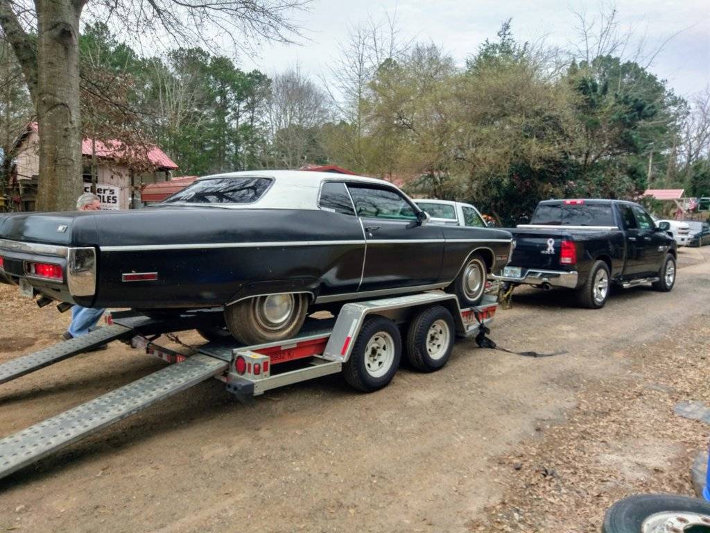

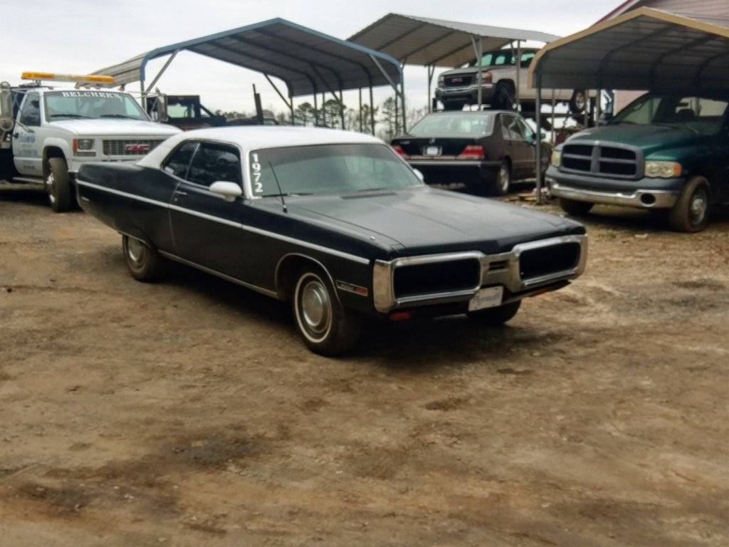

All good. Picked up this morning and just got back to Florida. Very pleased. Needs paint, but very solid

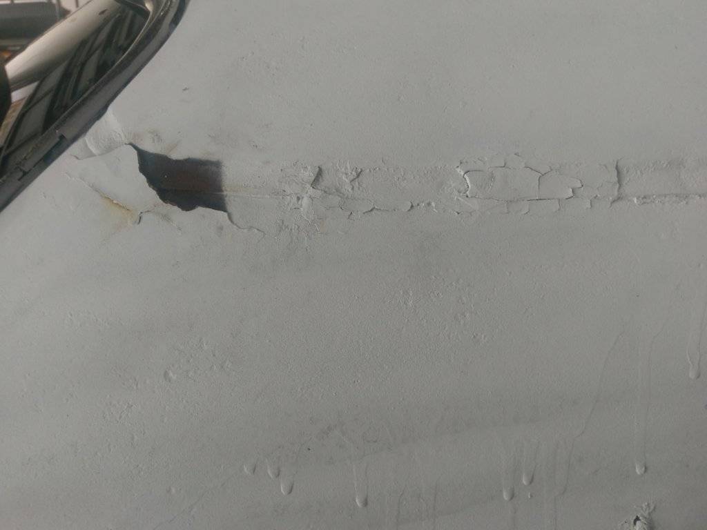

Back home to assess work. Paint is horrible, so going to strip down to bare metal and start again. Bondo on roof, but solid metal underneath, both inside and outside, so looks like it just needs removing and redoing properly . Engine has had some workdone and has a bew magnaflow exhaust fitted.

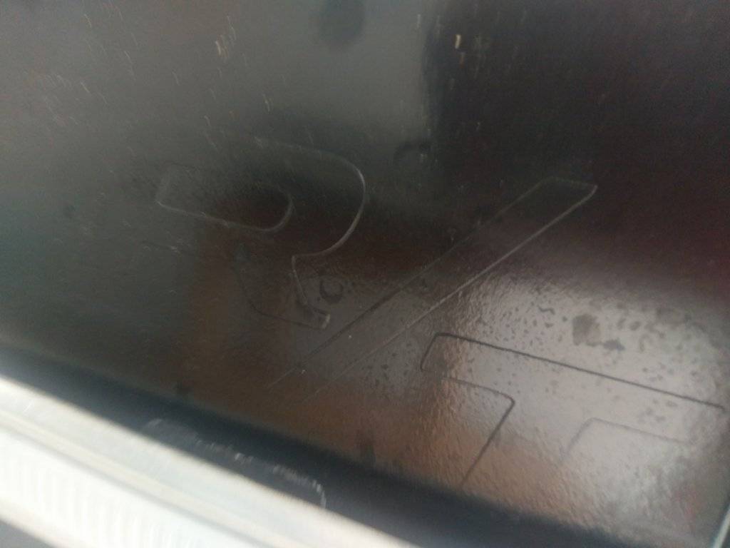

also has some holes in trunk lid, which look like it may have been fitted with a spoiler at some point
Looks like a reasonable project. I really like these cars and hope you enjoy it a lot. That front end is one of my favorites.
Looks like a great project, enjoy working on it. Looks like a few sins to be undone.

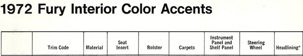

I like your car and I know you said you weren't going to paint it back to the original colors but I think it would be sharp. Here's what I found.
This Gran Sedan looks like it has the same color options as your Gran Coupe had originally except for the interior.
All data from The 1970 Hamtramck Registry Home Page
Exterior Paint
Vinyl top
Vinyl side and rear molding. (I believe your car had black based on the rear vinyl molding.)
