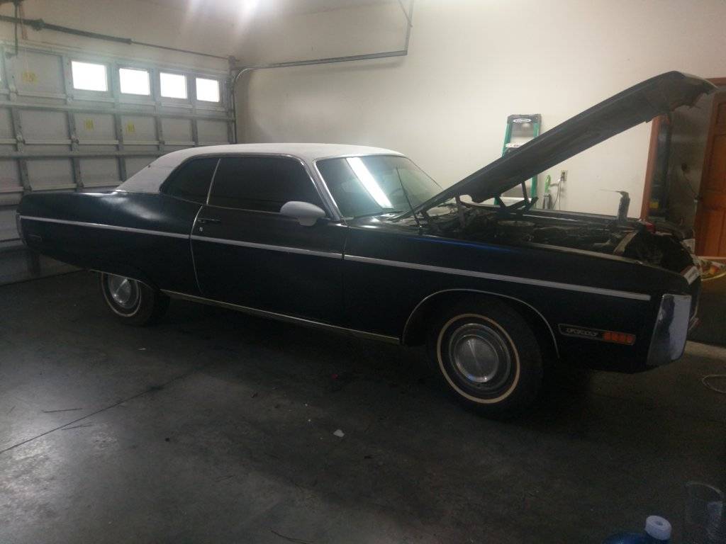

1972 Plymouth Fury - not mine

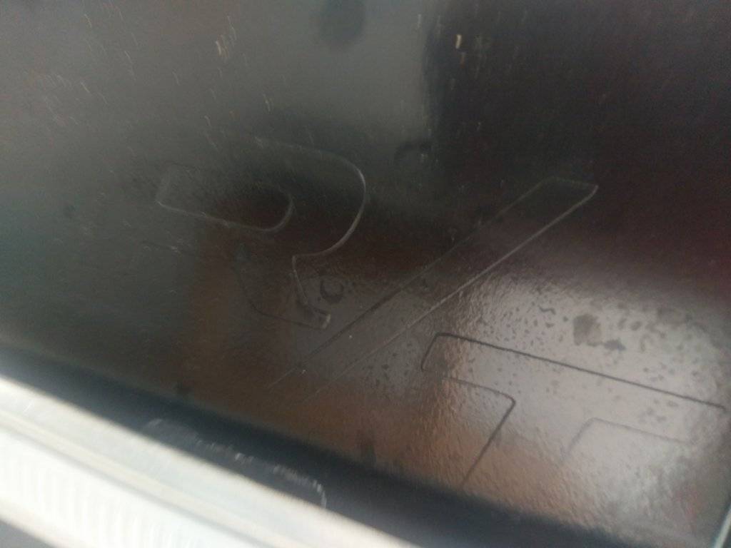

Yes, I removed the side moldings, and that was the color of the original paint underneath. I am stripping back to bare metal, but my preference is black or red for the paint.

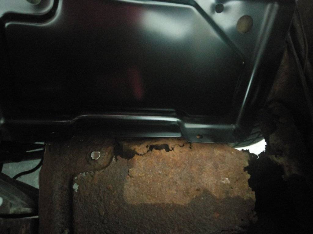

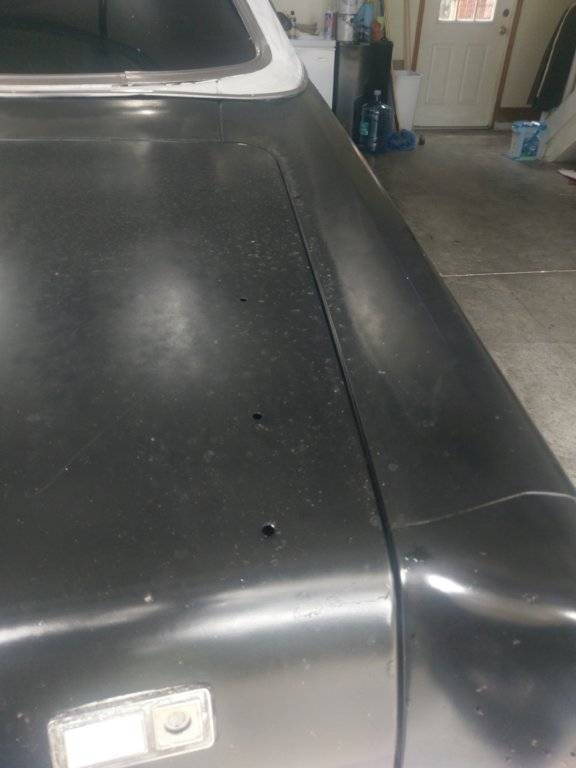

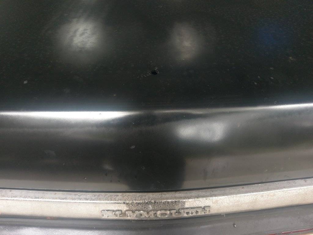

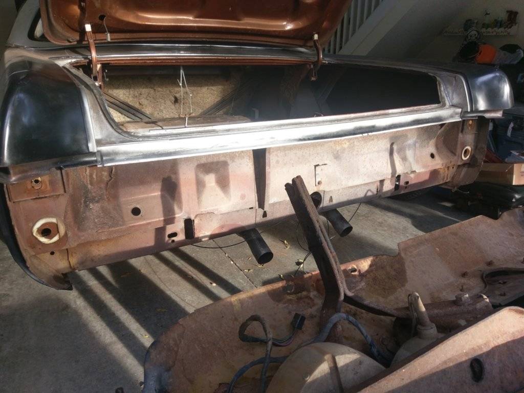

Started on the body work, beginning with trunk. Pretty solid. Three areas with holes, but will be treating rust and fiber glassing those areas. Finish off with a coat of primer.

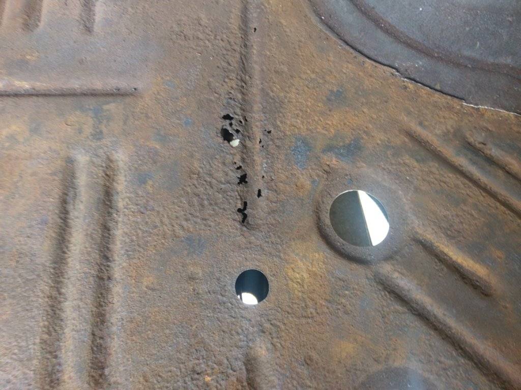

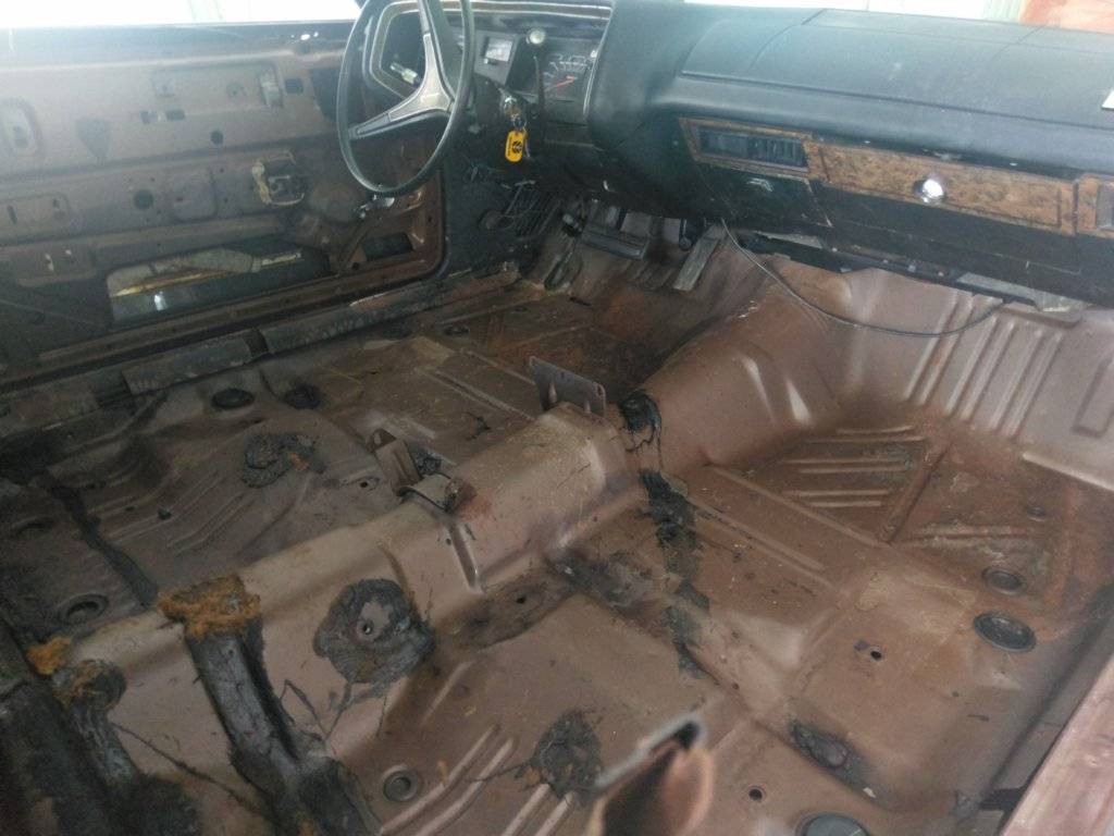

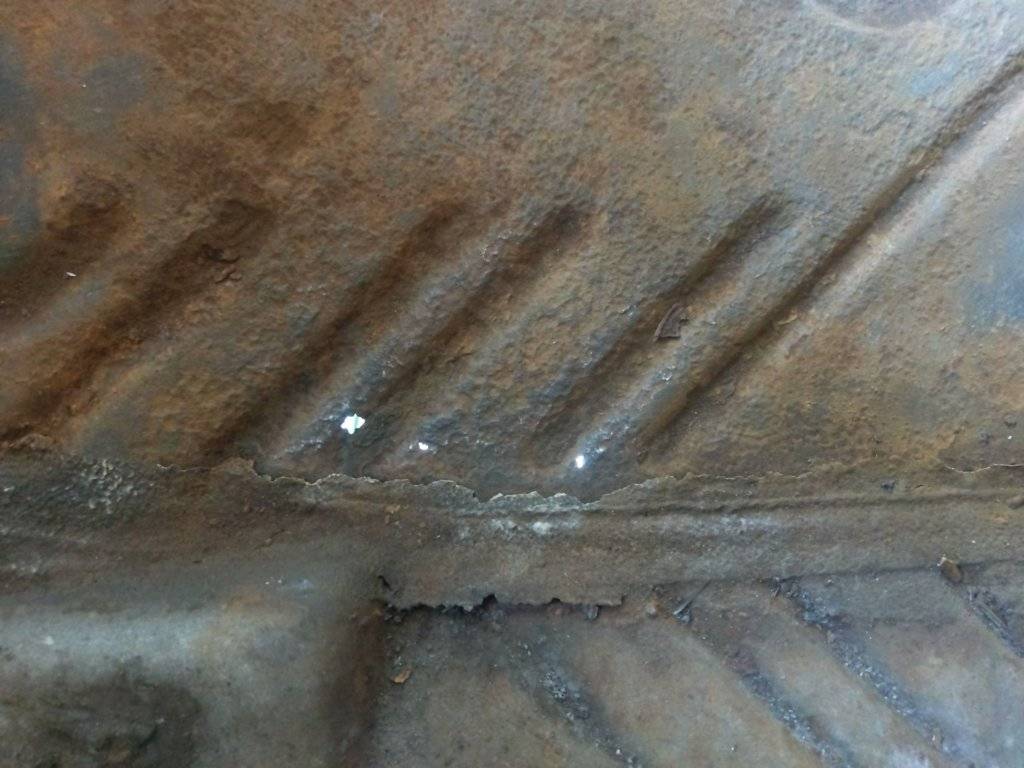

Finished removing all of interior and rust treating trunk floor. Will start rubbing down exterior paint next.

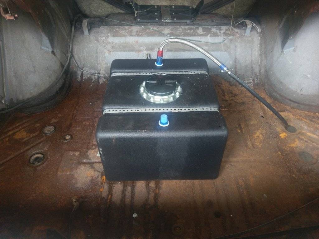

Also my new battery tray turned up today as well.

I will have a look now seats are out. There was a pesky bolt on both sides at the rear nearest transmission tunnel, which had one bolt holding exhaust hanger, and anothe buried inside rail. Took me ages to work out why the seats were stuck, after removing first nut

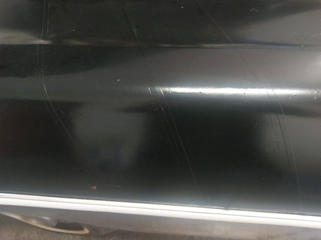

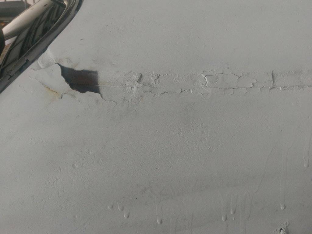

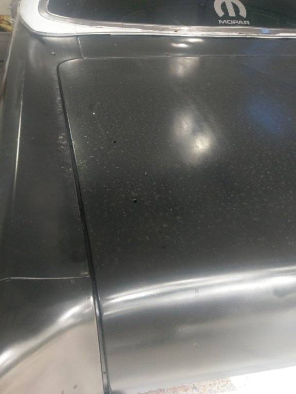

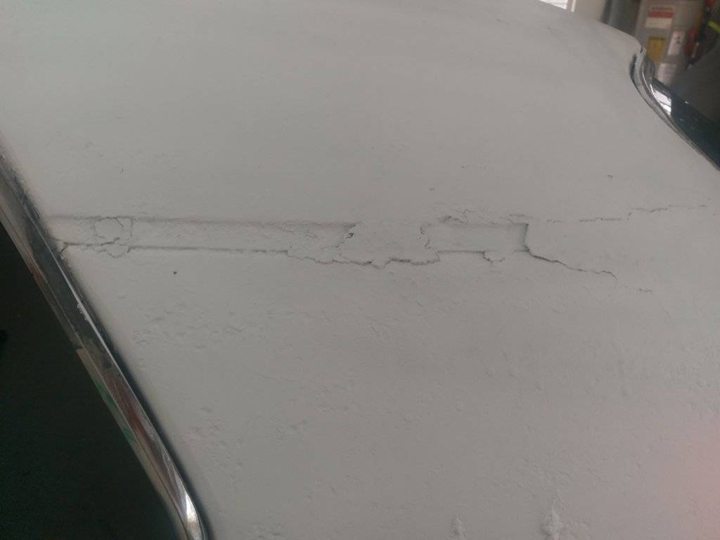

Back home to assess work. Paint is horrible, so going to strip down to bare metal and start again. Bondo on roof, but solid metal underneath, both inside and outside, so looks like it just needs removing and redoing properly . Engine has had some workdone and has a bew magnaflow exhaust fitted.
Nice car and right now it's the inverse of mine as far as colors. That trunk emblem on the right side (if you are replacing it) will be the hardest part to find. Also, make sure you save your door seals, not real easy on those either. Have fun, '72's with the concealed headlights and FURY III front side markers are attention grabbers.

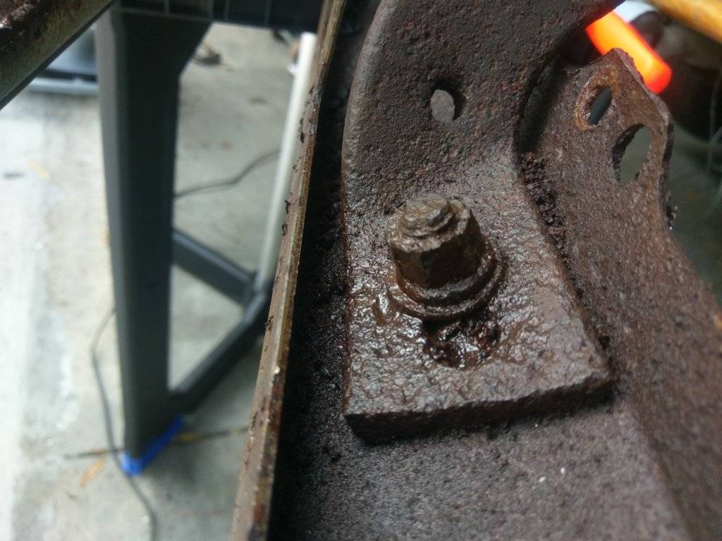

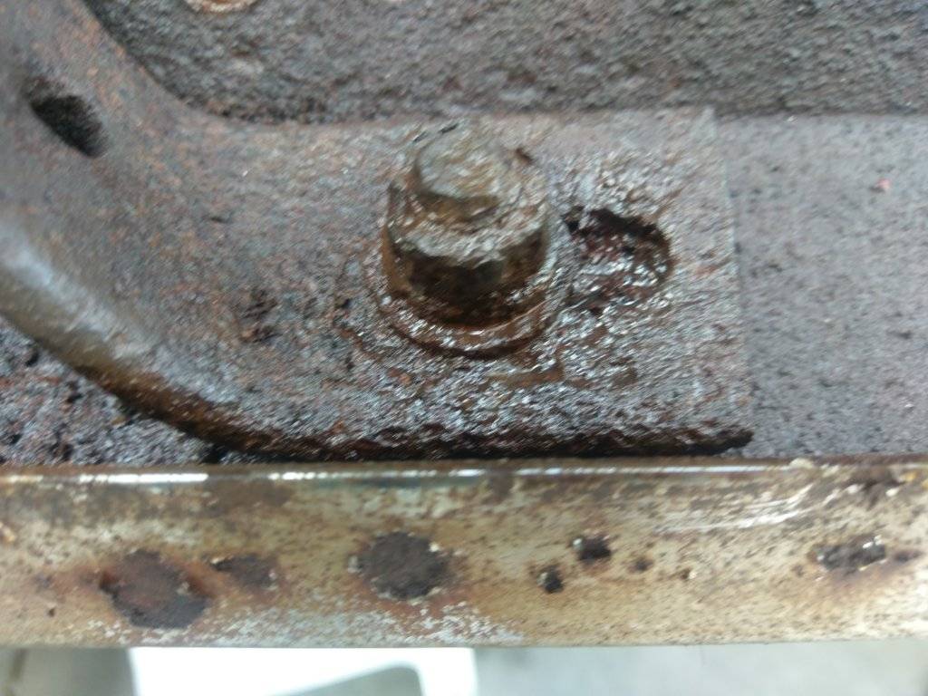

Stubborn rust nut. This is the last nut i need to undo, but is rusted so badly socket will not fit. This issue i have is that this is a stud, so trying to save it, otherwise i would have to weld a new one. Any suggestions as to how to remove and save stud?
Keep spraying penetrating oil on it, try cleaning the rust with a wire brush, and be careful if using an impact. Or use heat if you can get a socket on it.
I had to spray my idler and pitman arm a few timet and let it sit, before the air hammer worked when doing the front end. Patience as always.
There is a tool called a nut buster. Judging from the pics, that might be what you need. That or a lot of luck.
