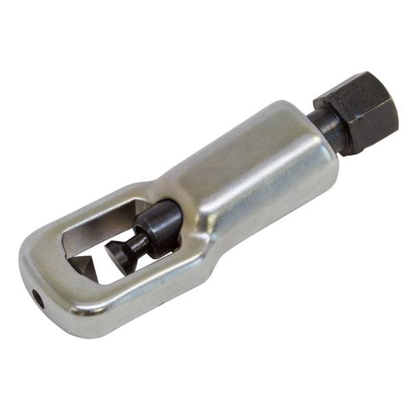

There is a tool called a nut buster.
I'd be careful searching the term nut buster, ya maybe surprised what you get.

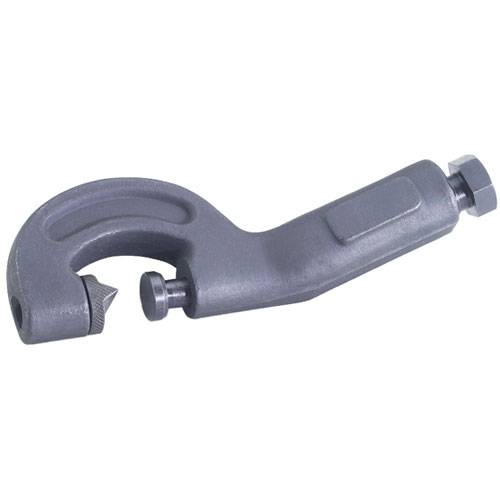

Better off using "nut splitter"...
What I use to use:

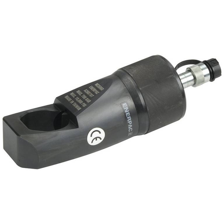

And lookee here a hi-power version!
Surprised they haven't come up with a version for your DeWalt drill!

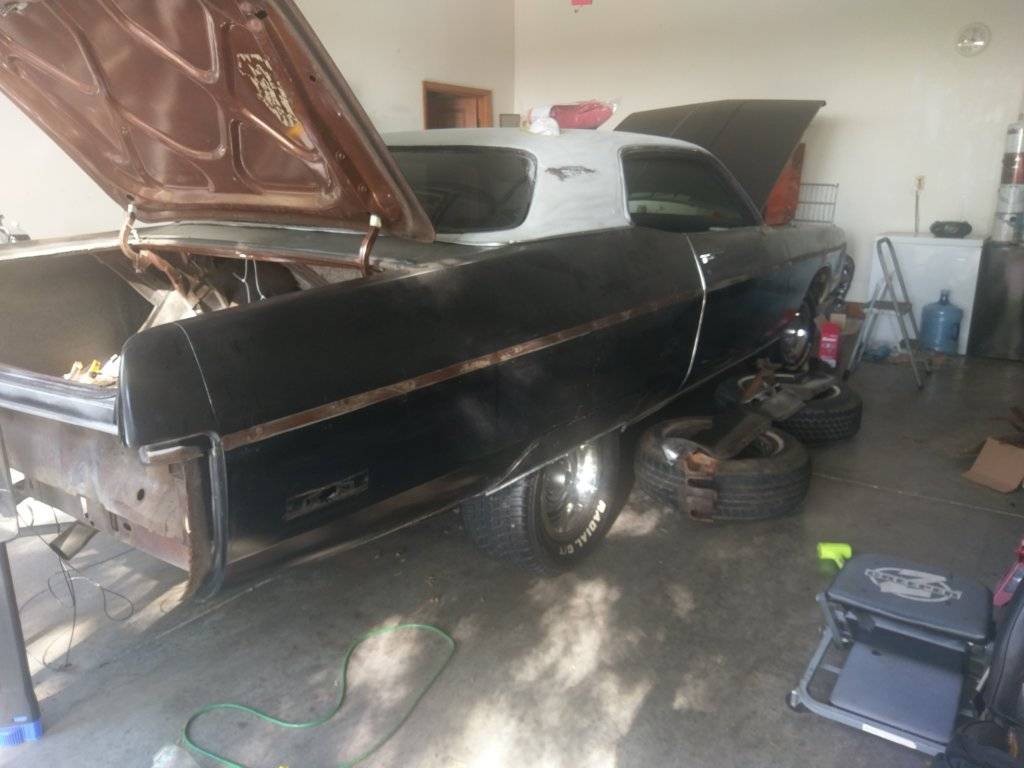

No it is a stud, which is welded to the inside of the bumper. The carriage bolts came out after a good soak in penetrating oil over the course of a couple of days. I will likeky replace these as the exposed threat was corroded.
Anyone tried to remove rubber cover from bumper? Just a case of heating up?
Car has been fighting me all the way today. Tried to change the rear wheel and nuts are stuck fast. Cannot understand as I only had them off a few days ago and did not put them on super tight. Managed to get two off, but the others 3 keep slipping on the socket and are starting to round edges. Looks like another trip out to get an impact wrench.
Managed to loosen a portion of the rubber cover on the back bumper, but it is going to be a long laborious job, heating and removing a few inches at a time. Been on since 1972, so has held up well.
Frustrating day, impact wrench did not work, so spent most of today , heating, chiseling and dremeling the 3 stuck lug nuts. Cannot understand why they were as tight as they were, as i certainly did not tighten them that hard. Thats the way it goes sometimes, a 5 minute job, takes all day.
