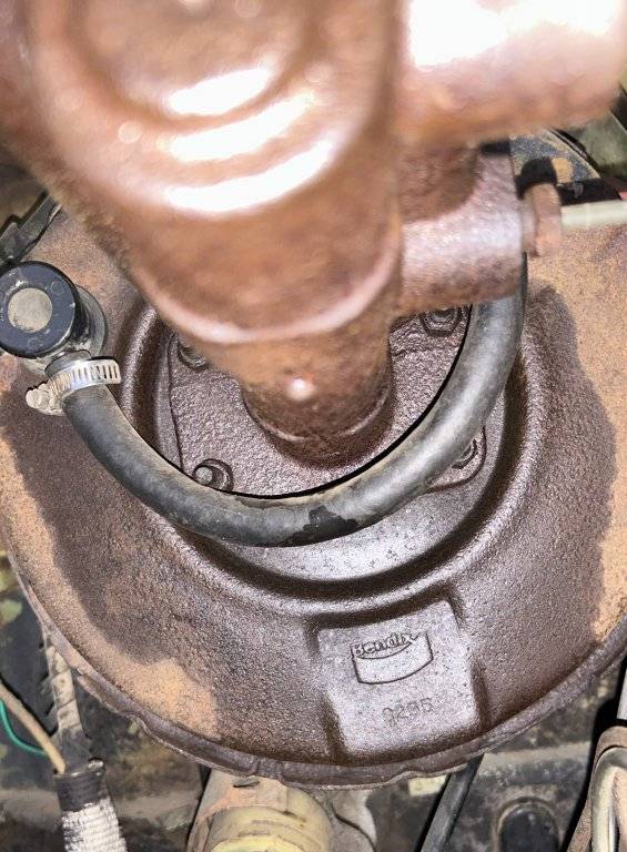

a few weeks ago I drove the car and I got some smoke but complete forgot to go into why and it turns out brake fluid is leaking right onto my exhaust so thank goodness I got home safe but defined do not want to drive it until it’s fixed or changed out completely it looks to come from where the master cylinder and the rest bolt up so maybe it’s some gasket I don’t know but maybe I might as well replace it if I’m going this far already plus I’m noticing that the master cylinder is etching off rust into the fluid. Does anyone know what a good replacement, I’ve seen some online but I’m not sure to get it if it won’t end up working out. Any help Is much appreciated because I’m tired of it up on jackstands.
If the booster is still working, you can change it separately. You'll probably find a puddle of fluid just inside of the booster, in the rubber bellows. Clean it all out. That's what we did when the cars were newer and "just used cars". Your judgment call.

Just change the master cylinder. As said, there may be some fluid in the booster.
Be careful of getting brake fluid on the paint as it will damage it.
