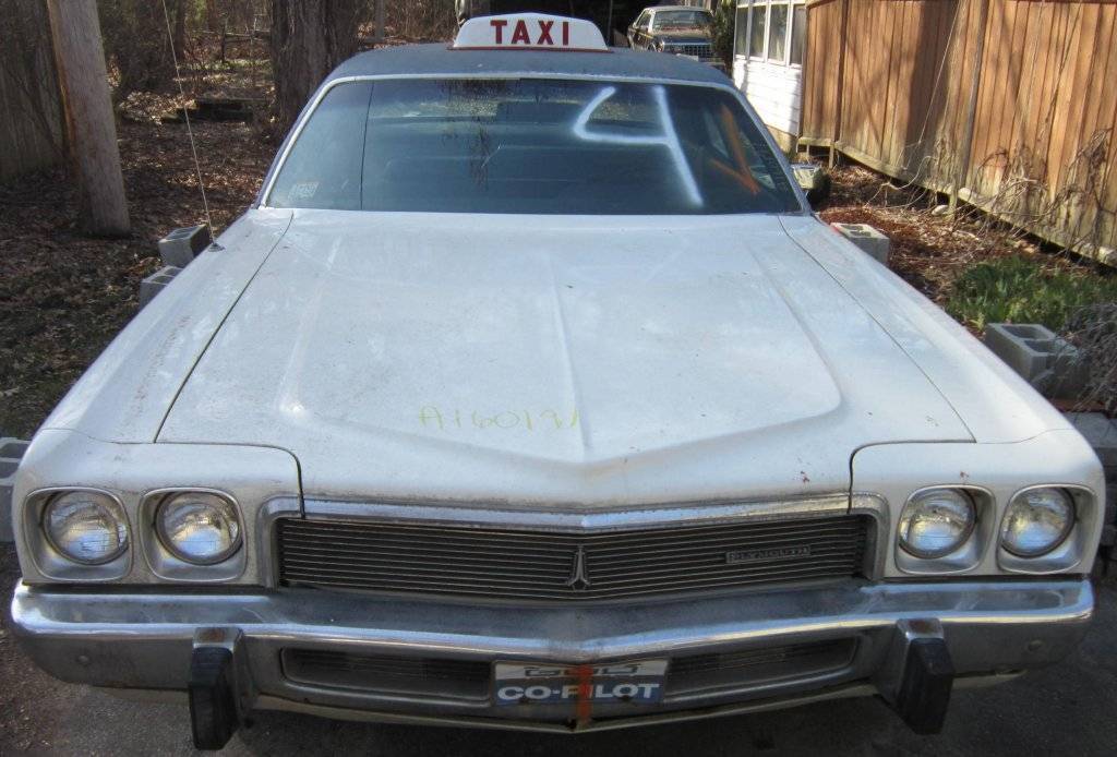

Recently did some work on the Fury. Changed the fluids and installed a new fuel pump. It wouldn't start so we took the carburetor fuel bowl off and determined it needed some cleaning. Also the needle wasn't letting any fuel in. Ended up finding a carb rebuilt kit at NAPA and replaced the needle and installed a new fuel bowl gasket. Tried again and she started up with little effort. Motor sounded real good. We let it worm up and took if for a short drive on a short dead end street. I was surprised how well the small slant six pulled the Fury down the road. I didn't go any faster than 30 MPH but it got up to 30 fairly quick. It stalled at low idle several times so I'll need to rebuild the carburetor. We also gave it a bath in and out.

I just found this thread and I have to say I really dig your Fury. A plain Jane with a twist. So cool! Glad that she's in good hands! And keep us posted!
I just found it too. i cannot keep up with everything on this site - dunno how some of you folks do it :)
anyway, i'll pile on. This is a NEAT, rare, cool car. so, my advice is redundant. Keep it as a taxi in your restoration efforts. can't be more than a handful left in the world.

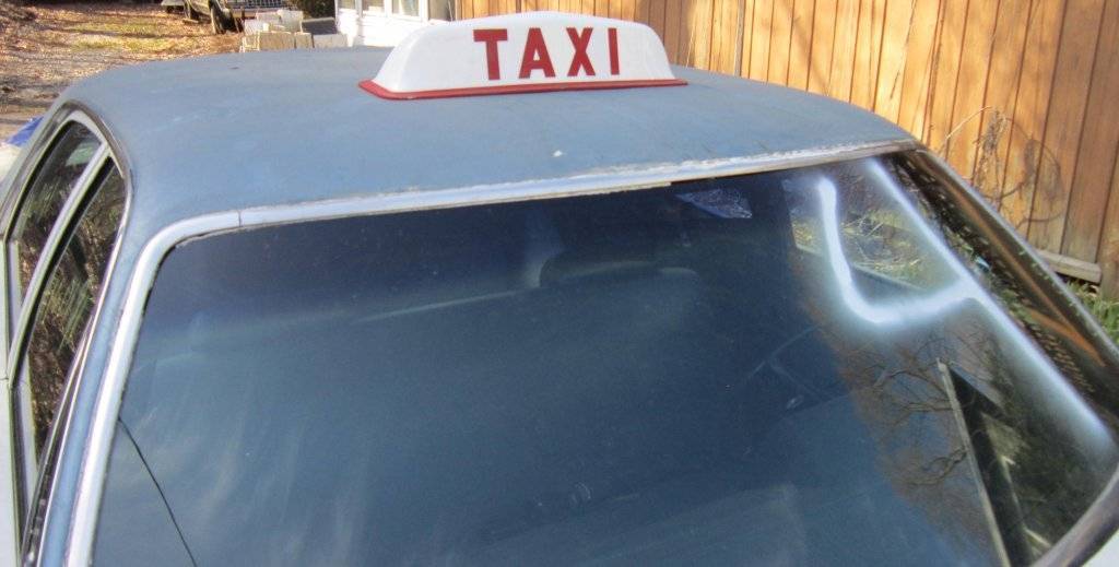

I'll bring it back to the way it looked sitting on the dealer lot in terms of how it was equipped. Before blue top and side moldings were put on. Will need to plug the hole in the roof. Just need to figure out what type of plug they would have used back in the day. Don't want to mount a taxi meter to my dash. Besides part of what makes this car interesting is that it wasn't used as a taxi.

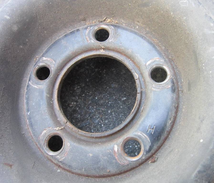

On my way out to a big AMC show in Kenosha Wisconsin I stopped into Murray B Parks in Ohio. Bought a set of four 15 X 6.5 H wheels. These are the heavy duty wheels used on my taxi and I believe police cars and who knows what else. Part number 3580064 near valve stem. Still can't figure out what other Mopar's came with these wheels and why. These came from a 74 fury 2-door. Been looking for these wheels for a long time.

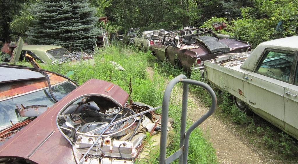

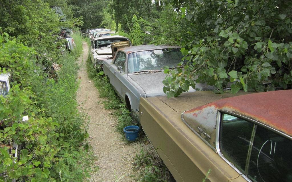

Murray has lots of cars and parts. It's amazing what he has accumulated over the years. Here are two pictures of one location. Supposedly he has two other locations packed full of C-bodies like this one. Real nice guy.
