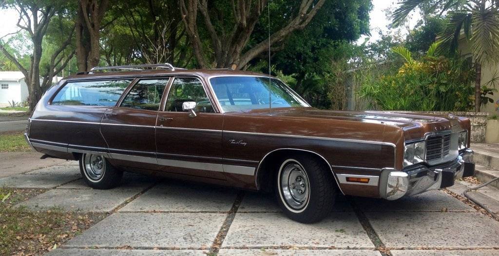

Nice wagon. And I like the wheels your using. Also see that you appear to have rear Air Conditioning.
Here's a photo of mine. Very similar.

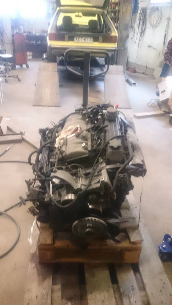

BTW, I just bought 318 magnum...
That was fast. It took less than 48 hours after I paid it to get it to my garage door. Truck freight from southern Sweden to northern Finland. Faster than mailing a letter in same town :D
Some parts are missing, alternator, ps pump etc, but should not be difficult to find. Although I'm still thinking should I keep the magnum multigroove or change to LA v-groove belts. My VW project at background, tiny car almost fits in Chryslers trunk :D
