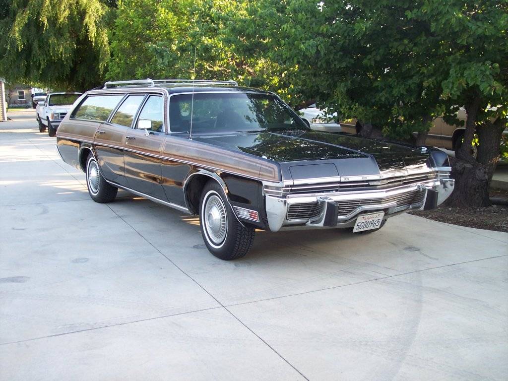

And I have the same dried wood grain issue on my Monaco. I have soaked with Goo Gone, but over the years the wood grain is now chemically as hard to remove as old paint. It's a fossilized mess. I think you either want to replace yours with new, or just strip the old w.g. off and polish the underlying original paint? So if you figure something out let me know! I can't find exact replacement for my wood grain so I will probably just have a paint shop strip it off and repaint the whole car just the base color blue ("boring" monochrome!).
I recently sold my 1973 Monaco black wagon. The guy that bought it from me is working with a mutual friend of ours to reproduce the original woodgrain decals for the 1973 Monaco wagons. They would probably work just fine on the 1972 models as well I think. The guy that does this work is real expert in the field of decals, pinstripes and so on. So they should turn out well. Will keep the site updated as things unfold.
That's great! Please keep me posted! I am definitely interested for my 73!
I am sorry to hear you sold your black wagon. It is a beautiful car. I hope the new owner posts occasionally on this site.

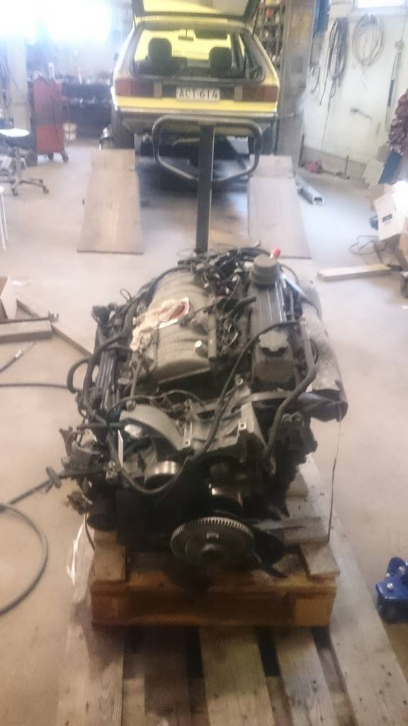

Some parts are missing, alternator, ps pump etc, but should not be difficult to find. Although I'm still thinking should I keep the magnum multigroove or change to LA v-groove belts. My VW project at background, tiny car almost fits in Chryslers trunk :D
If you're going to pull the big block Mopar out, may as well go with an upgrade. Check this out. 700 hp. AND it's got a secret ingredient: "SISU"
