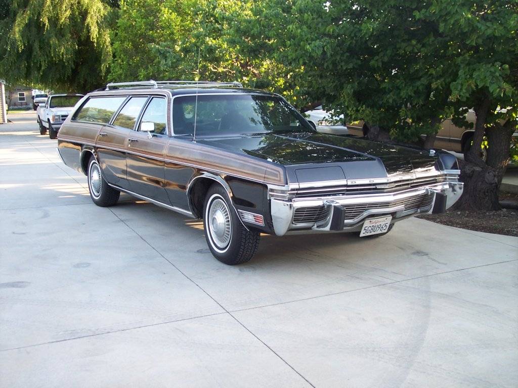

Im sure I seen this car about 20 years ago in the bay area of california. Hard go forget this black beauty
You are correct, as that is the area from where I purchased it maybe 12 years ago now. The guy who purchased it from me also owns a light yellow one as well that I sold him maybe 4 years ago. The light yellow one has been restored to a nice level and will also get the new woodgrain decal again. They will be two beauties. The guy with both of these wagons now does not frequent this forum, unfortunately, as he feels that these forums take too much of his time and he tries to minimize that as a result. But a super nice guy and he has a lot of other mopars as well. Especially Bs and Es of all years.
Small world. He had a white six cylinder dart i went to look at years ago. He was doing something under the hood of it. I cant remember what but i think maybe a timing chain and gears?

Yep, when I bought it, for some reason, he had the intake manifold off, and I couldn't figure out why, but I bought it just because it was so darn nice otherwise and low miles. So I went ahead and put it all back together and rebuilt the TQ carb, and it was as smooth and ran as nice as could be.

Crazy that was an amazing car and I always wondered what happened to it.
I recently sold my 1973 Monaco black wagon. The guy that bought it from me is working with a mutual friend of ours to reproduce the original woodgrain decals for the 1973 Monaco wagons. They would probably work just fine on the 1972 models as well I think. The guy that does this work is real expert in the field of decals, pinstripes and so on. So they should turn out well. Will keep the site updated as things unfold.

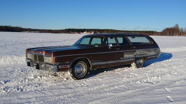

Can you post a photo of your car in the green spring landscape? To confirm: eventually snow melts in Finland!
Snow has already melted :wideyed: Actually May was the hottest month in looong time, temperatures were several weeks between 23-28 degree celsius. Today was the first day raining after probably in month. But it is after midnight, I took Chrysler out, dirty and woodgrain still not removed, took camera and shoot some pictures. To also confirm that sun does not set at middle summer here :)
Looks very stately and dignified. What a fine color.
You are making great progress. Soon the wood grain issue will be resolved.
