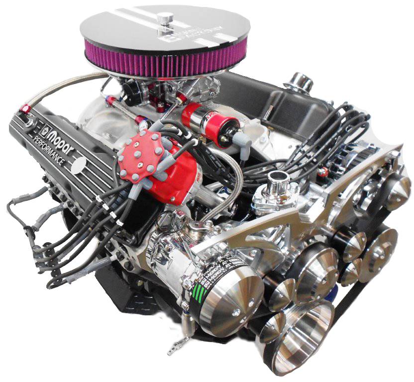

I've decided to go with a complete MSD billet distributor, MSD 6AL ignition box, MSD Blaster 2 coil, MSD ignition wires.
