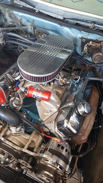

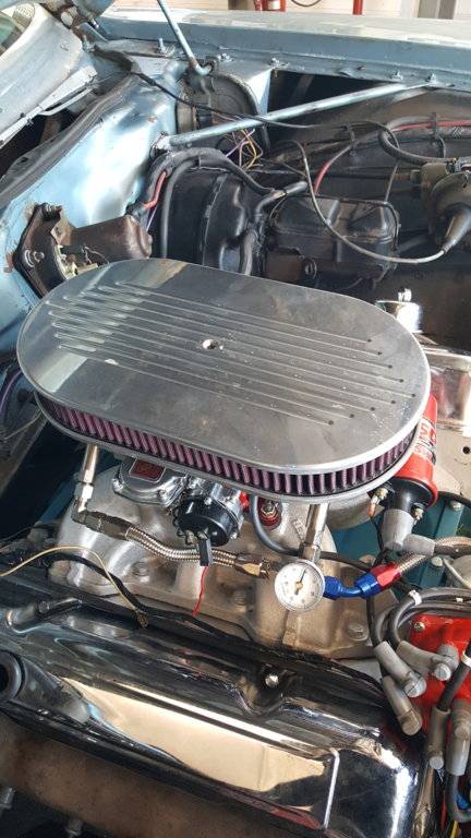

Fixed a lot of the little things and finished up the wiring. I still have the AC to finish, I'm going to replace the air cleaner assembly. I need to add a vacuum canister for the brakes. The cam robs the vacuum.
Uh-oh I see a manual brake conversion coming.I need to add a vacuum canister for the brakes. The cam robs the vacuum
Good.Eventually I will have a 9,25 SG
Not so goodwith 3:55 or 3:91.
with 3:55 or 3:91.
I seriously think you'll find it the best compromise the first time you take an extended trip.Maybe a 3;23.
. That is absolutely insane.
Hydroboost.Uh-oh I see a manual brake conversion coming.
By the way, how's the carburetor working out?
@73 T&CWorks great. The only thing I had to do was adjust the idle speed. Electric choke works great and it started right up with the big compression and cam. Throttle response is immediate. Very nice carb. A little pricey. I think it was $772 but well worth it.
