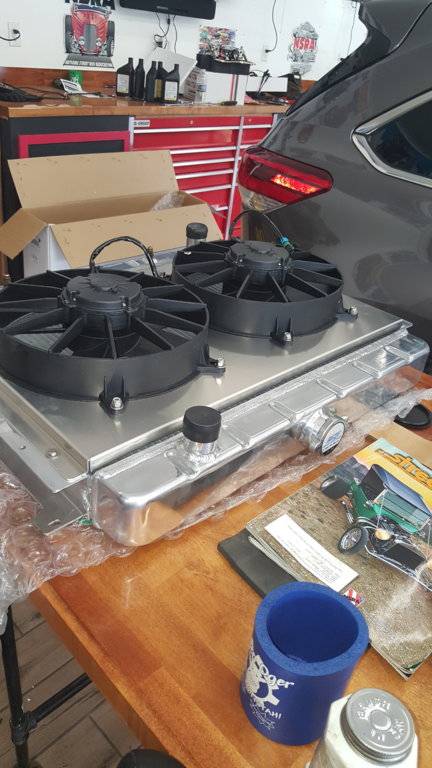

Monster radiator=Monster cooling. We want you cruising in comfort with the A/C going during those hot months:thumbsup:
