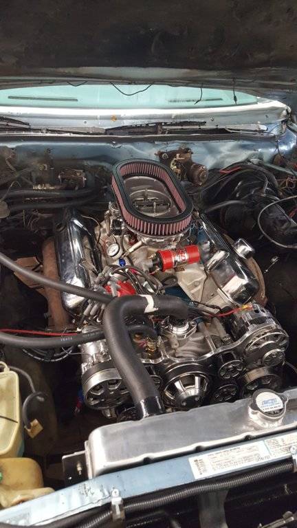

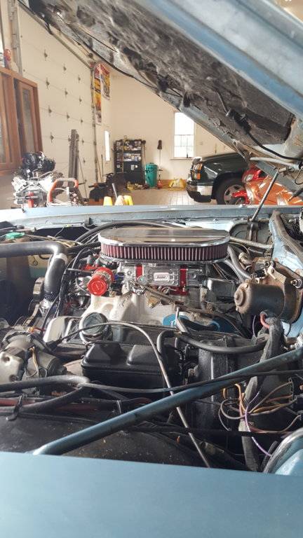

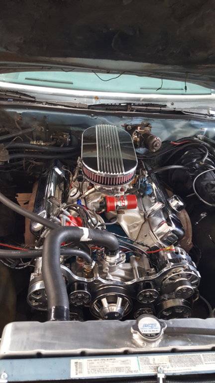

1978 NYB New Engine.....

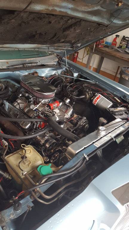

Anybody have any ideas on how to clean up the white plastic on the overflow tank and the washer reservoir.
I have engine Gunk and could spray and soak and then scrub with a brush.
Somebody here on FCBO always has a better solution of doing things....

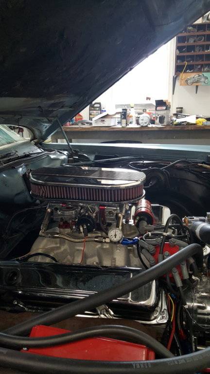

School me on the purpose of this canister plz..
The vacuum is kind of low with the aggressive cam that I have. So when I hit the brakes the first time everything is good to go. If I have to hit the brakes a 2nd time the vacuum is gone and I have a stiff brake pedal. That aluminum canister is a secondary vacuum canister and will ensure that I have a good brake pedal on the 2nd pump if needed. I just feel safer with the additional vacuum and a kind of normal brake pedal if I have to slow down the 5100 lb blue beast in a hurry.
Race cars use these vacuum canisters all the time especially with aggressive cams.
