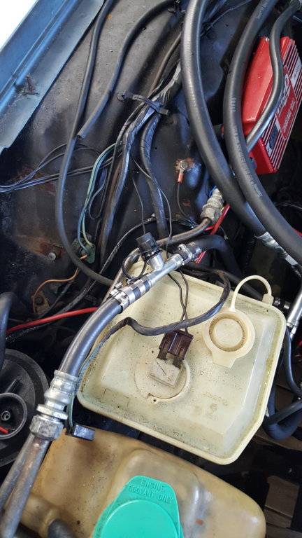

I still have the factory temp gauge wired and working and I'm going to piggyback the SW electrical temp gauge off the same sending unit.
I got to thinking about this...
From what I've read, the SW sender uses a range of 240 ohms (cold) to 33.5 ohms (hot). The stock sender is 74-10 ohms.
That means it really won't work as it sits. It's possible that a Meter Match unit might work. TechnoVersions - MeterMatch for Analog Gauge Correction
You'd need some resistors or a decade box to set it up, but it could be done. We can figure this out if you need to do it.

Thanks John, I'll see if I can add another sending unit somewhere. It's important to get an accurate water temp gauge.

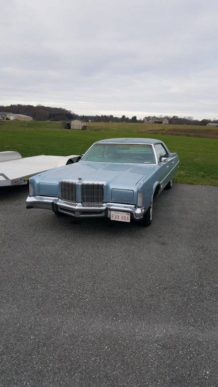

I believe I'll be finished with everything tomorrow and I'll start to put some miles on it before the winter weather returns. We had over 2" of rain since the snowfall yesterday so the streets are dry and pretty clean.
The goal is to drive 200 miles this weekend and change the oil and filter.

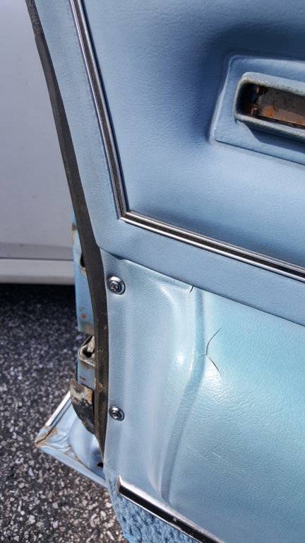

BTW, feel free to PM me if anyone has a perfect or very near perfect set of PLB3 Blue door panels for a 78 NYB for sale. LOL.
