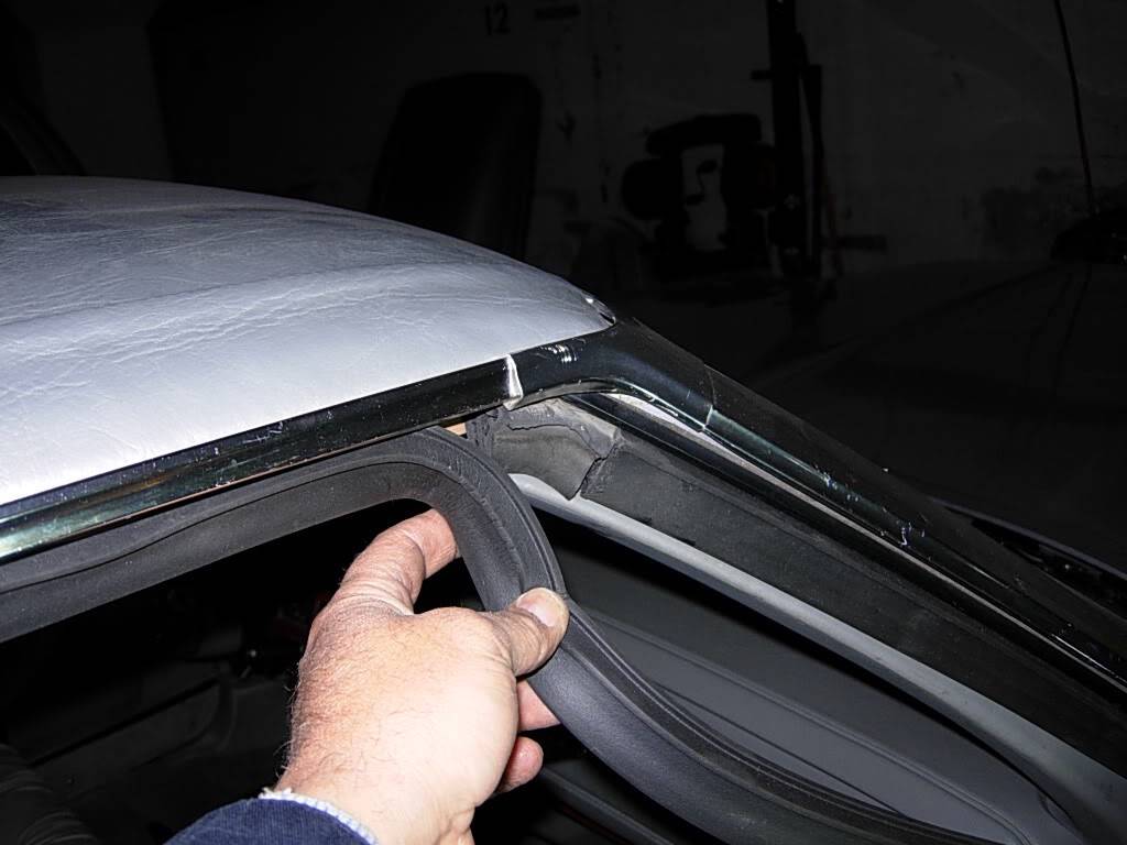

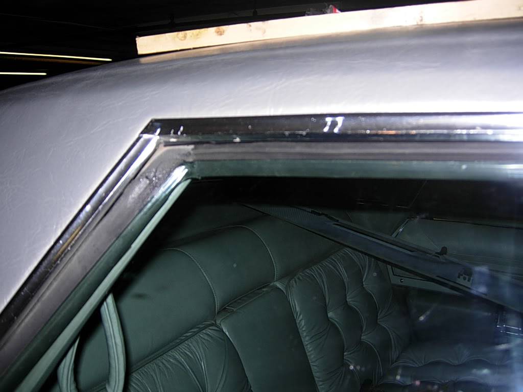

I noticed you need roof rail weather strips. As far as I know they are unobtainable but I did find a fix for my Salon car a few years ago from Restoration Specialties. It’s a GM extrusion that fits right in but you have to cut the ends of your old ones and glue them in with 3m weatherstrip adhesive.
I posted a couple of pics doing my 78. In the second pic you can see the profile extrusion. I can start a new thread and get the contact info with part numbers if you need them. I also have part numbers for the vertical quarter glass extrusion as well but those require a little work to make them fit.

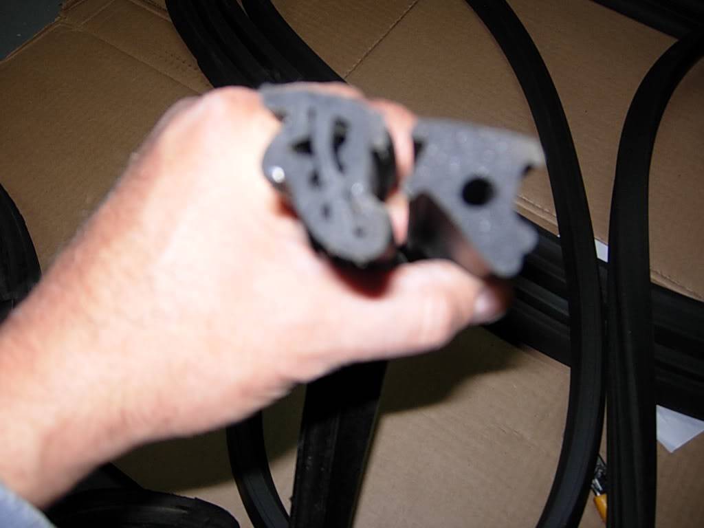

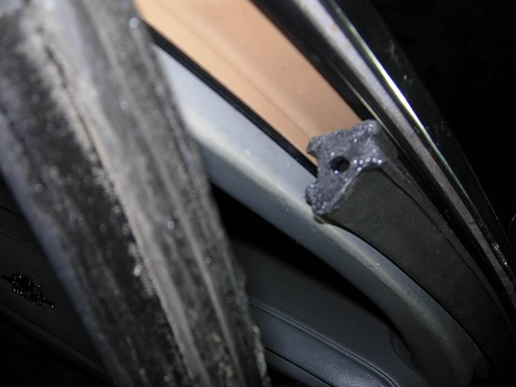

Here is that quarter glass seal profile. Another hard to find part. It also is a GM extrusion but appears to be a dead ringer, nice and soft too. Note that the old quarter glass seal will slide out with WD-40 but the new one will be a tight fit and you will have to sand it down with some 220 grit paper to make it thin enough to slide into the chrome on the rear window. DO NOT REMOVE THE CHROME FROM THE REAR WINDOW, simply soak it with WD-40 and slide it up and off.

The vertical quarter glass seal is a GM number extrusion again and does work. It's 92401.

Here you can see the new extrusion locking into the track of my 78 NYB (4 door). It fits tight and you simply bend it to make the corner at the A-pillar and cut the end off your old weatherstrip on the front door as you'll need to glue them together. On the rear you cut it and join at the top of the C-pillar because the weatherstrip changes to another extrusion anyway where it runs down the C-pillar. (see second pic)
