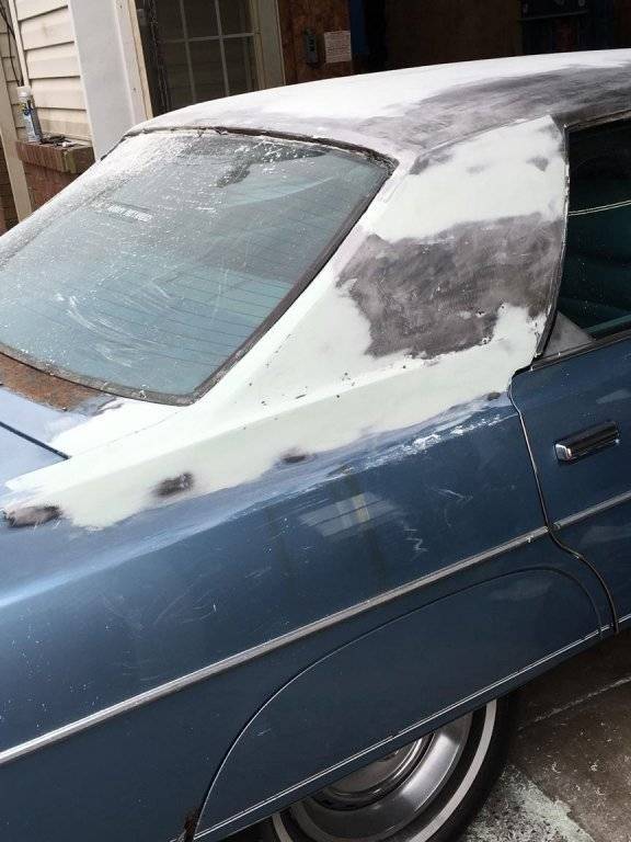

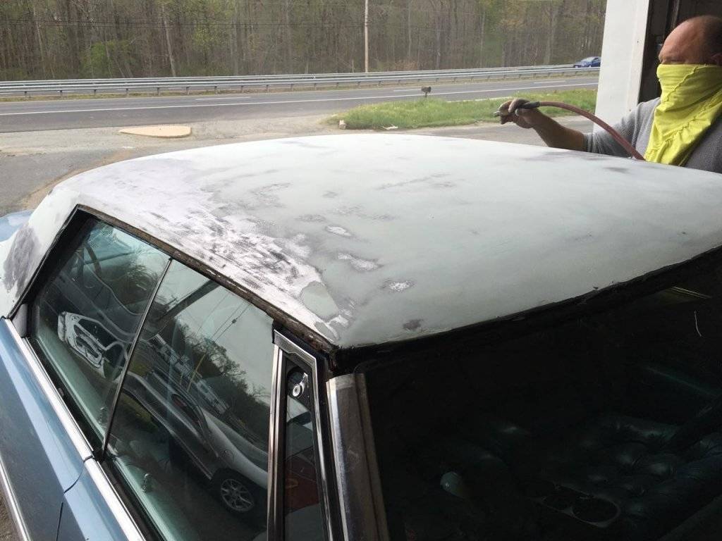

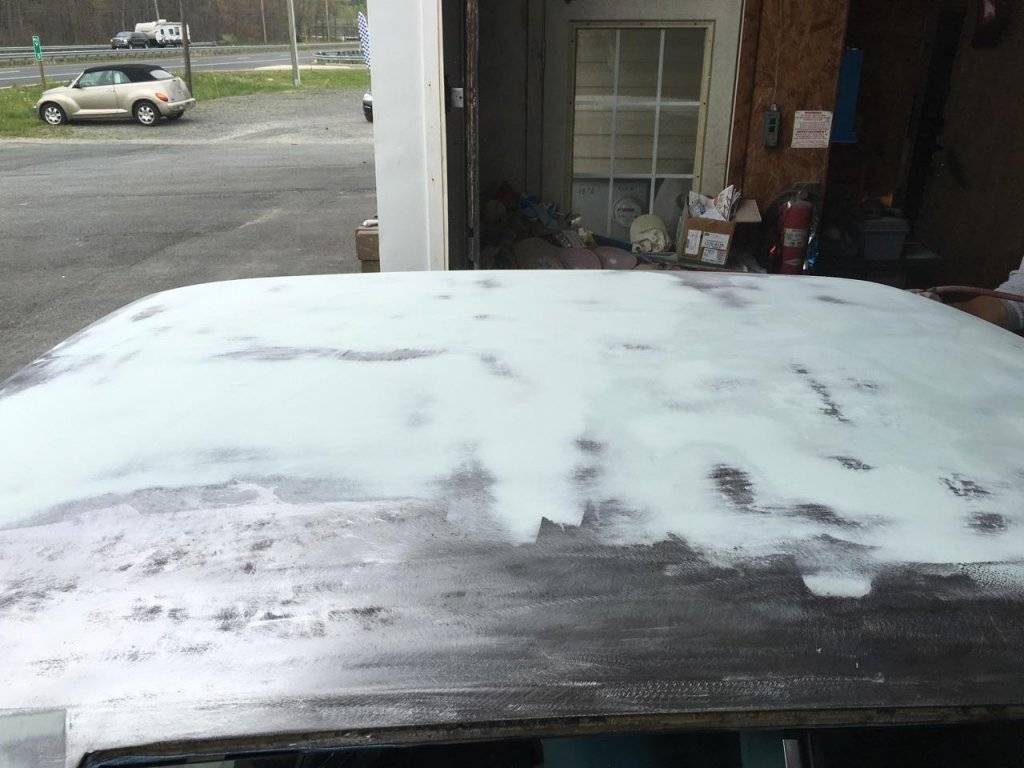

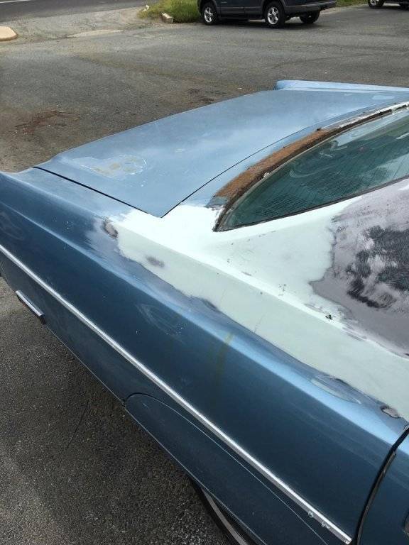

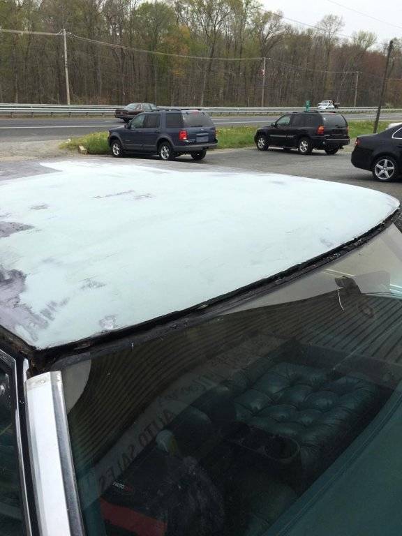

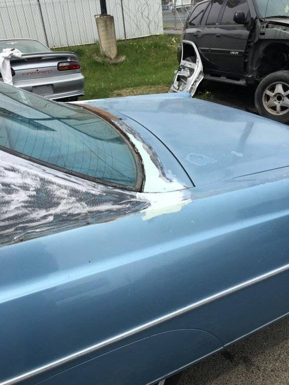

New pictures maybe later today. The roof repair is done from what I have been told.

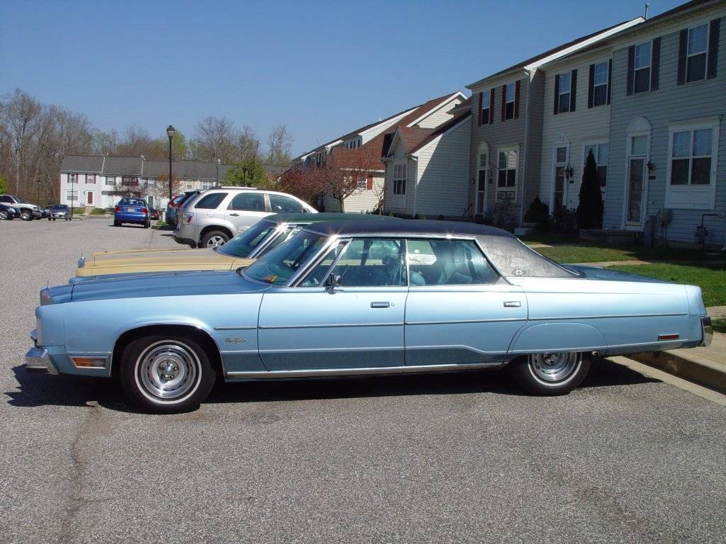

I'm not purist in any way, shape, or form. And saying that I will agree with you that the NYB would look very cool in Gator grain. It would look out of place though....just like my NYB does with an incorrect black vinyl top. PB3 Cadet Blue only came with blue (V1B) or white (V1W) vinyl tops.

I will have a couple of new pictures later today. The roof repairs are done.
