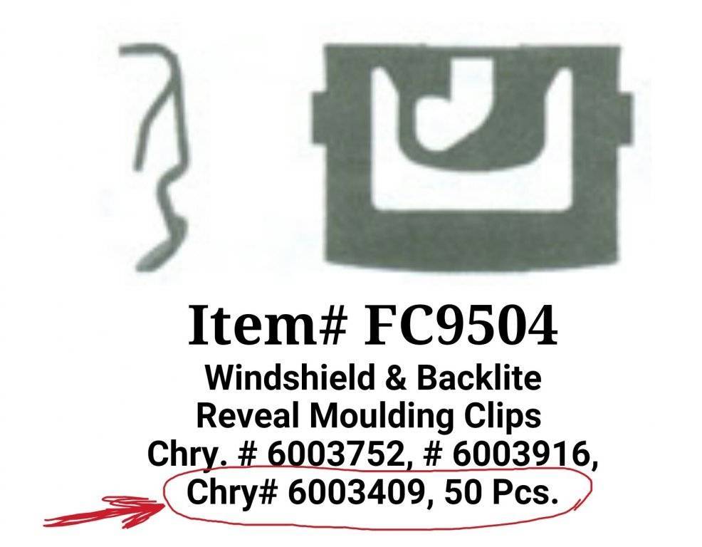

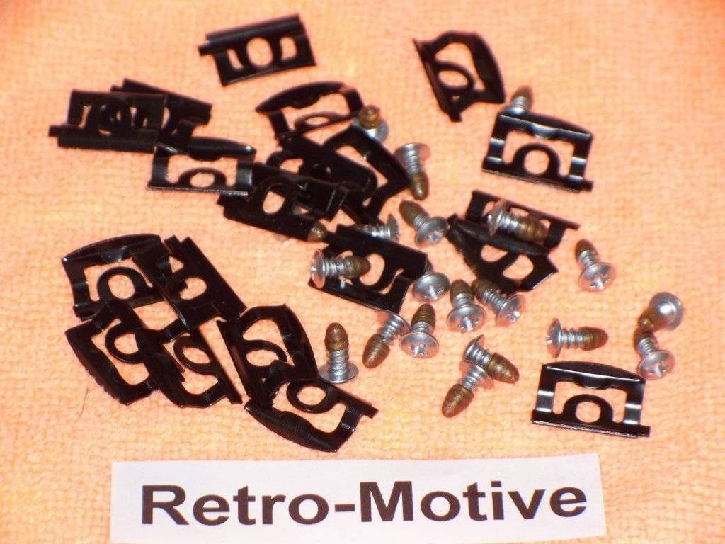

I was about to say they are reusable if they don't break when you remove the trim as Stan has already mentioned. I broke a few and found them impossible to locate. Found many that looked close but the distance from the top of the tang down to the hole for the pin in the window gutter is key. Thought I had some but they were a fraction too short and the trim couldn't grab the tang.

One type looks like this in shape. Height is key. They break on the side when trying to remove the trim especially on my first try before knowing better.
