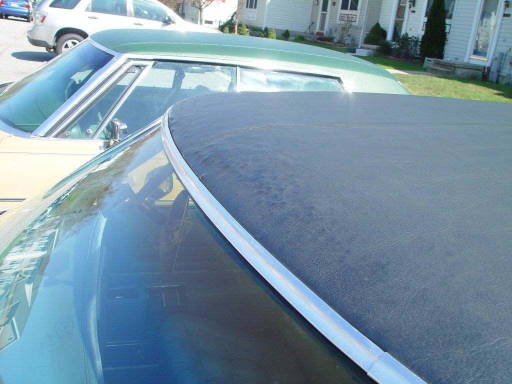

I just copied pictures off that site a couple of days ago to reference how the Formal vinyl is suppose to look like for SMS Autofabrics. They requested pictures of my vinyl top but I had to explain several times that my top is an aftermarket hack job that wasn't constructed with the correct seams or fabric/pattern. The former top had one sewn seam down the middle. LOL!
Before there was FCBO, all my Formal help came from the old New Yorker Online Group. There were several guys that knew these cars inside and out. There was nothing you could throw at them that someone didn't know.
And that's where I met Mr C's friend Kip Gardner. Kip could always bail my sorry *** out when going up to Nigel's and pulling parts in the middle of winter.
Funny how none of the old Group came over here.
I came over.
I've seen this screw up a lot...probably because the Crown Coupe/ St Regis top did have the seam in the middle and the top manufacturers never thought there'd be a difference between the Coupe and the 2 dr/ 4 dr hardtop.
The reason for two seams (3pcs) was to reduce waste from the 52" wide bolts of vinyl when stamping out the cuts. Three sections produced less leftover scrap material from two pcs.
As told to me by an Engineer on a plant tour.

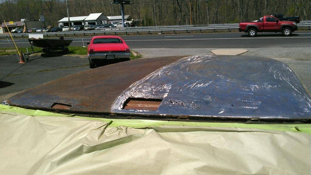

That is a picture of the front of the roof line if you can't tell. Not looking too bad so far.
Not as bad as thought. I was picturing the glass channel all rotted out requiring fancy fabrication, bending, stretching, and whatnot.
You are pulling the headliner, right?
Not as bad as thought. I was picturing the glass chanel all rotted out requiring fancy fabrication, bending, stretching, and whatnot.
The window channel for the windshield and the rear window are both rock solid and not requiring any repair. Lucky me for sure!
