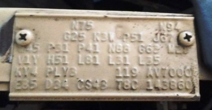

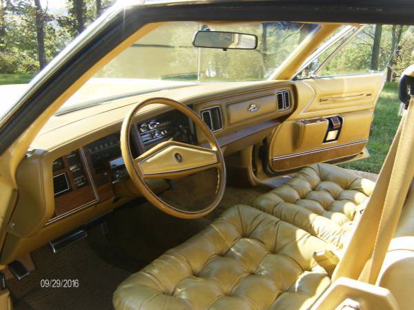

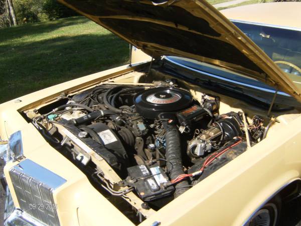

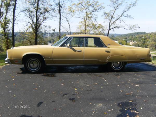

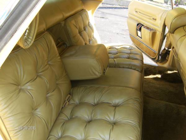

They are older photos. I will have to create a garage for the site when the weather is nice for photos, also the hose is stored for the winter...
Thanks. The Lean Burn works as long as the temps do not go much above 70F. Planning on an Edlebrock upgrade for dependable hot summer drive-ability. Plus the ThermoQuad is leaking gas from the bowl.
Very typical on both counts, even when these cars were new.
