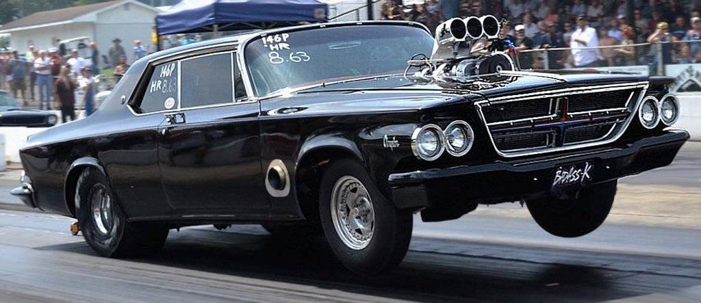

My 64 New Yorker has a 383 that I just pulled. I would like to drop in a 440 and stroke it up. Understandably it will take money and time, but I wanted to hear what you guys thought. The typical first response when someone wants to customize their car is, "What do you want your car to be", except this is obviously a cruising car, not a dragster. That being said, I guess ultimately what I am asking is, if I am looking for more oomf, torque, horsepower out of my car, is it worth switching to the 440 or should I stroke out my 383?
I know it sounds crazy and stupid, but I have this custom vision of my black beauty with a 440 in it, B&M/TCI tranny, updated rear gear and a supercharger. What?? WHY??...Moron...After reviewing several threads, I know the drill, but can it be done?
I like the look of a roots style blower and wanted the professional's opinions. No I don't want to take it to the track, but I would like to get as much out of it as a street car as possible and have that "look". Be kind, leave a little meat on my bones so that my wife will recognize me.
