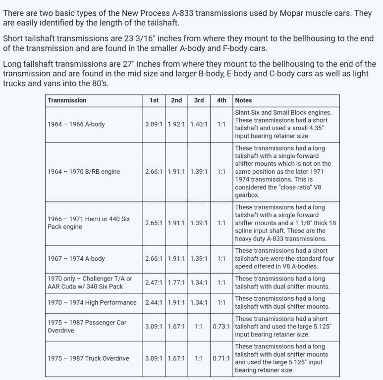

Here's what I'm looking to know, what are the exact differences between the B body and C body unit?
I'm really having a hankering to cut a hole in a trans hump.
Nick
A, B body only trans 69 and earlier will fit or is the same as a C body. The B&E body 70 up trans will also work, difference being the 70 up tailshaft housing has a bolt flange at the rear for E & 71 up B body mounted shifters, you will use the front mount. The later transmissions have a better lock out mechanism, keeping you out of 2 gears at once. 64 has the ball and trunnion flange at the rear(leave these for resto guys).
A body has shifter bolt flange in the middle of a shorter tailshaft FYI
Chrysler A-833 four speed manual transmissions — history, tech, and swap
@'69FuryIIIConvertible The trans on the last line on Stan's chart is the trans I have in my '68 Charger. It won't win any drag races but it is a absolute blast to drive and with 3.23/3.55 rear gear 75-80 mph mid 2k cruising is unbeatable.

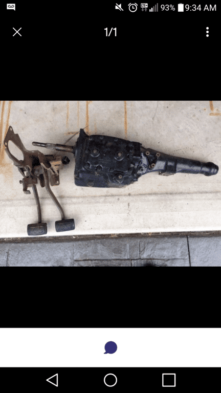

I assumed I would be doing some fabrication. It know where a set of 67 pedals from a power brake car are.
I also found this locally...which sparked the initial interest...

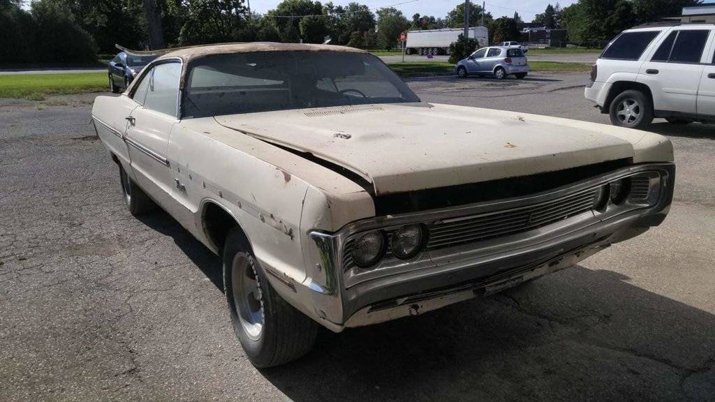

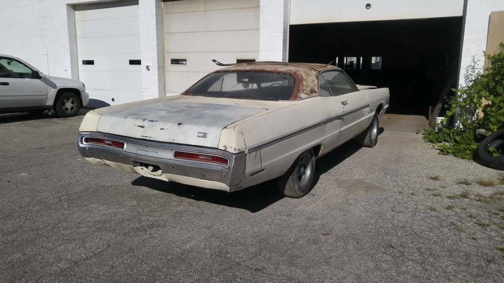

I just sold my 426 Hemi so I have some cash burning a hole in my pocket. I'm using my proceeds to purchase the 70 Fury and that will leave me enough to buy this 4spd..
My basic plan is this, the below car, GT clone, mild 440, 4 gear...
View attachment 218392 View attachment 218394
I've wanted to do a 4 gear C body for a while, I just needed a good C Body roller for it...opportunity presented itself.
Stan what did you use for pedals?
I will be following, looks like a great project. How did I miss you having a 426 Hemi? I understand selling it to finance this, but a Hemi in this ride with a 4 speed....:rolleyes: Makes you wonder doesn't it.
