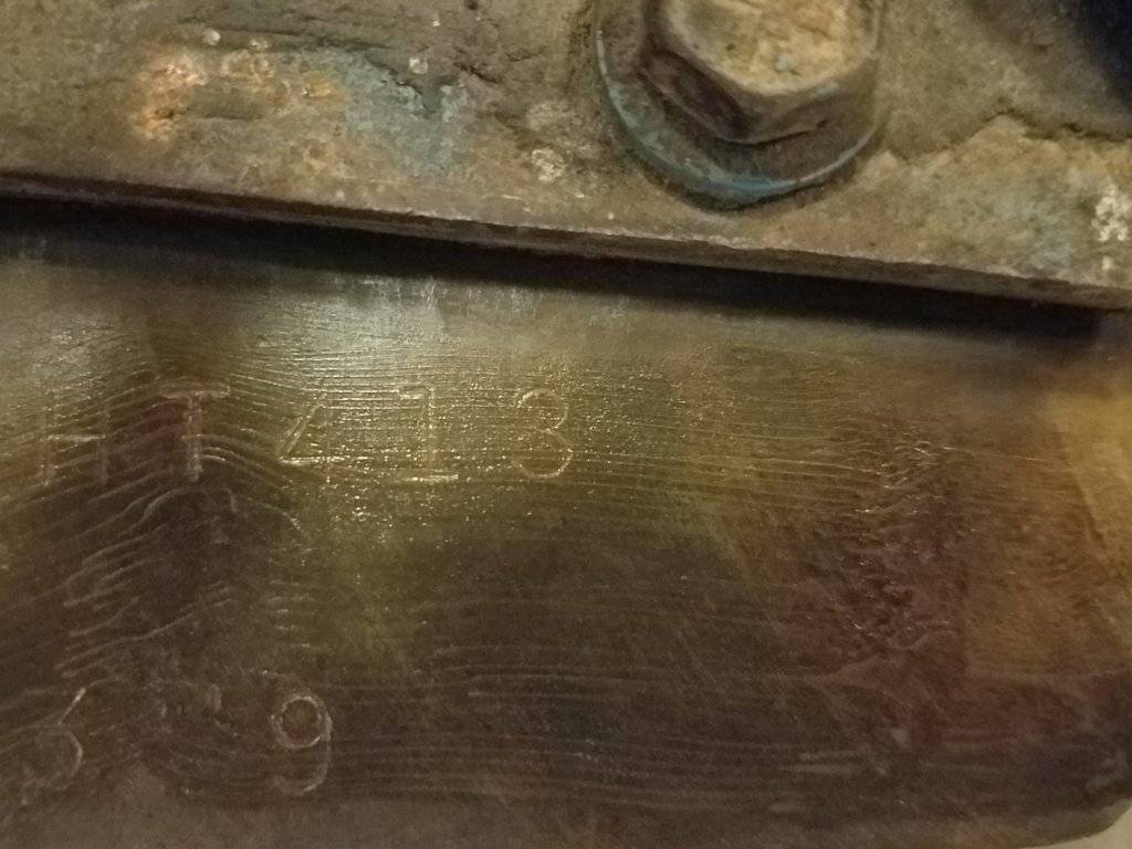

When this came up locally I did some googling and found same information about 413's being available in trucks until late 70"s. I did not know this. If anybody interested, I can provide information. City of Winnipeg & Vema Equipment | ASSOCIATED AUTO AUCTION LTD

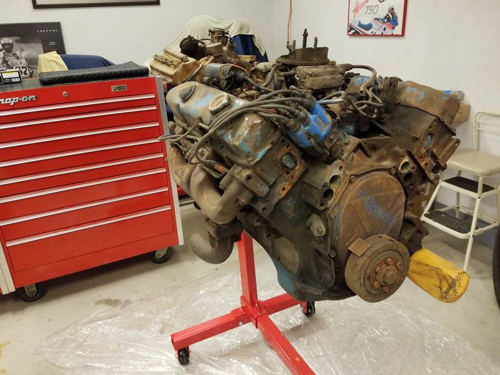

I just got a 413 given to me. Its out of a motorhome. My questions are: it is worth rebuilding seeing it's a RV engine, I have a set of 906 heads I would use in place of the RV heads. Are there any issues concerning block water jackets for the heads, crankshaft flanges for the torque converter bolts or any other issues that would make me look elsewhere for a core engine? Attached is a picture of the distributor pad. If I'm correct it's a 1972?

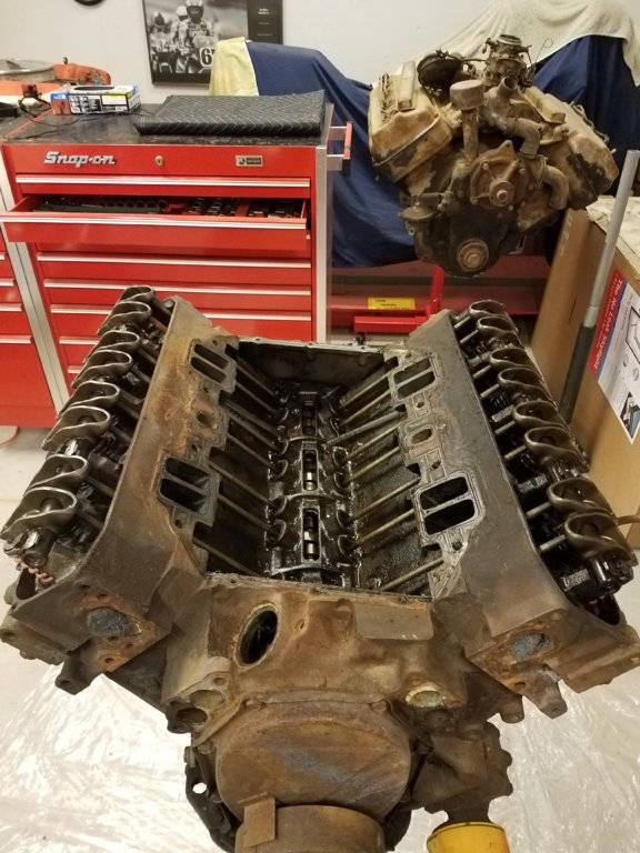

Update:

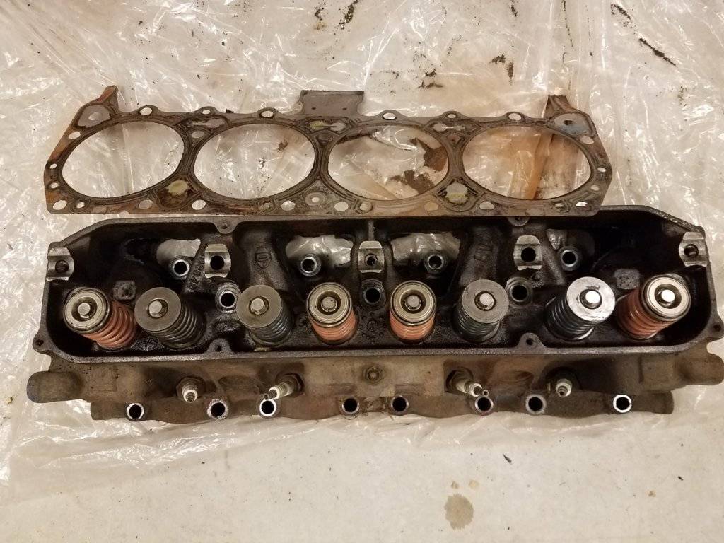

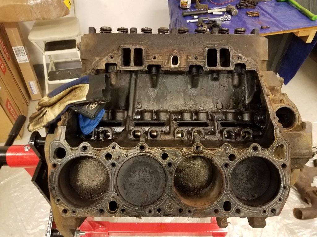

Started the disassembly. So far its it's coming b.c apart pretty well. The drivers side exhaust manifold bolt heads are rusted and eroded, gonna fire up the gas wrench to get them out. Pulled the right head off the cyl. bore looks good. Dished pistons for low(er) compression. Those heads are definitely unique in the RB world!! Stay tuned....
