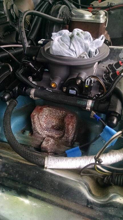

Got the Terminator TB on and noticed they changed the cross over tube to the fuel rails. Dose not look like anything in the pics. No allowances for expansion or contraction standard gates fuel hose, possible fire hazzard. Not happy!!
