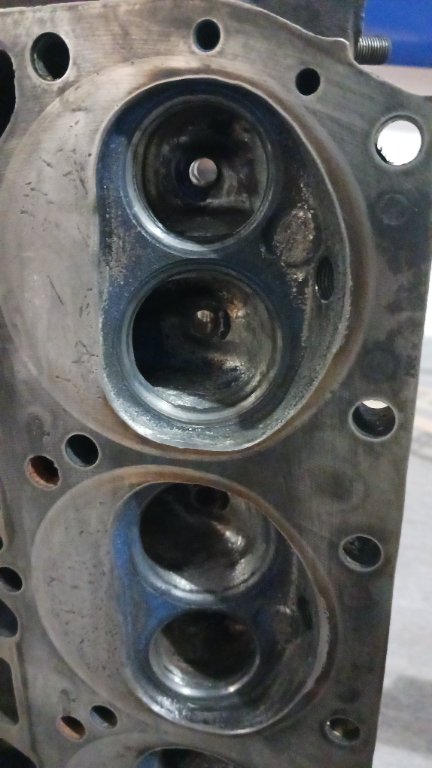

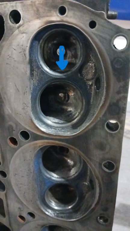

How close to the water jacket are you with that port?

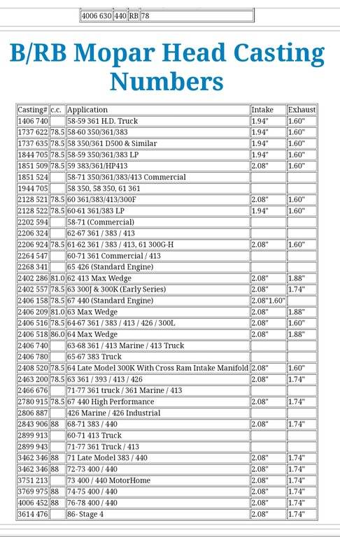

Here's a list of R/RB cylinder heads. It provides info on valve sized etc. It gives the comparison of your 516 heads to all the others. Good luck with your project.
I don't know, I didn't grind the snot outta them if that's what you want to know? I just did enough to clean and smooth out the port, nothing more. No gasket matching, etc. just a simple clean up.

If you have seat recession them its a no brainer to fit a 1.74 and a mild 'pocket port'.
As the ancient mariner said '' water, water everywhere, waiting to break through''
So the area next to the valve, where there is a pronounced bulge, 'BE VERY CAREFUL'...:mad:
Broken through here on many occasions and all that work and time is LOST forever...:mob:
