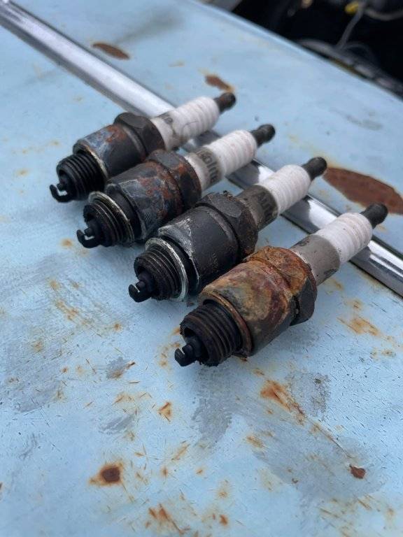

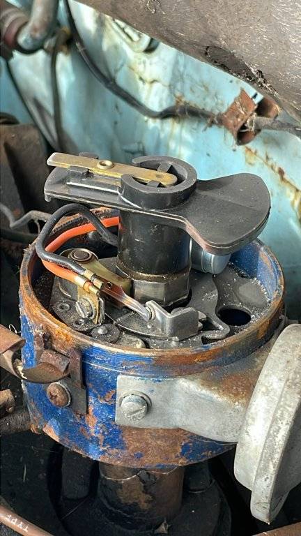

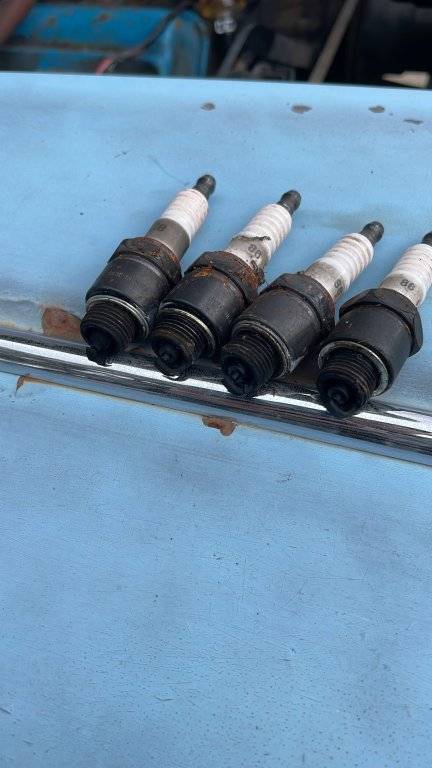

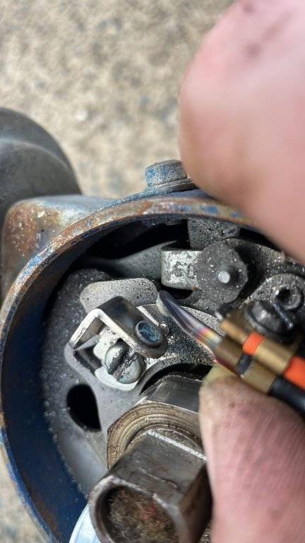

Here are two videos I took of my 57 running. I was out of money at that moment so I could not afford any new tune-up parts. What I did was wash the spark plugs with carb cleaner and brush them off, then used a file to clean up the points as they looked pretty bad. I had a spare used ignition coil so I swapped that on as well and the car ran great. The generator even charges!

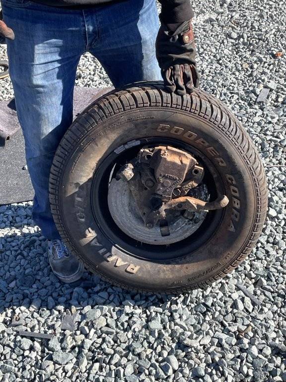

After that, I went to a local junkyard and pulled disc brake components from a wrecked 1973 Dodge Coronet that I will swap onto my 57 to give it disc brakes.
Is there a list that says these will work? I have seen F,J,M spindles (Volare',NY etc.) installed. See James Rawa's (Fury Jim) Album on Face Book for instructions and a video.
I did the disc swap using the F, J, M spindles about 20 years ago on a 58 Plymouth. I'm not sure which they came from since they were already removed when I got them from the wrecking yard. It was easy enough. I don't know if the spindles on a B body will work.
The suspension on the 73 Coronet was similar in design to the 57, so I think it will work. If not I have another set of spindles I can try. Dylan McCool on YouTube did a similar swap on his 58 Plymouth from a 5th Avenue.
A 5th Ave is not the same as a Coronet.
This article claims that the B body spindle is the same as what came in the FMJ body cars.
"There's a fierce debate going on about the so-called B-Body spindle. This one spindle is actually used in all '73-and-up B-, F-, J-, M- and R-Body cars, which is a huge source for cheap disc brakes."
If this is true then my Coronet disc brakes should be the same as a 5th Avenue. I will report back whether or not they fit on my 57. Otherwise, I can use them on my Charger or something.

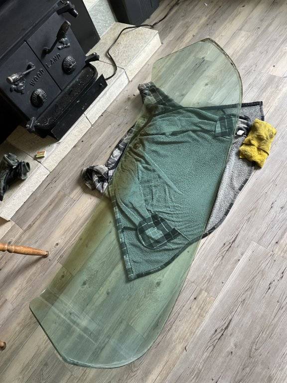

I was able to get a new (used) windshield from John at Big M to replace the broken windshield. Now John told me to clean and put the old seal in hot water, then to soak it in a bag with GoJo hand soap. He says that will restore the rubber and make it reusable, anyone done anything like this?
Yes, and it works! Use the smooth non-grit gojo. Generics at auto supply store may work also like GOOP at Harbor freight too.
I was able to fit the 73 Coronet spindles onto the 57 balljoints with no problems. They bolted together like is was made for the car. I did have to cut off the old steering stop on the strut rod, and everything fit perfectly. I rebuilt the calipers and got new rotors and pads. Then I was able to install an old dual circuit master cylinder and bent new lines down to the rear line and front distribution block. Up next is bleeding.
