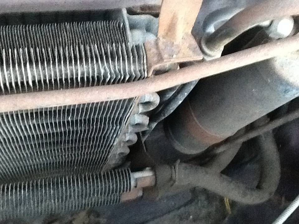

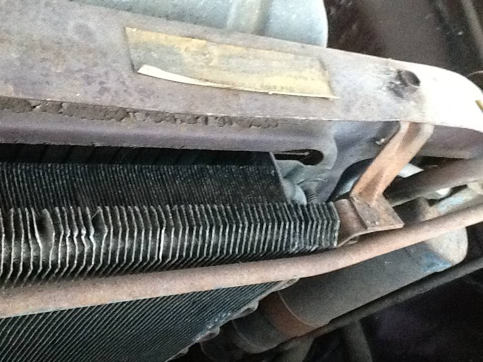

Sorry,my bad. Went out to look at parts car in the dark and noticed the 2 A/C radiators?
Thought one was a trans cooler like the auto hemi cars had.?
Traced the lines back and saw that it was connected to A/C.
Why are there 2 separate A/C radiators on a imperial?
Looks like it can be modified to make a factory fitting,looking a trans cooler?

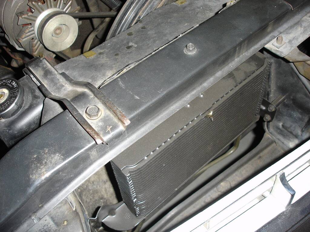

I've used A/C "radiators" in the past for tranny coolers. They work very well, but it isn't going to be a factory type installation if that is what you want.
I too would guess a rear A/C equipped car to have two of them.
Hit the pick and pulls . plenty of diffrettnt styles on truck and cars . This came off a ford truck and used it on my 65 Old's.
