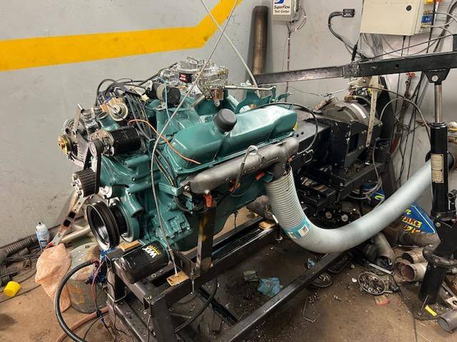

Today I had the opportunity to run my 72k original mile 66 383 - 2 barrel engine on a dyno.
A buddy of mine took it apart as far as needed to check bearings , cleanliness as well as check for potential issues.
New gaskets were installed where needed, distributor was recurved and the cam advanced 4 degrees. Timing was set in the end at 33 degrees.
The only upgrades were a performer intake and a 650 AvS2 4 barrel carb.
The engine was painted and is now ready to set back in the Newport convertible .

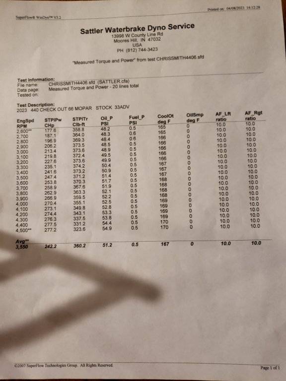

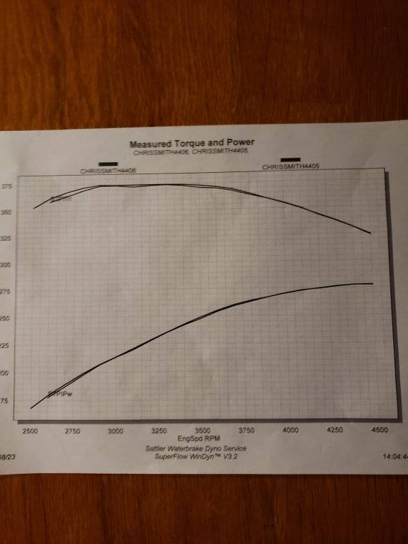

Below are the numbers we turned out today.
Looks good. Stock 516 heads? Does it still have the steel shim head gaskets, or are they composite replacements? That seems pretty bold advancing the stock 2 barrel cam, I’m sure it’s pretty small and favors low end power to begin with. It does look like it makes nice thick power down low though.
Travis..
Wow, look at that flat torque curve! So 277 HP with a 4 BBL? That’s just 7 more than what the stock 2 BBL is rated at. What do you think is going on with that? I would think with open exhaust and a 4 BBL you’d at least get to 300…
If I may ask, what did the shop charge for this service?

Stock heads and gaskets, didnt take those off , just a general cleanup of the valve rockers etc.
I wish I had thought far enough ahead to have the motor ran with the 2 barrel on it upon removal.
IMO , the 2 barrel wasnt actually putting out 270hp, and thats my opinion-we didnt get the torque numbers Chrysler was reporting for the 2 barrel version either. Im not a motor expert so maybe someone else will weigh in on what thwy think.
Iknow headers would have picked us up close to 30 hp, but I didnt want headers in the convertible, so chose to test it as it will be driven.
I was fortunate to get this done as a favor. Ive known Mike for almost 40 years and he helped me out just to see what it had...
HP is meaningless. The low rpm torque numbers at low RPM are insane.

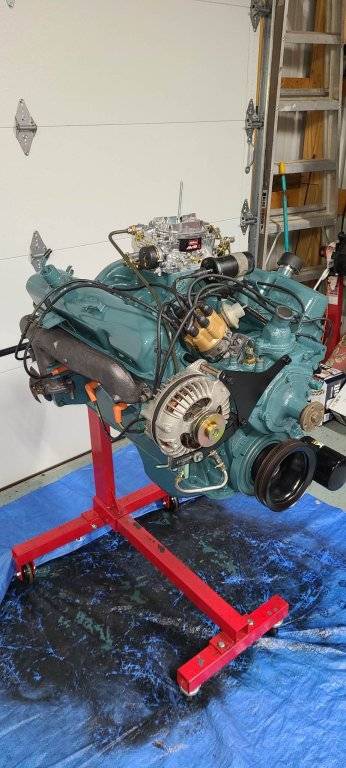

We were quite happy with the torque numbers and the curve for sure. The Newport has a factory 2.76 rearend ratio. I didnt buy this one to go light to light and the car really crusises nice at 70- 80mph. Im sure a 3.23 rear would make it a bit peppy from a light and perhaps not knock off much on the mileage at cruising speed.

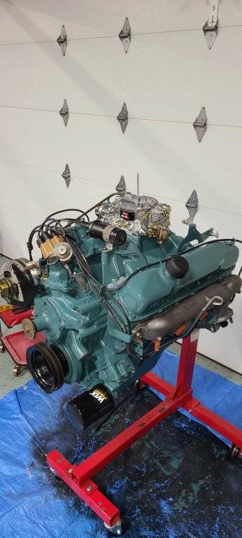

The main reason it was taken out of the car was to check it out for durability and to clean it up.
A good friend (Mopar fanatic) did the work and prepped it for the dyno.
The electric water pump was part that prep.

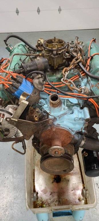

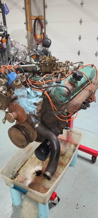

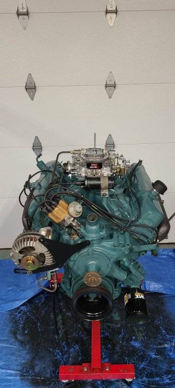

Ive included a few before and after photos. Will update as soon as i have it back in.
Replacing front end/ control arm bushings etc currently since it seemed easier with the motor out.

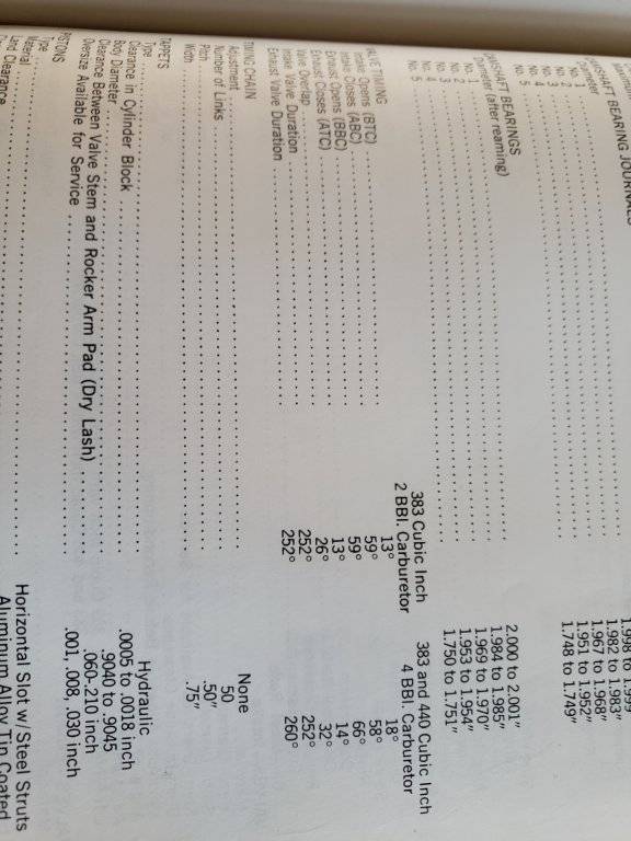

I did find some difference in the cam specs for the 2&4 barrel motors in 66. I had previously read they were the same cam, but the Chrysler service manual says differently.
