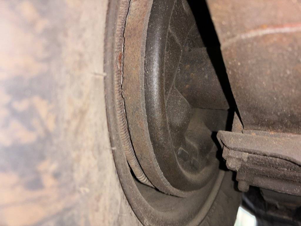

So you don't really know what front brakes you have?
You don't have to take off the wheel, you can look at the back of the brake and see. Take a photo and post it

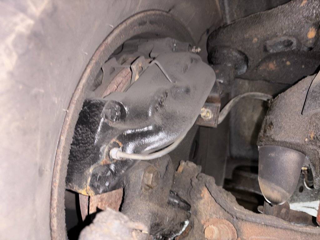

Here is what I have I think you are right brake disk in the front and drum in the back is that standard for the car ?
Disc is an option, and you have disc brakes.

Those Budd disc brakes work crazy good so hopefully they’re in good working order and all you need to do is get the proper master.
Just search for a stock replacement for any ‘67/8 disc brake equipped Chrysler/C-body or Imperial. Those use the same brakes with factory dual resevoir.

Your car has front discs and rear drums. Rare, and really good!
I can help with direction for your disc brake system. The new master cylinder you bought is not correct - you need a dual reservoir DISC brake master cylinder. If you've not installed it, you should be able to do an exchange. All the rest of the brake components can be rebuilt or replaced if required, but have them checked out first by a competant mechanic. You have an excellent braking system.
