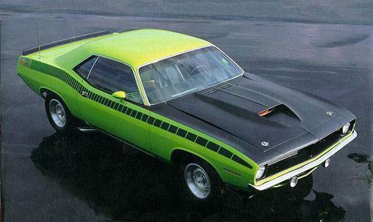

Here is some progress. The bottom picture is how I think I want to do the paint job. Black out the top and leave green on the bottom.
Spray the hood matte black and leave the rest green. it will look good that way.
I am just looking to break up the green. I love it but it is just too much.
I agree, spray the hood matte black and the top of the front fenders just like they did with the Cuda. I think it would look killer, but please don't put wheels on it like that. Why the hell people would don't that is beyond me. Fail of a perfectly nice car. I really like this hood scoop too and everything about this 66. Car looks badass! The scoop would look great on your car with the matte hood.
