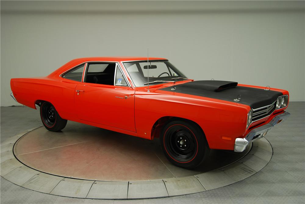

Since you've chosen a 6-pak style scoop, how about a 6-pak style paint treatment?
Already a step ahead of ya. We will be doing the hood in all matte black. After talking with the guy helping me, we have found where the previous restorer used bondo instead of welding. We might end up painting the entire car.
