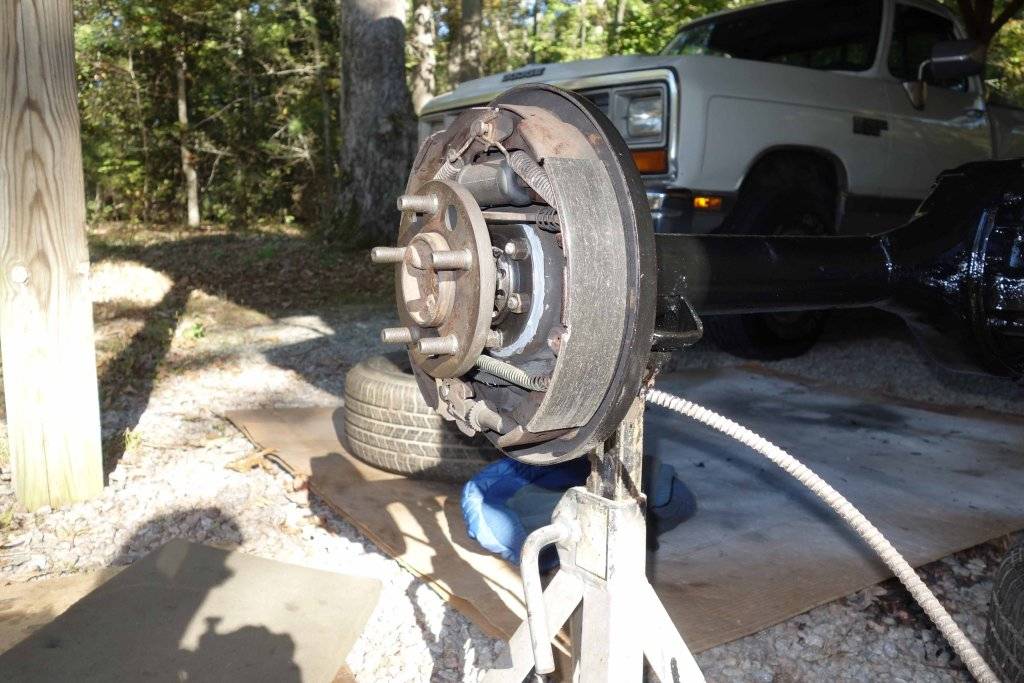

Tiny amount of right side play.....just curious as to why?
Thanks
The adjuster is on the right side shaft. 8.75 axle shafts have tapered bearings that need a little play in order to survive.
Factory is to adjust to zero end play and then back off to .008-.018 inch end play.
On 1970, it's adjusted by turning that toothed adjuster behind the axle wheel flange. A clip goes under the bottom nut to hold the toothed adjuster in place. A tiny amount of play mimics .008-.018".
