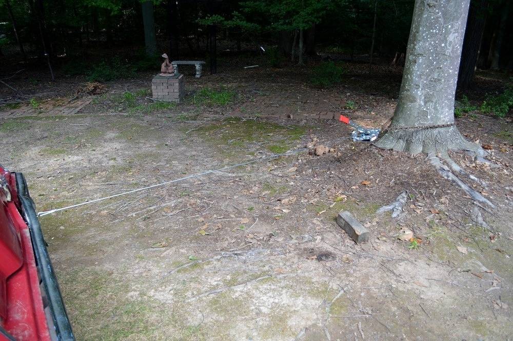

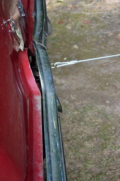

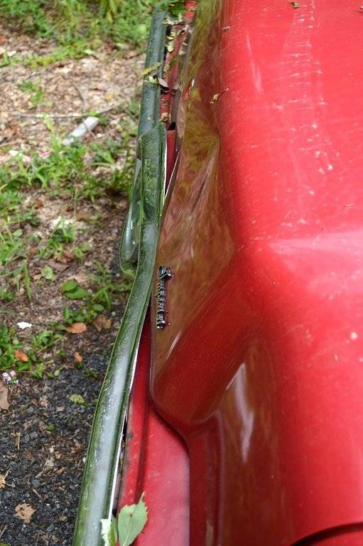

First thing I tried was pulling the rear bumper a bit. Picked up a 8000 lb come-along from Harbor Freight and hooked it between the bumper and a large tree. Pulled the top part of the bumper back a ways, but it returned mostly to where it was. It did move enough to give the trunk lid free reign to open. Unfortunately, no joy there. I can't hear any positive response in the latch when I turn the key, so it's looking more like the latch is somehow damaged internally. Trunk lid has an inch or so play up and down, it's not stuck or jammed in place.
More work to do there. The good news is, the back panel/trunk area appears to be only slightly pushed in from the impact. Nothing serious like creasing or other damage. Hopefully a simple pull once the bumpers are removed will restore it to normal.

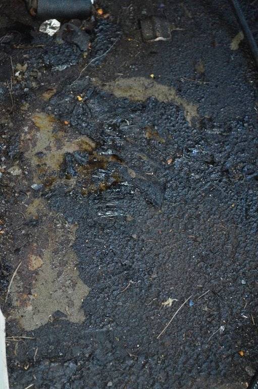

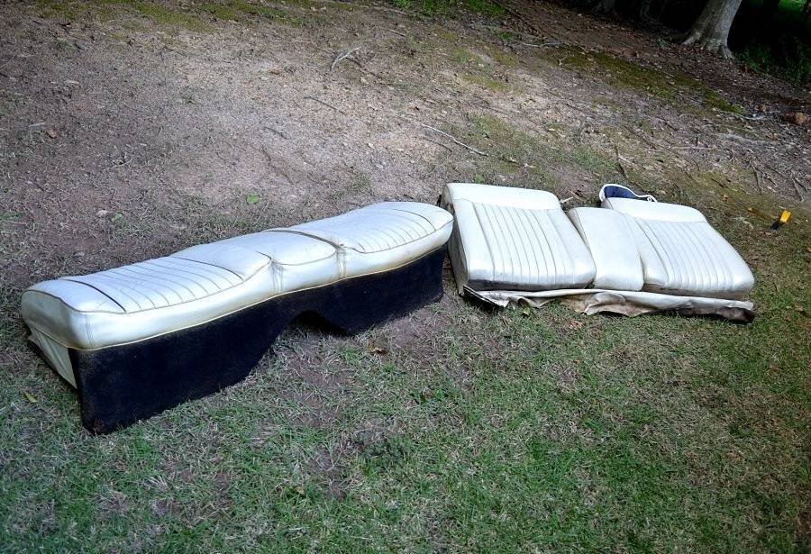

Also got the rear seat removed. The screws holding the back section in place were already removed and left on the floor beneath the seat bottom. Sure enough - there's a pretty serious fluid leak or several back there. The sound deadening material on the floor has turned to a tar-like goo, managed to step into the middle of it.
Hard to tell where the leak around the pump is. Looks like it could be the hose coupling in the rear but it felt dry back there. Wondered if the seller tried to add fluid at some point and spilled a bunch? Also suspect leakage around the cylinders. Won't know that until I get the side panels pulled. Definitely need to find a set of rear seat belts, though. Soaking in brake fluid can't do them any good.

View attachment 143023 View attachment 143024

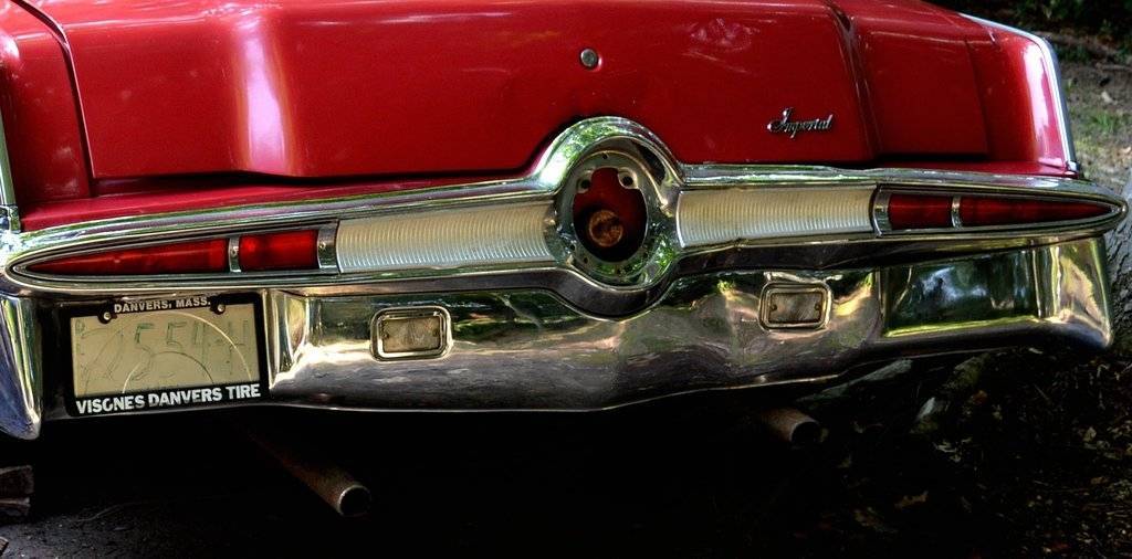

I get a little pissed every time I see yer busted up back bumper. . .
Me too, especially since it was pretty damned clean. Murray has a set with a clean top, a few dings in the bottom(actual bumper) part. Mine had zero dings and no rust. I moved on, but I still need to kick myself in the *** for that one as soon as I figure out how.
Before you buy a used bumper, why don't you call http://www.tricityplating.com/
It seems to me that buy the time you buy the bumper from Murray and get it shipped to you, you might be not too far away from getting your bumper redone. Then it won't have any dings etc.
One other thing... Can that bumper be pulled off without getting in the trunk?

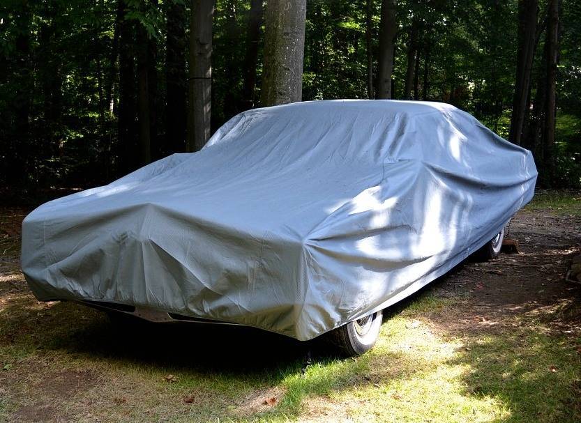

Also received the cover. Cleaned the car and got it on just before the remnants of Irma arrived this week. Got it from CarCovers.com, a decent cover but I'm not crazy about the fit. Seems a tad short in front. But overall it covers the car and keeps it dry, my main goal until the top is replaced.
More photos, including the dismembered backseat. The rest of the chrome and stainless cleaned up nicely. On to the interior next.
I don't think so, John. The lower bumper mounts are accessible from beneath but Murray said the top light bar piece has two mounts into the trunk. Somehow I'll need to get it open.
I did check the TriCity site, think it was $1100-$1200 for a replated, ready-to-go set. Not a bad price but since it wasn't in the original budget I was hoping to find a decent set for $500 or so and do the work myself to lessen the impact a bit.
The two pieces (top & bottom) Murray has are $550 before freight or driving there. Trunk lid is $475 which might force me to repair what I have since it's really not too bad.
Someone (maybe you?) mentioned previously having this bumper repaired - I have no idea how they could do that? A rosebud, hammer, & anvil? This is some seriously thick steel and it bent it enough to buckle and flake the chrome. Have never heard of a bumper of this era being straightened or repaired before. It just looks really messed up to me.
