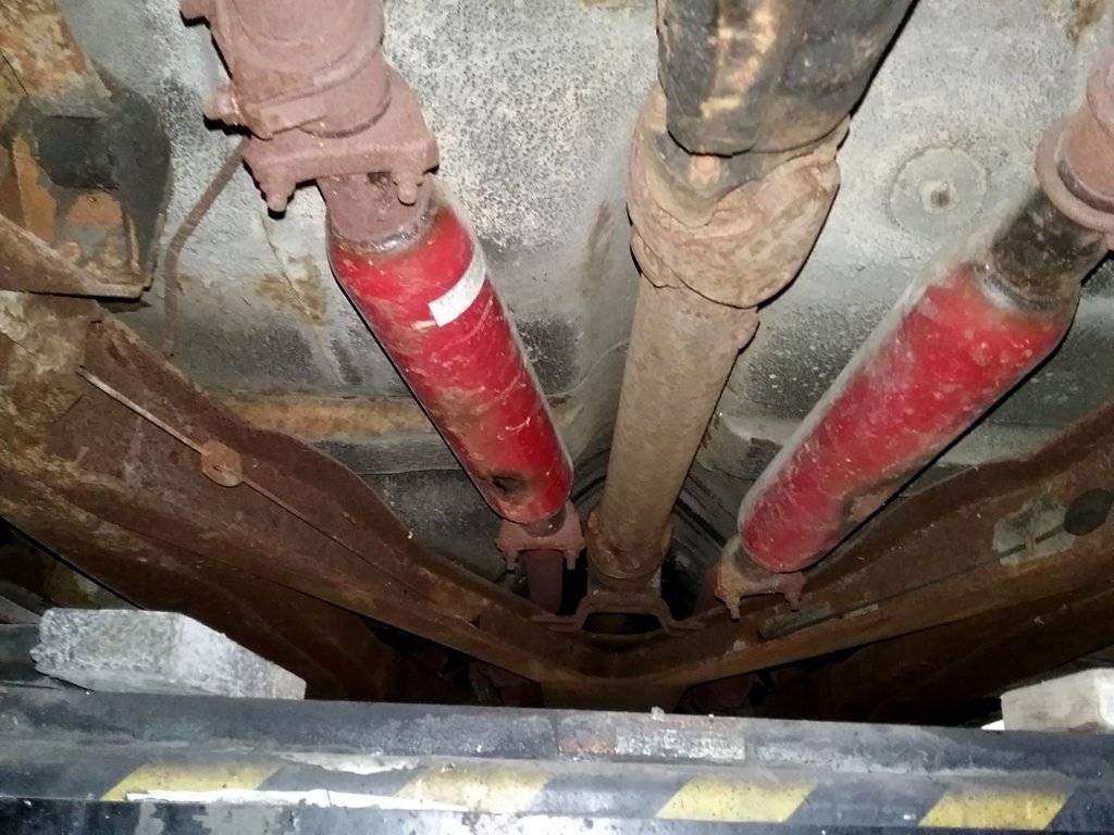

Discovered during the visit that my 80s-vintage exhaust is in need of replacement too. The Cherry Bombs are rusted through and one of the pipes is also broken. Hadn't planned on doing that yet but need to get it roadworthy.

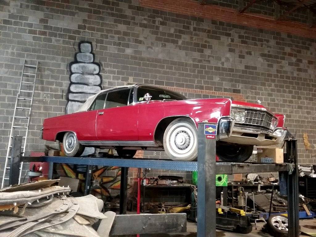

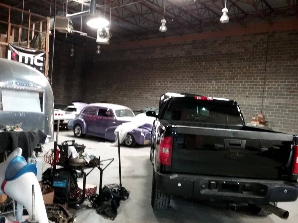

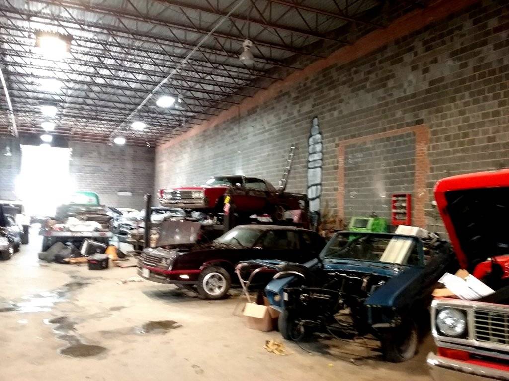

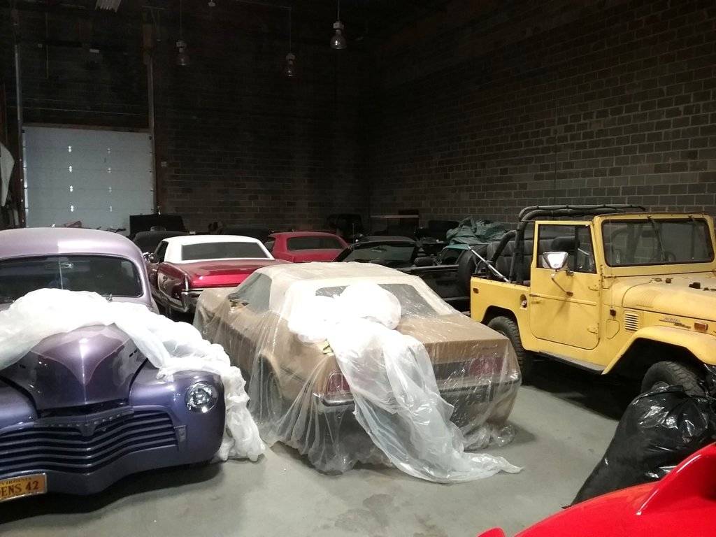

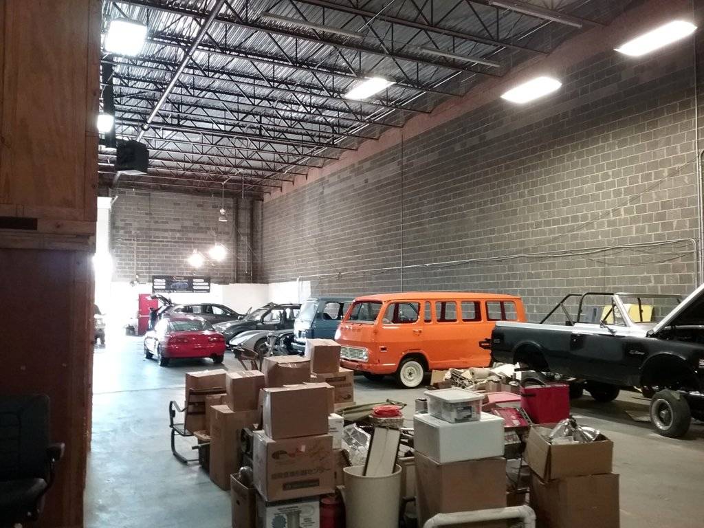

The shop is HUGE, two long warehouse-size bays with full size loading dock doors on each end, chock full of old cars, trucks, bikes. So the Imp is in good company. Been a while since I posted photos but I'll give it a try.

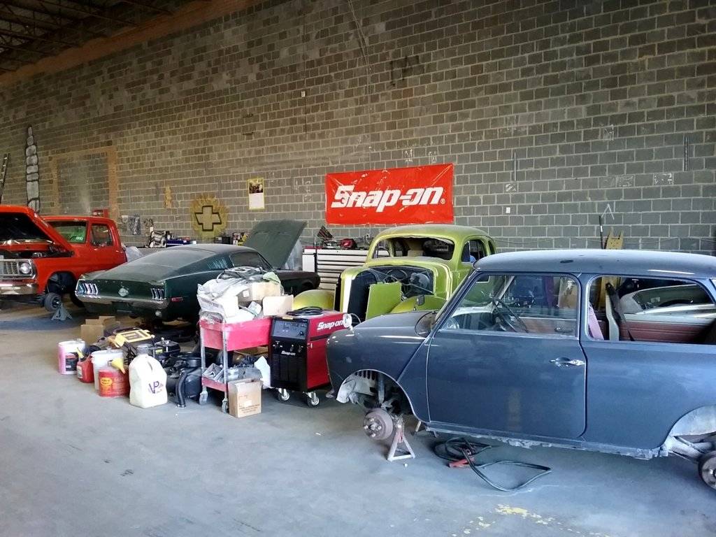

She's in good company - here are some of the other contestants she's spending time with.
I wish I'd found this guy a year ago!

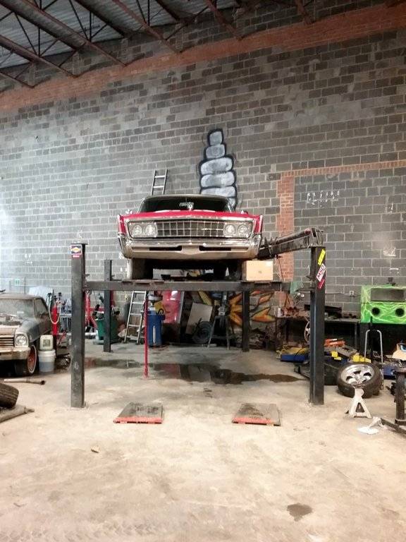

It's hard to make an Imperial look small, but that garage pulled it off! Cavernous.

The shop is in Manassas, maybe 5 miles from my house. It's in what looks to be an old trucking terminal/warehouse with several other car businesses and a moving business. Never saw it because I've only taken that street maybe twice since moving here and it's not really well marked.

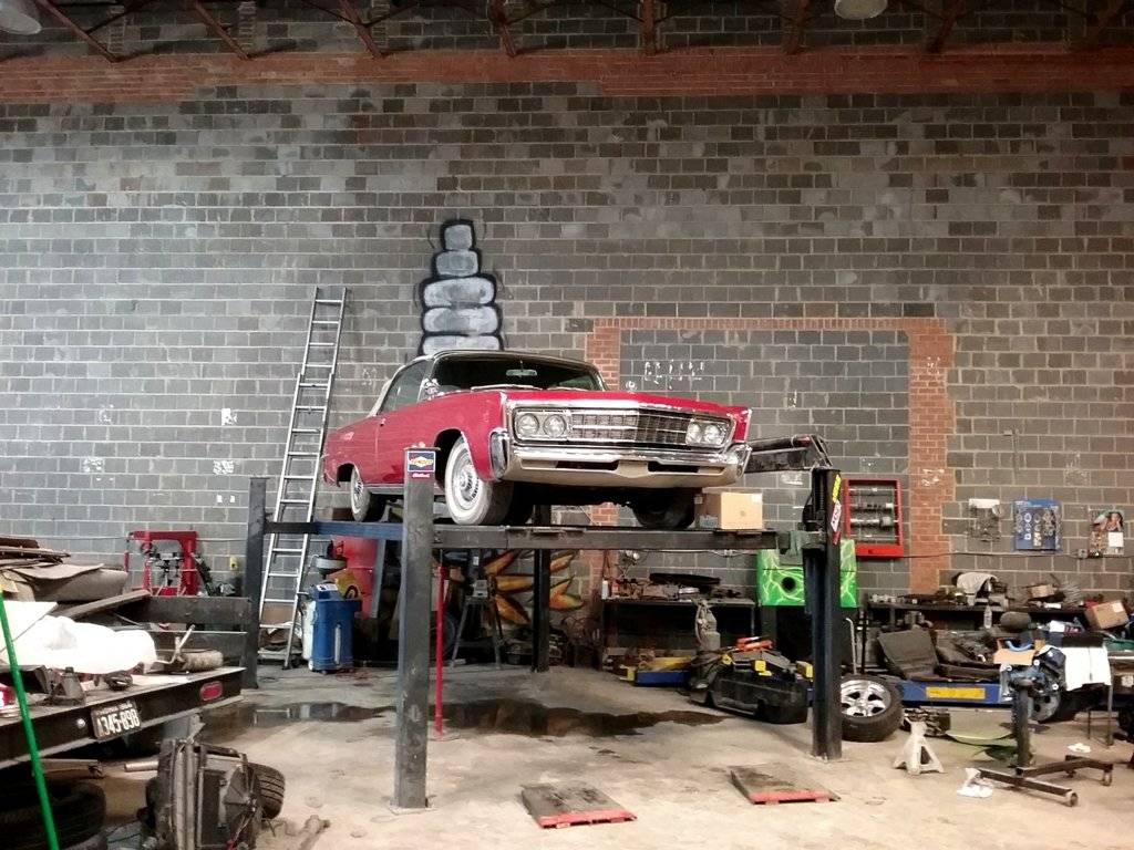

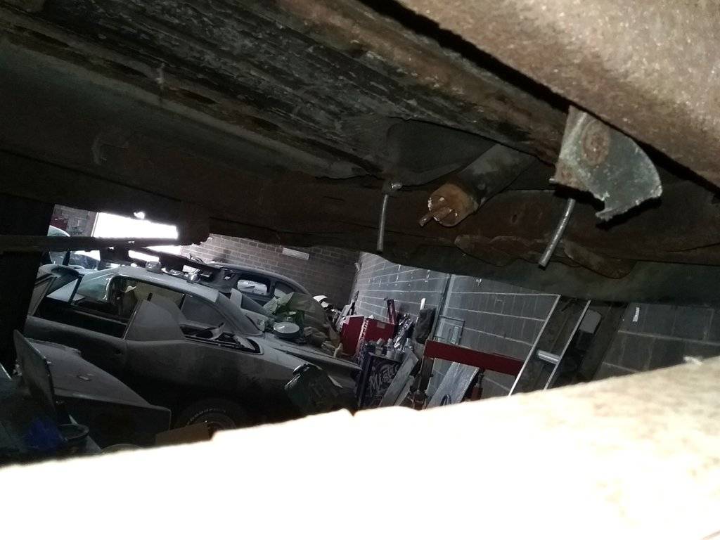

Mr C - you could park helicopters and small aircraft inside this place. I missed the best shot of the Imperial when I came through the side door, sitting up on its lift looking like it was on an island 100 feet from the door. But this guy has two bays this size and both are full of vehicles.

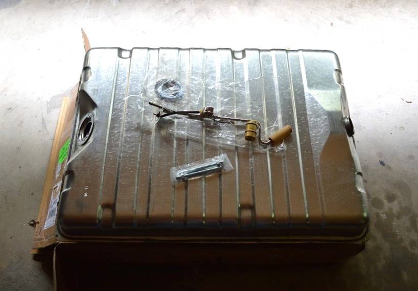

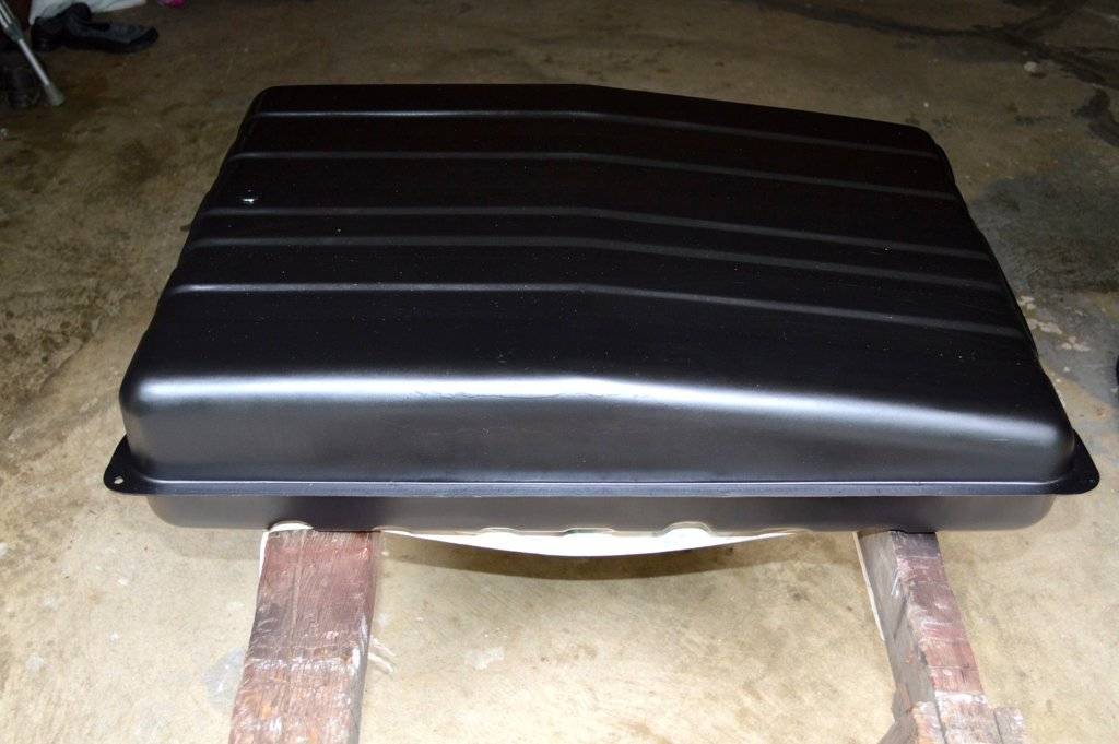

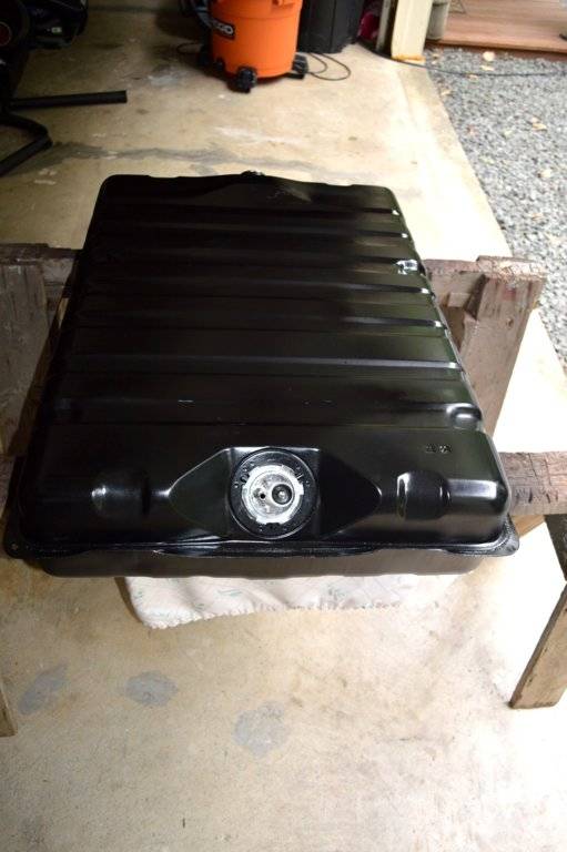

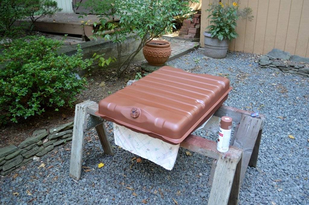

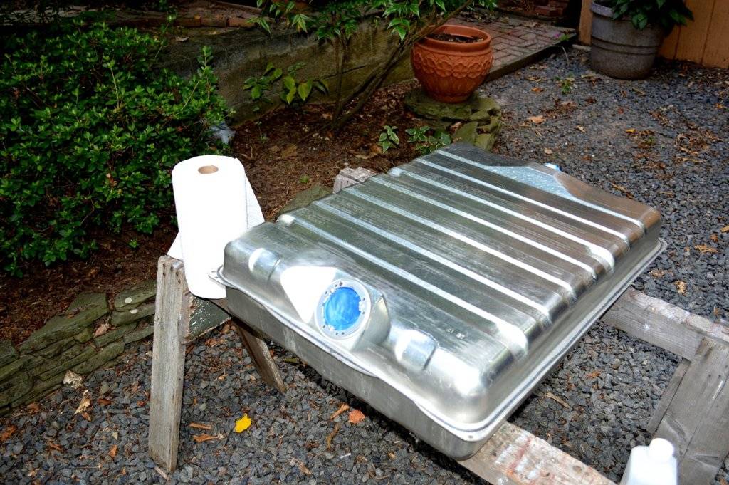

These are some shots of the replacement gas tank. The one on the car was full of crud and when I thought about the time and expense involved with getting the old tank off, having it cleaned and seal and back on, I opted to spring for a new tank from Van's. Got a sending unit at the same time and was able to locate some original locking rings as many have warned of the problems with the repops being too thin. Sure enough - placing the NOS next to the repop seemed to show the better part of a 16th inch difference. Definitely a good 32nd or more. I could feel a difference in the heft as well. Test fitting both on the new tank w/gasket and turning part way confirmed this.
Have to say, I was under the impression that the new tank was galvanized but if so, it was showing little rust spots after sitting in the garage for a few months, so I decided to paint it. Photos attached.
One curious thing came up today: I also purchased one of those rubber collar gaskets for the neck assembly, but the guy from the shop called today to tell me it doesn't fit. This is the one that looks like a big feed-thru grommet. Not sure what's up there but we'll figure it out.

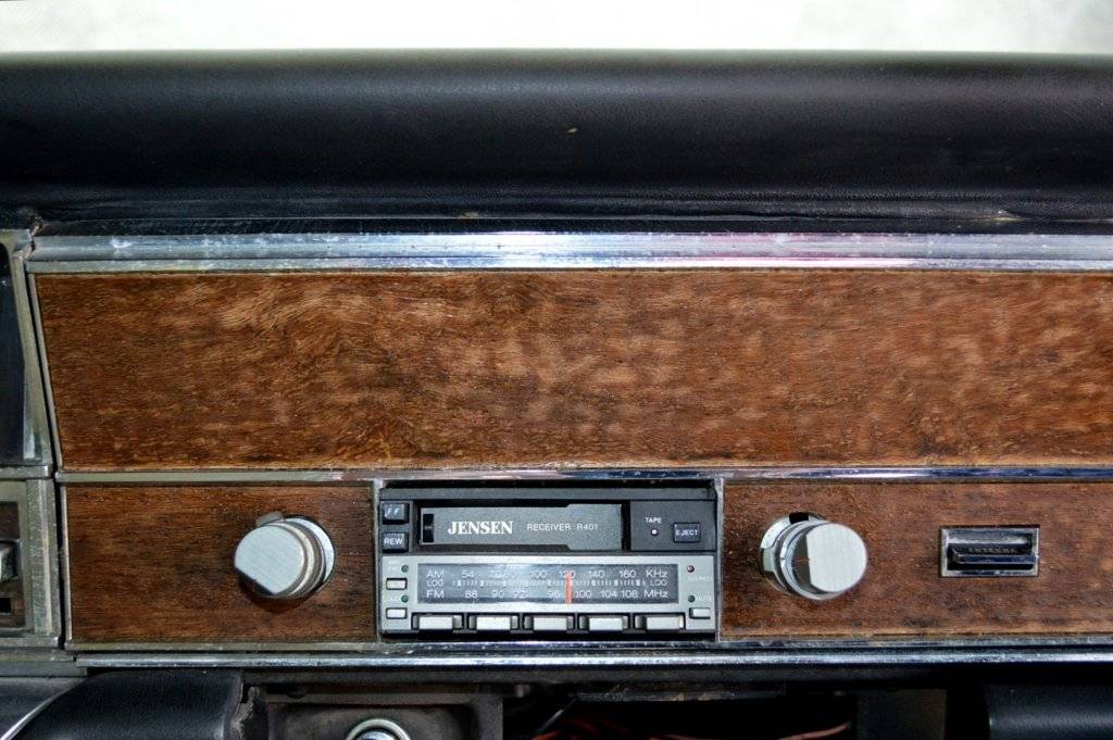

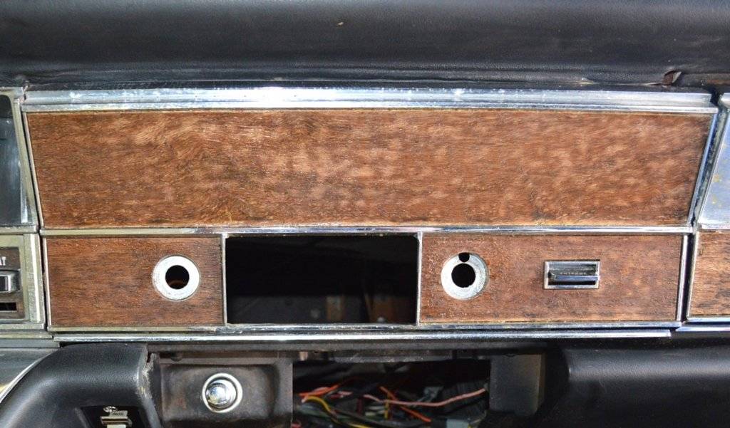

Also found some shots of the original radio that was waiting in the trunk once I got it open. Was really happy to find that it's the AM/FM auto search model #420.

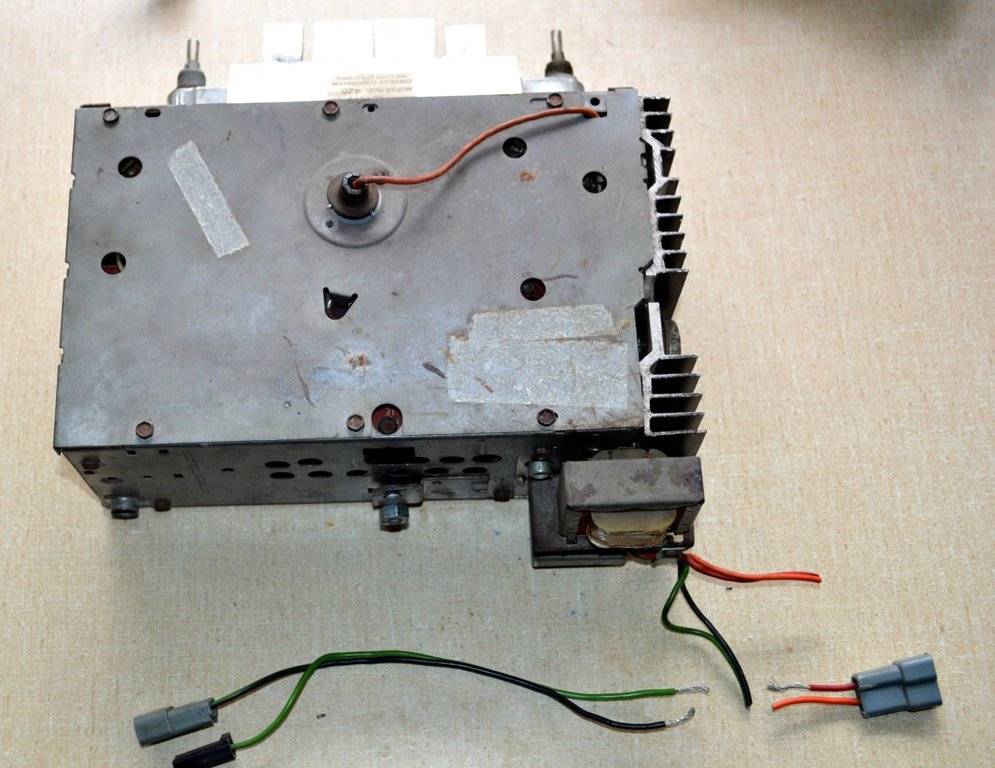

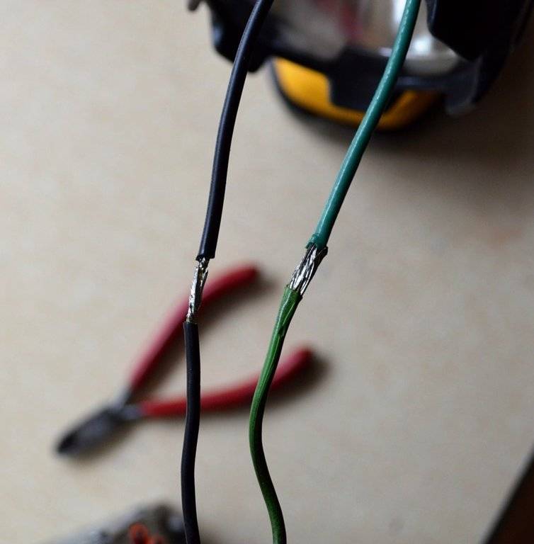

Unfortunately when the PO decided to update it with a snazzy new Jensen cassette deck and speakers, he cut the original speaker and power connectors off the back. The speaker was easy to splice - just added a short length of black and green hookup wire between the two ends, soldered and sealed with heatshrink tubing. Came out pretty well.
Power connector was a bit trickier since it was cut so close to the connector. As luck would have it, I had recently replace the bulb socket and wiring in one of the doors due to a broken/missing spring in the socket. Though the colors were exact (yellow and red vs orange and red), I went ahead and clipped the connector side off and spliced it to the radio. Added benefit - a few extra inches of wiring to make hookup and disconnecting easier.
Had the radio working great off a battery in the garage but the solenoid isn't(yet) working for the search function. Got the piston freed up so it at least works manually, will track down the rest later. It'll look great back in the dashboard.

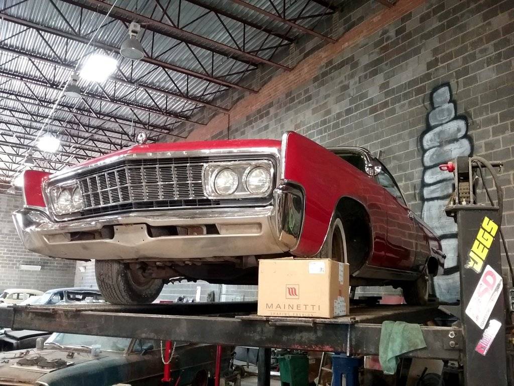

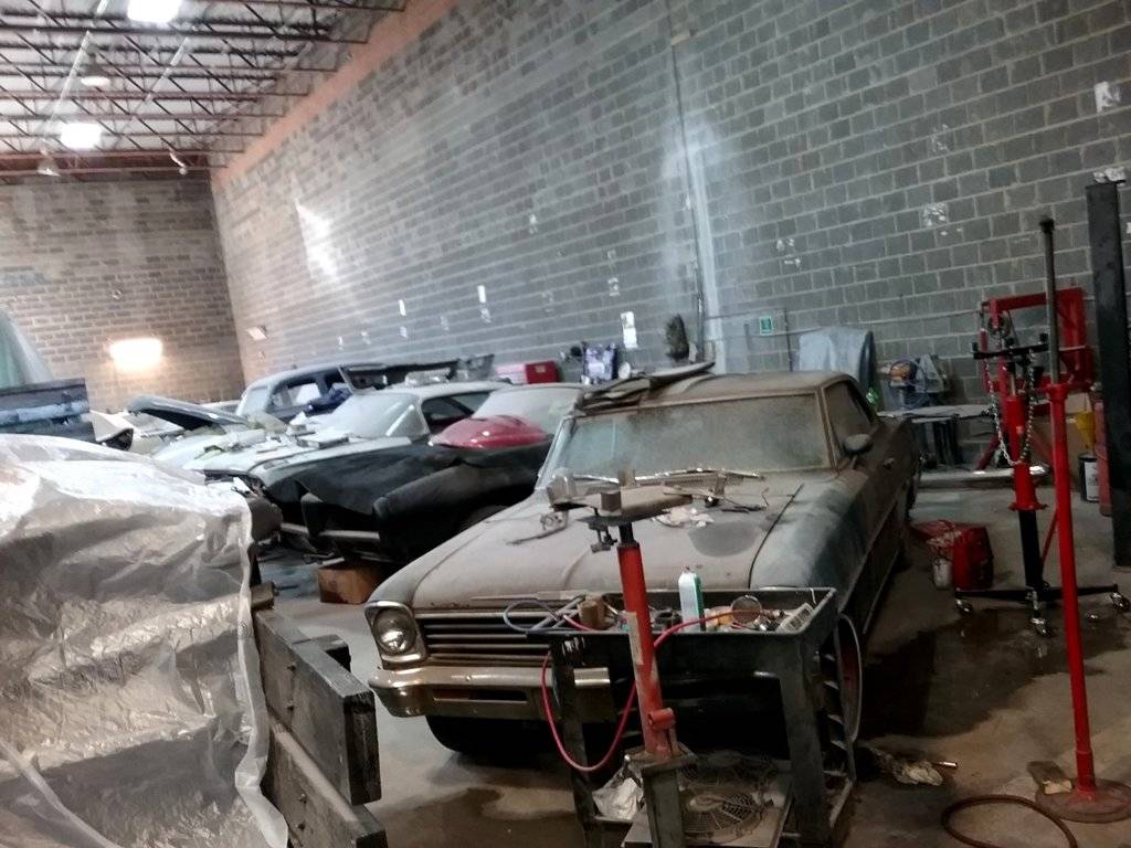

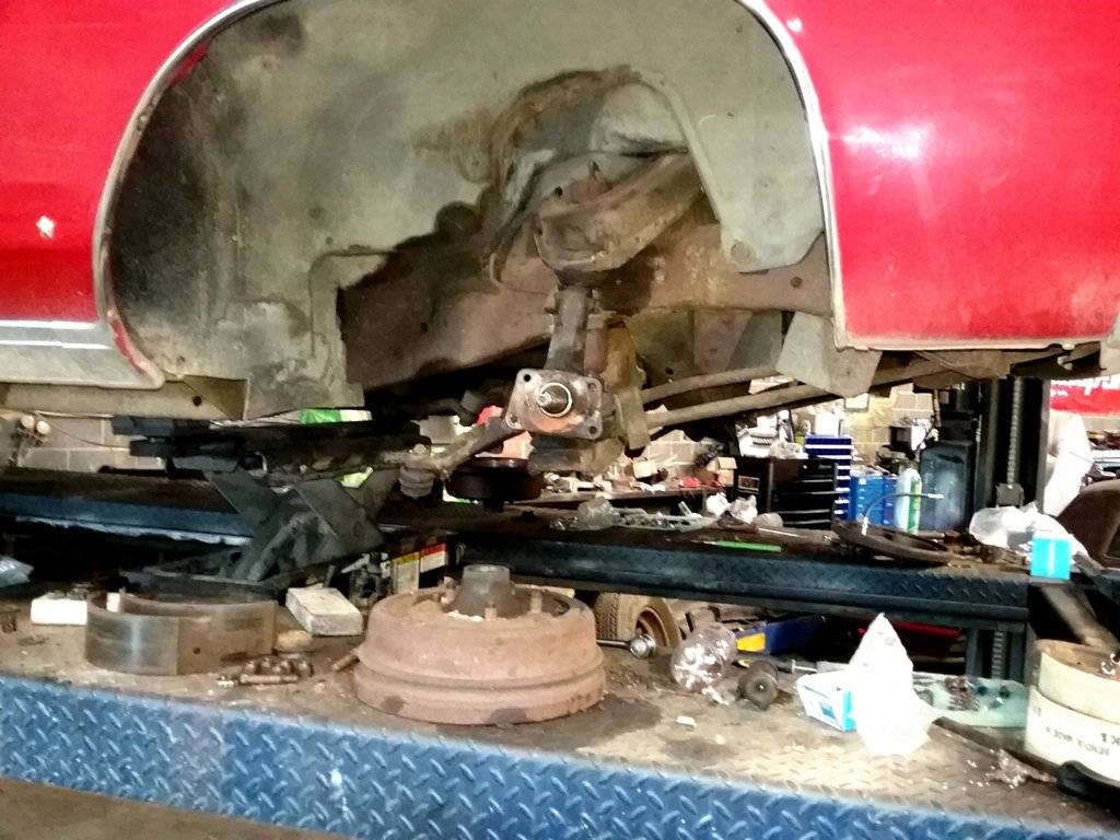

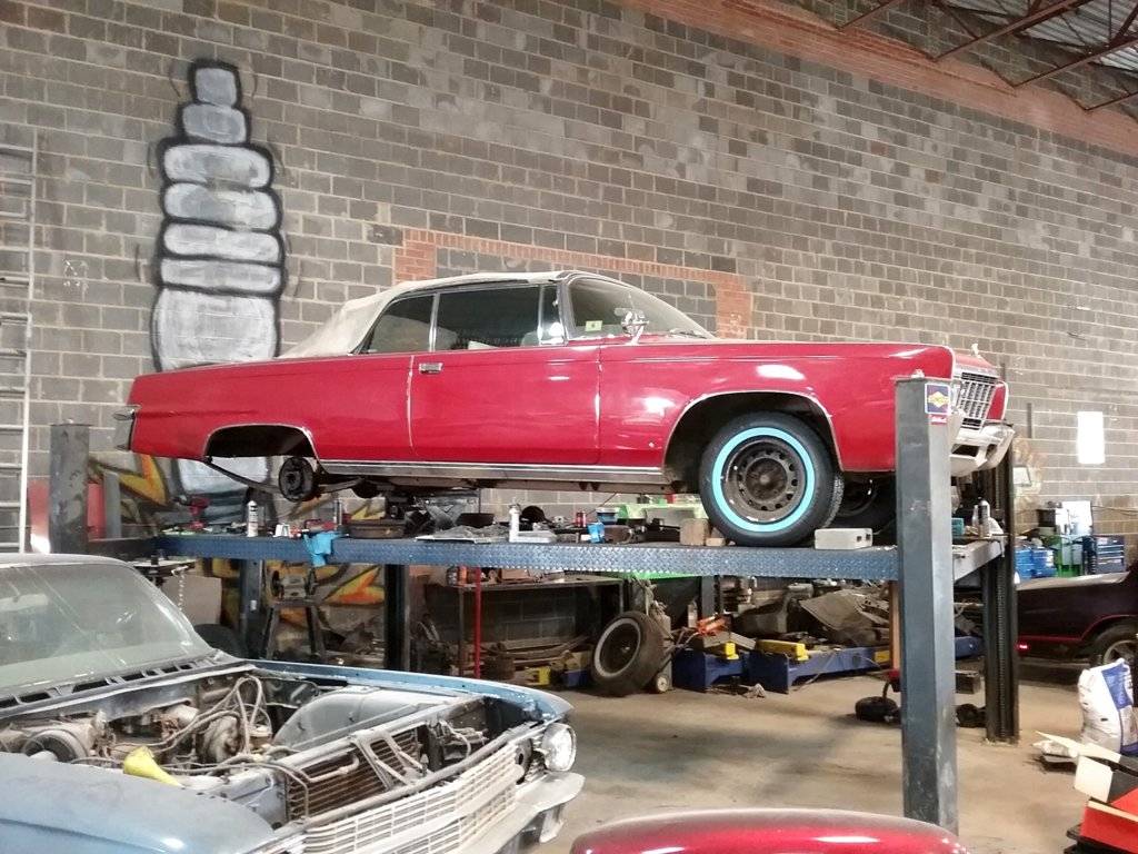

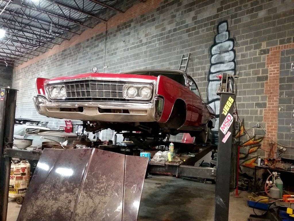

Had some errands to do this morning so I stopped in to visit the Imp again. Things are going well - front brakes are off and being rebuilt, exhaust is removed, and the gas tank is off. New shoes on the way, should have them by Friday. Looks like a kilobuck to get the exhaust done including labor, about $1200 if I want stainless. It will be new 2" pipe from the manifolds back, no silencers, and mufflers that sound good but don't drone. Will also have correct fishhook tailpipes instead of the pimped up straight chrome slide-on tips the PO added. Wasn't expecting to do the exhaust just yet but it is what it is - and the system on the car is/was trash.
The first shot is out of focus bit it gives a better idea of the size of the place.

They do everything, and if they don't, there are numerous other shops in the same building. The place is HUGE, like a giant car & hot rod incubator. I'm heading back over in a few to drop off a part, I'll ask Rob for specifics.

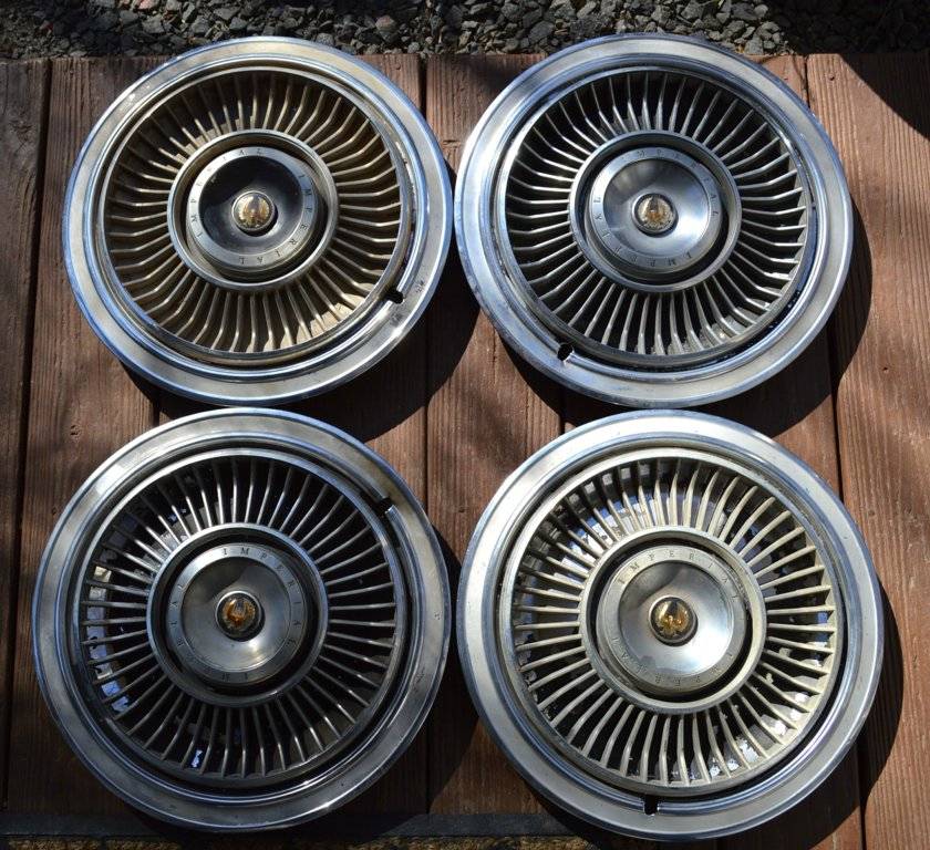

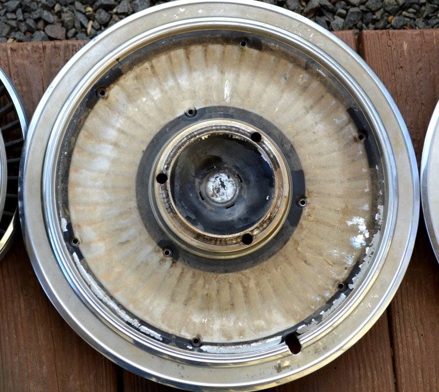

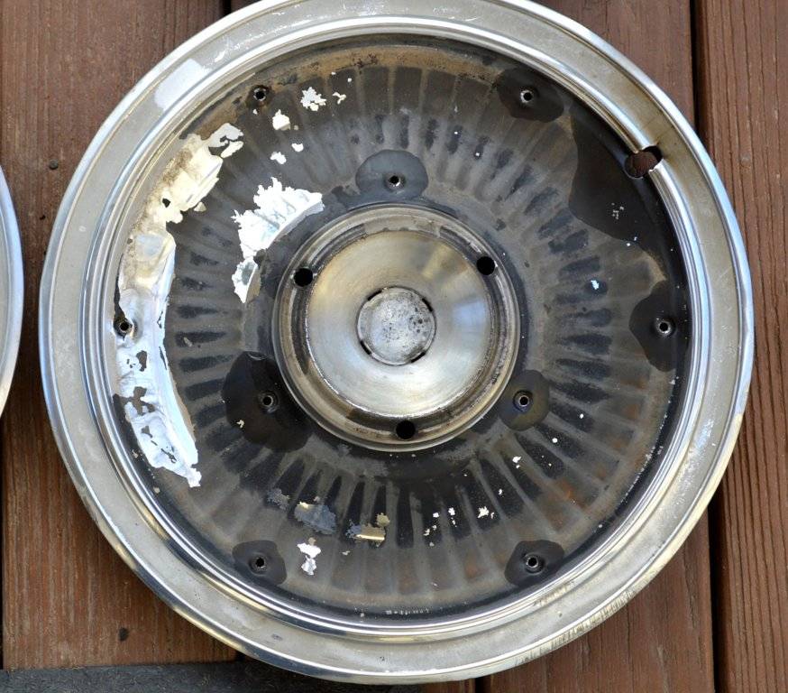

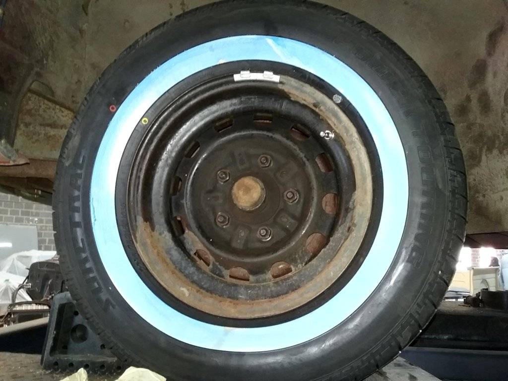

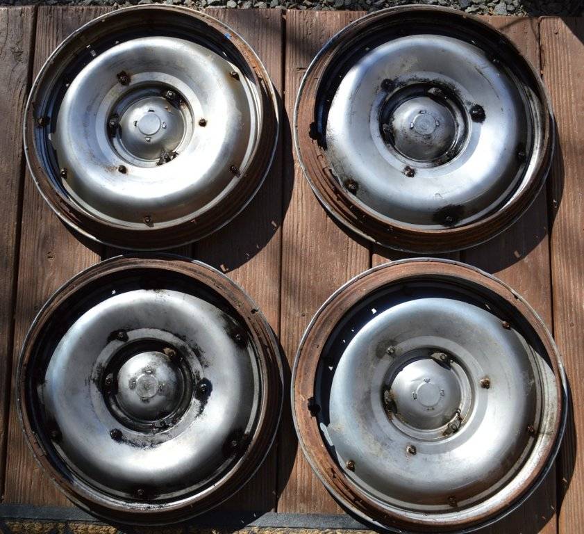

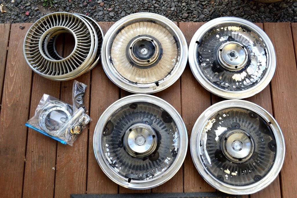

The new tires arrived Friday and were dropped off Saturday. I left explicit instructions that the aftermarket granny spoke hubcaps were not to go back on the car, bare nekkid lug nuts would look better to me. In reality, I tracked down a set of original caps last year but just haven't gotten to them yet. They need to be cleaned and repainted. Now that the project is moving forward including new tires it's probably a good time for this.
Spent yesterday taking them apart. Today was busy with other stuff but hopefully tomorrow I'll start getting the pieces cleaned and repainting started. Will be doing them black & black: black bowl as seen on three and black center as seen on one. Getting the rest of the old paint off will be the worst part. That and dealing with the chickens. While a couple of the center emblems are passable, none are great and two are downright nasty due to paint loss.

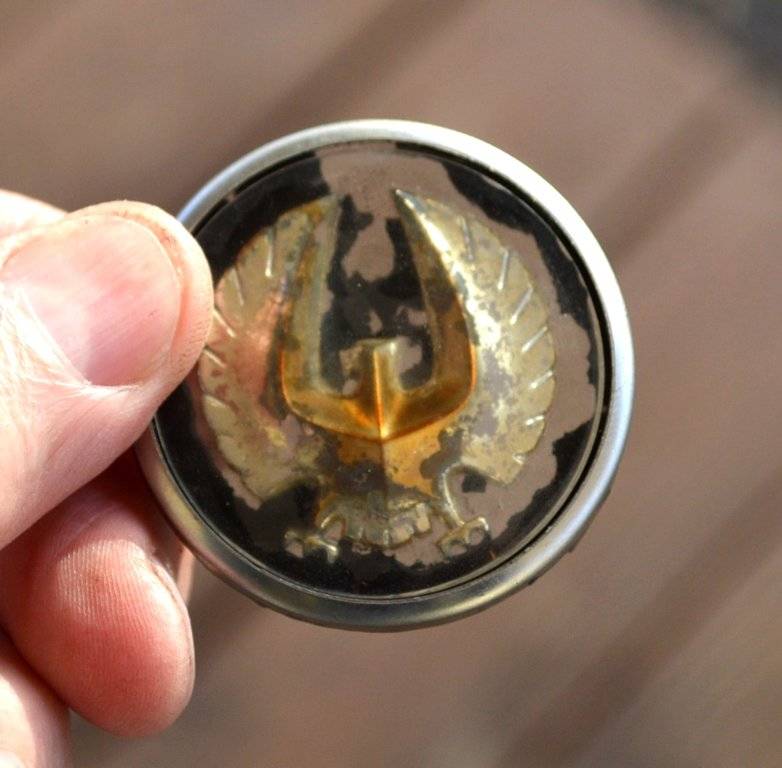

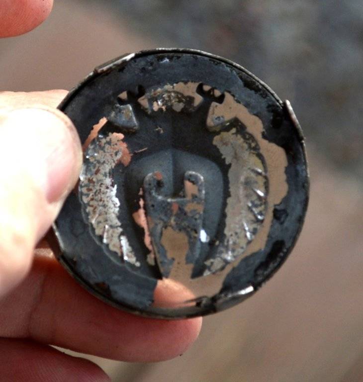

If anyone has any beater caps out there with decent chickens, I'd like to hear from you. They were used on 1964 and '66-'69 years at the very least. Maybe others as well. Not looking for Pebble Beach quality, but some paint would be nice.

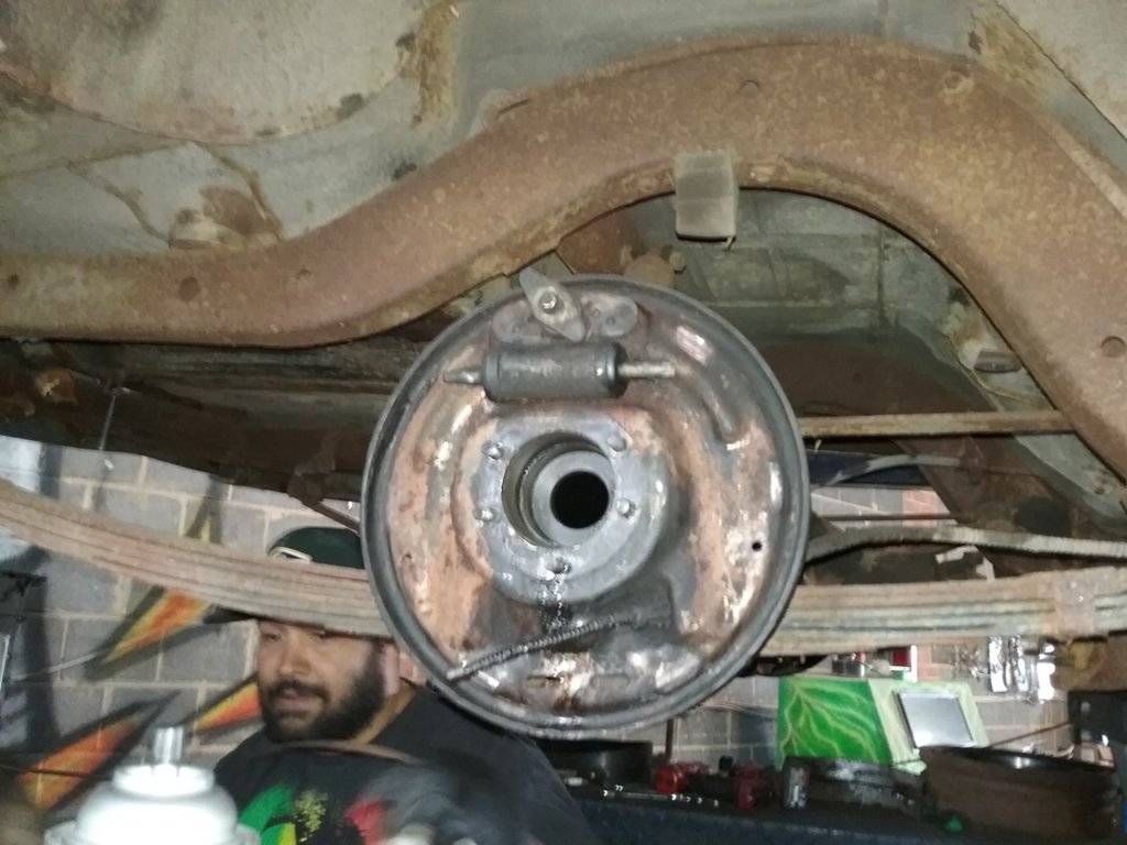

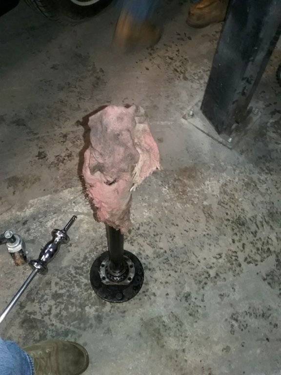

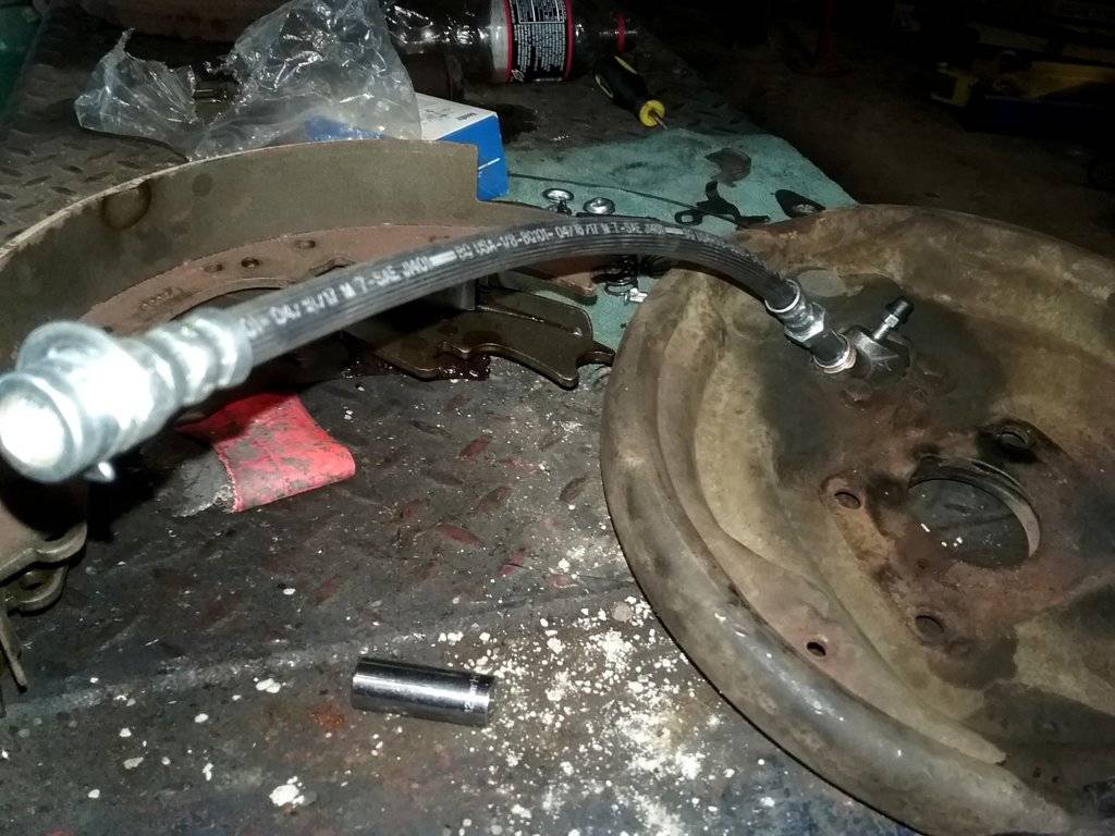

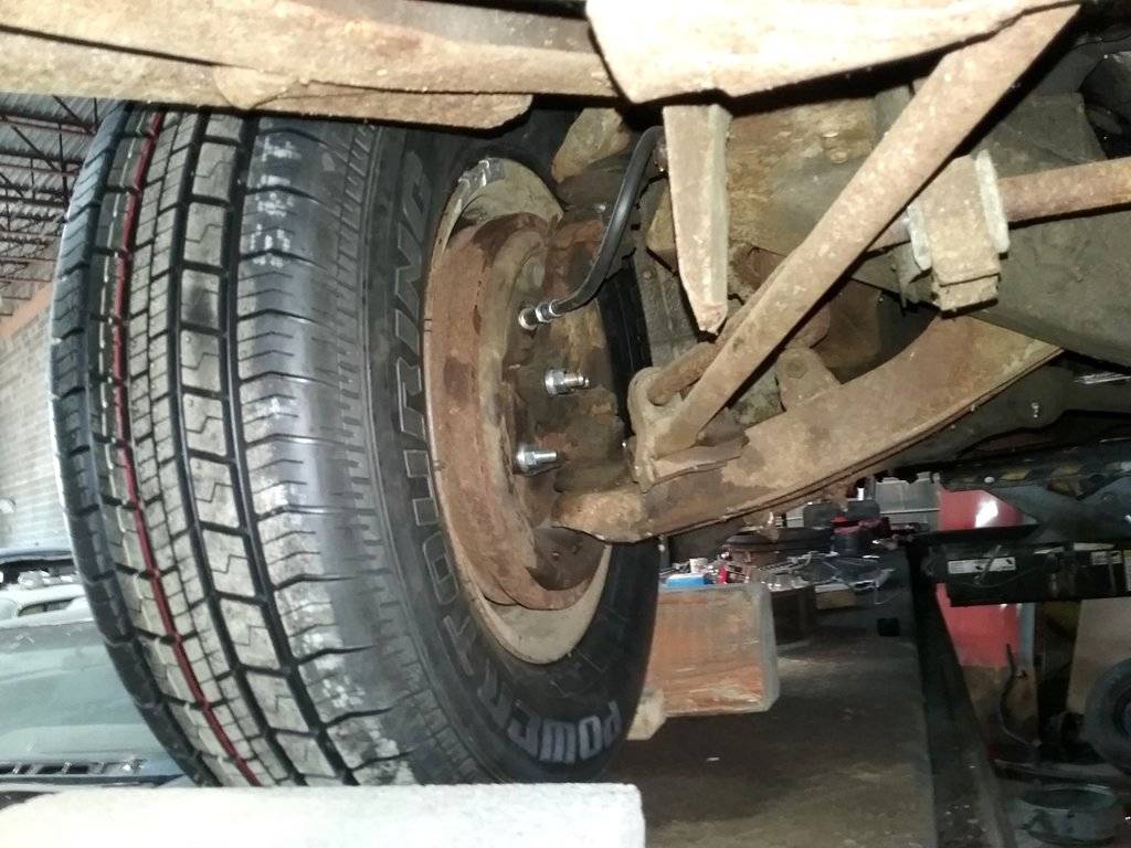

Stopped over yesterday, car was down off the lift but still awaiting the tank installation & exhaust. Brakes are all done, new tires are on, transmission has new filter & fluid. Not sure if they're done the coolant and oil changes yet.
When they pulled the right rear drum to do the brakes, they made another discovery. Seems all or a lot of that fluid I thought was brake fluid from a blown cylinder was really hypoid from a leaky axle seal. The bearing was shot as well, wobbled around sideways on the axle. So that was addressed along with a bad seal on the differential.
Shooting for a test drive on Saturday. We'll see if we get there. Might be sans exhaust.
Also spent time cleaning up the hub caps for a quickie repaint. They won't be perfect since 3 or the four are fairly dinged up, but at least they're be clean and look a lot better than those granny spoke faux wire covers it came with. The center emblem chickens will get cleaned up and repainted as well, hopefully some good ones will come along when I find better hub caps.
A few shots of the progress....

I’ll check my stash for the wheelcover “chickens”.

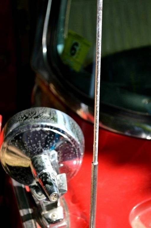

Did a little 'sample' cleaning on the chrome just to see how well (if at all) it would come back.

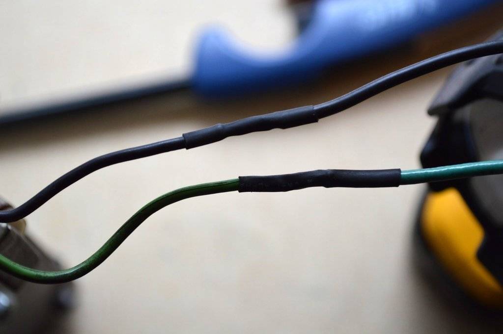

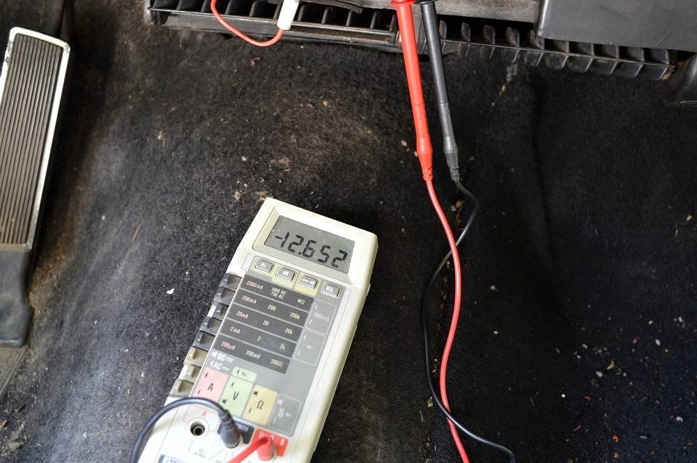

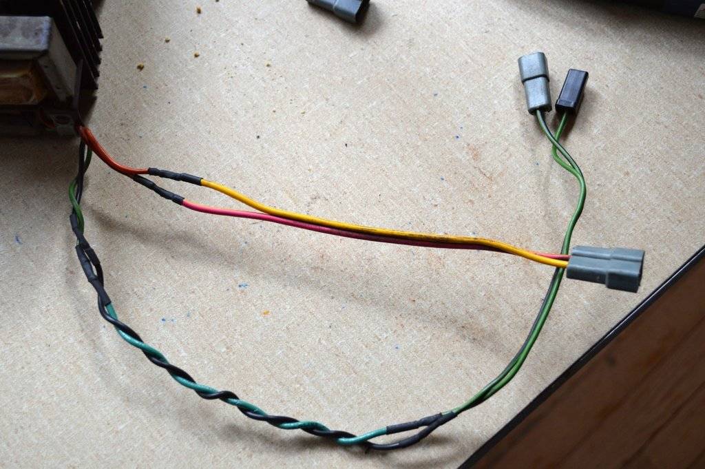

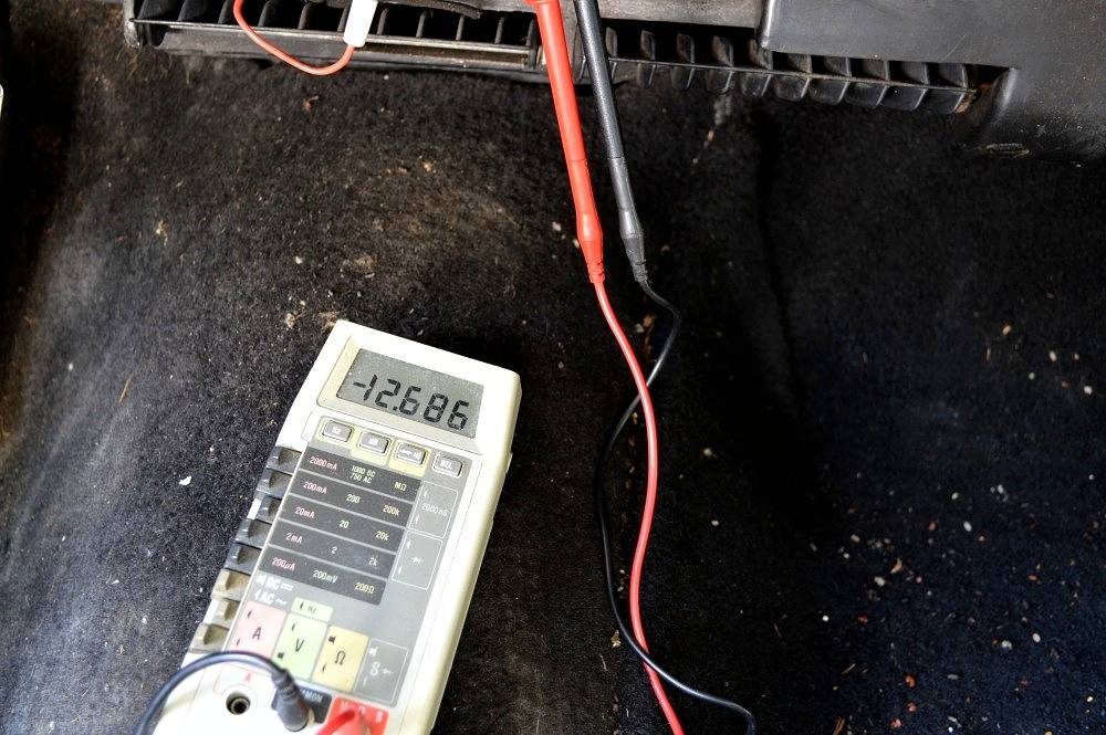

Moved on to the directional signals my buddy had mentioned were non-functional. Grabbed my trusty Fluke meter and checked for voltage at the flasher plug. Sure enough - 12 volts in each position. Picked up the flasher unit and noticed it rattled inside. Huh...not supposed to do that. Hopefully another easy fix as soon as the flasher and bulbs arrive.

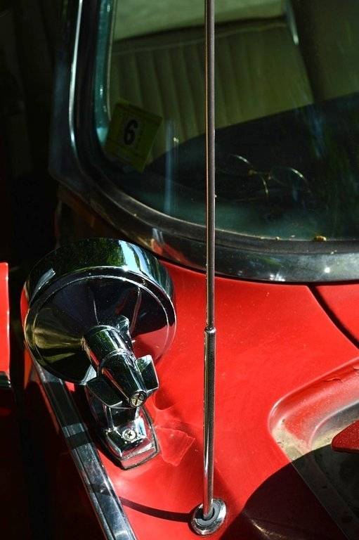

Worked on the aerial yesterday evening. Couldn't find my electrical spray contact cleaner so I used the next best thing, the trusty standby: WD-40. Shot some into the switch, worked it up and down, no joy - up only. Reached around through the missing glove box area (did I mentioned the missing glove box?) and did a Stevie Wonder appraisal of the wire connections. A bit of wiggling and - downward motion! Worked the switch a few more times and wiggled the wires, it now appears to be working reliably. Waking Up An Old Car 101.
Here are a few photos of the progress, including some quick chrome cleanup and voltage measurements from the flasher plug. And whatever else looks interesting.

I like that test instrument. Who makes that.
