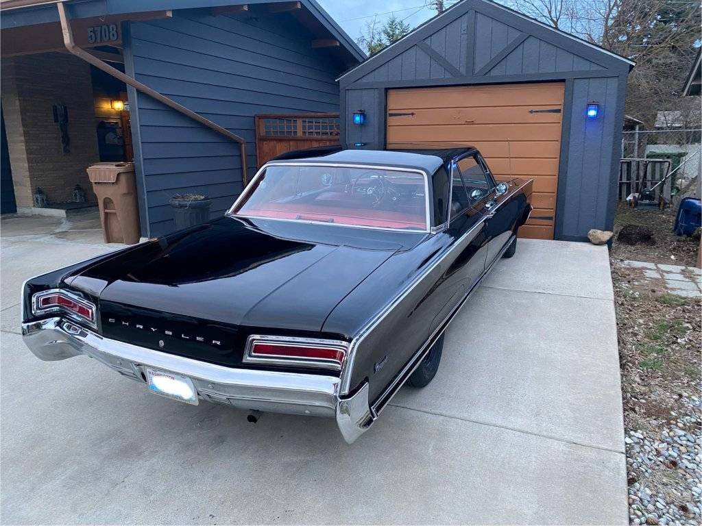

'66 Newport 2 Door hardtop
Thanks! Great car! Great video! Your improvements are Tastefully done and maintain the "feel" of the car.
Work on these beautys is never "finished". That is the lure of the hobby- always plans for the future. Now, after over 30 years, I am re-doing what I did when I first bought the car. Still enjoy the"work", but it takes longer!
Enjoy the fruit of your labor, and keep us posted! Lindsay

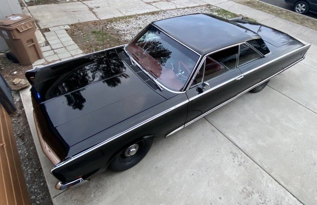

All of the oddities that I was having after starting her up for the first time since November have cleared themselves out. The light was good this evening so I took some photos.

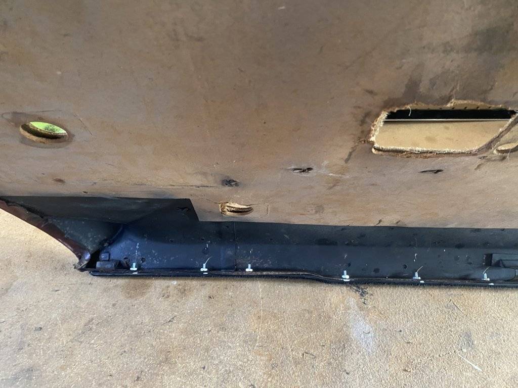

While making some adjustments to the drivers side mirror so that the wing window would not hit the mirror when opening it, I discovered the underside of the drivers door looks like a scene from “when blackheads attack.” I’m not sure how the top of the door would get that much rot, or why smearing a thick layer of grey filler was the best solution, but it looks like that’s what I have.
You’re looking up from the bottom of the door towards where the mirror mounts. You can see the fresh black clips from the new cat whiskers that I just installed.

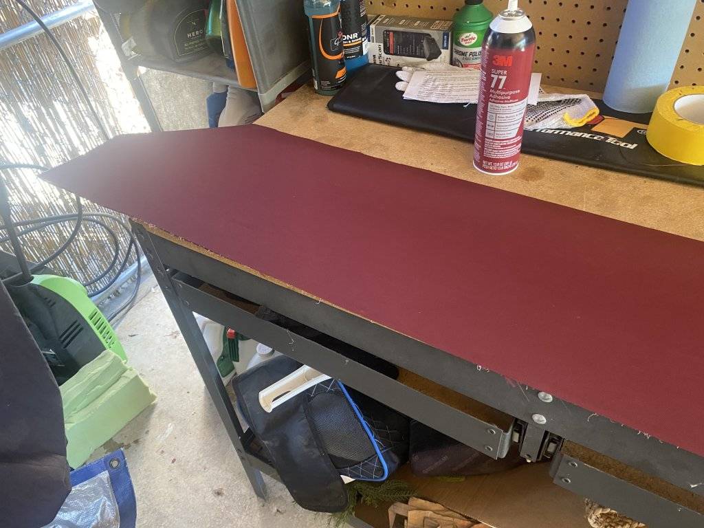

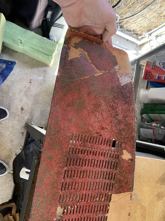

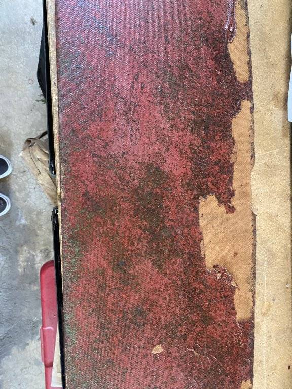

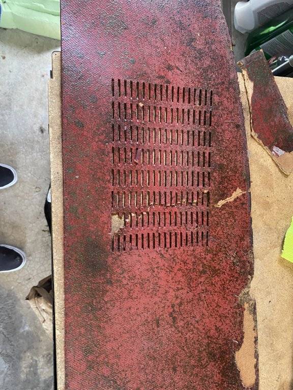

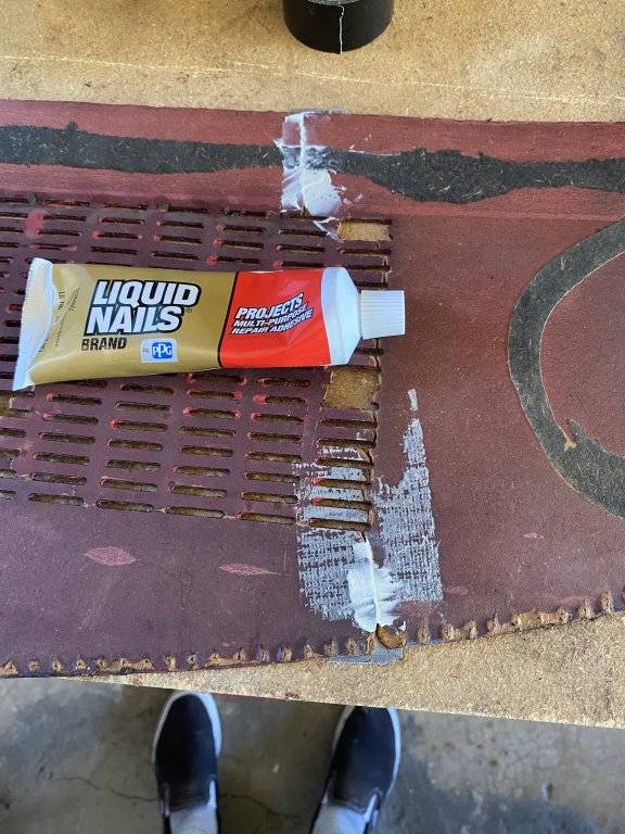

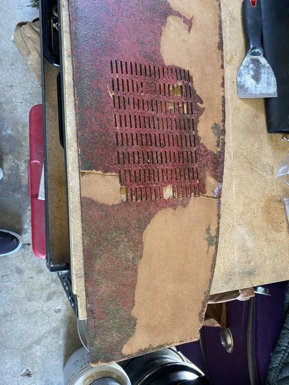

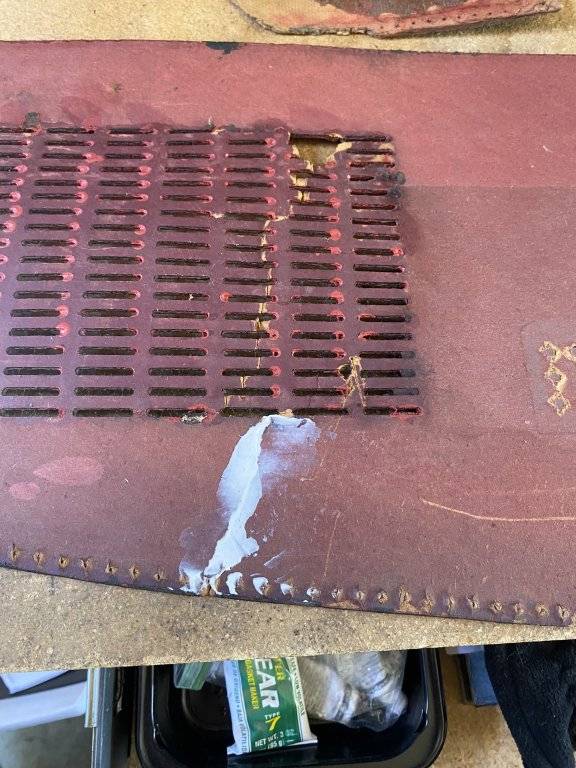

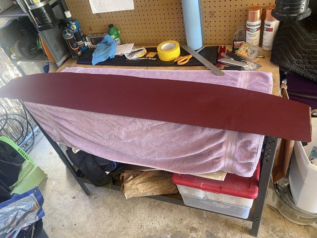

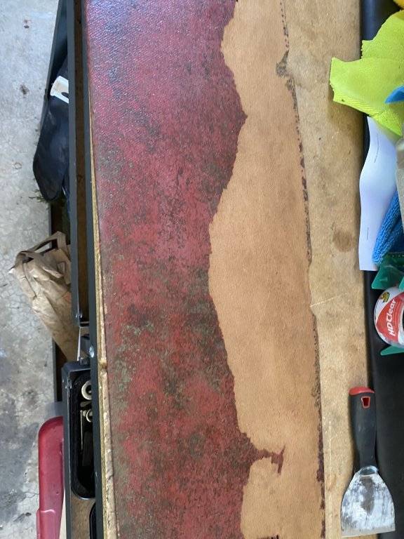

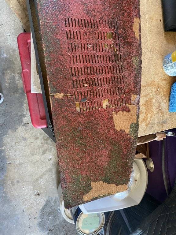

Well, while working on my leaky rear window problem, I decided this is a perfect time to rejuvenate my package tray. I considered buying some hardboard or Masonite, and a jigsaw, and making a new one from scratch, but then I figured my original wasn’t so bad. It just had a few broken pieces, and if I could Tape them together securely enough, I wouldn’t have to worry about the cuts for the speaker holes or anything else like that. Here’s my progress so far, it’s not yet installed.

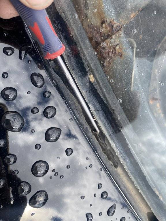

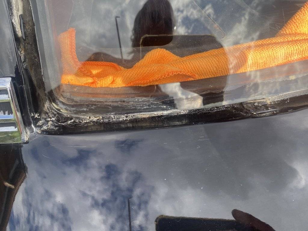

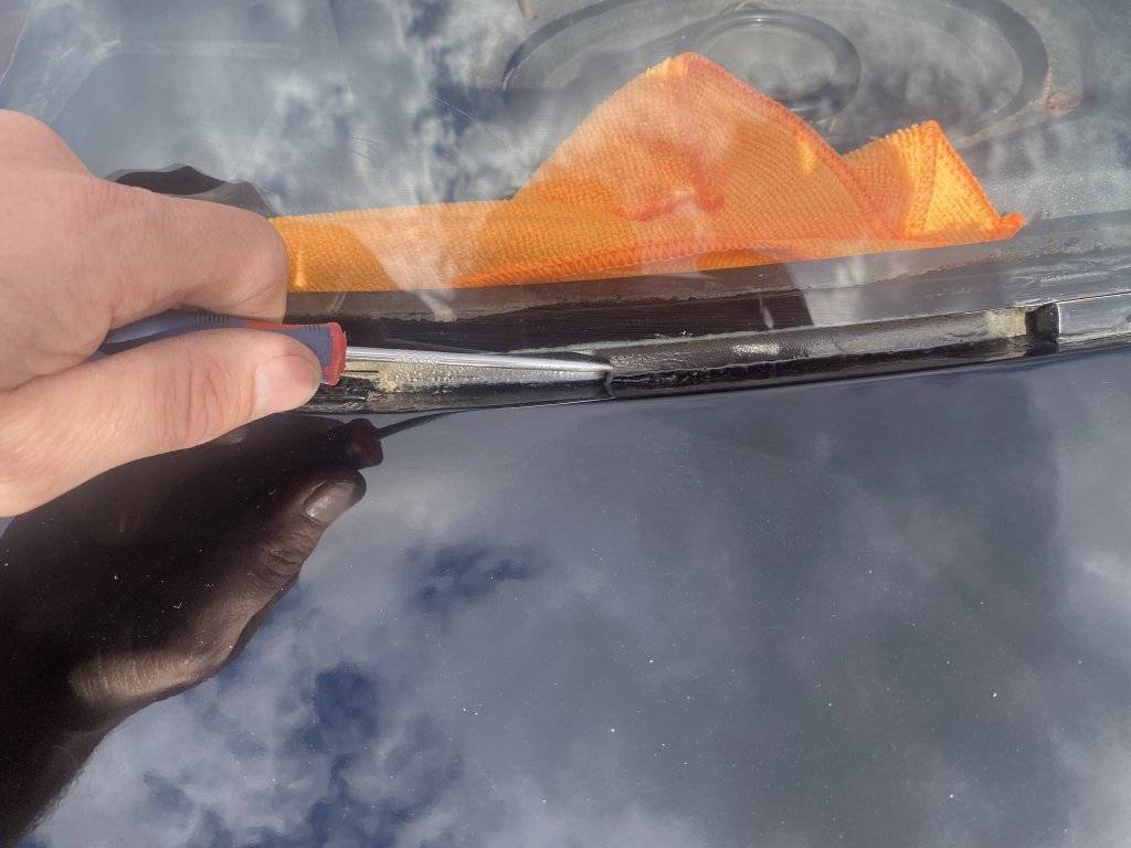

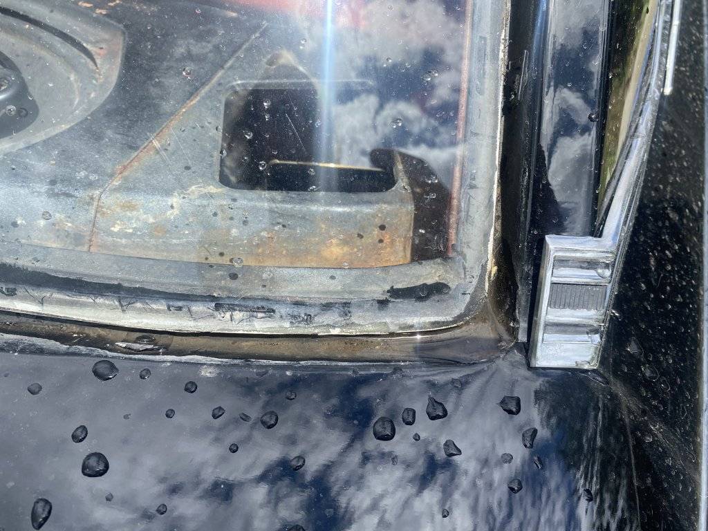

I got the rear window trim removed today and found what appeared to be three or four small holes in what I think is the sheet metal. I’m gonna get it all cleaned up so I can tell what I’m looking at and then go from there.
After some cleaning, I can see that it’s not the window seal that’s bad, but rather some pin holes on the metal trough directly under the glass. I know there’s a proper way to fix this, but I’m not gonna do that at this juncture. I’m thinking some sort of caulking; something that will buy me 5 years or so.

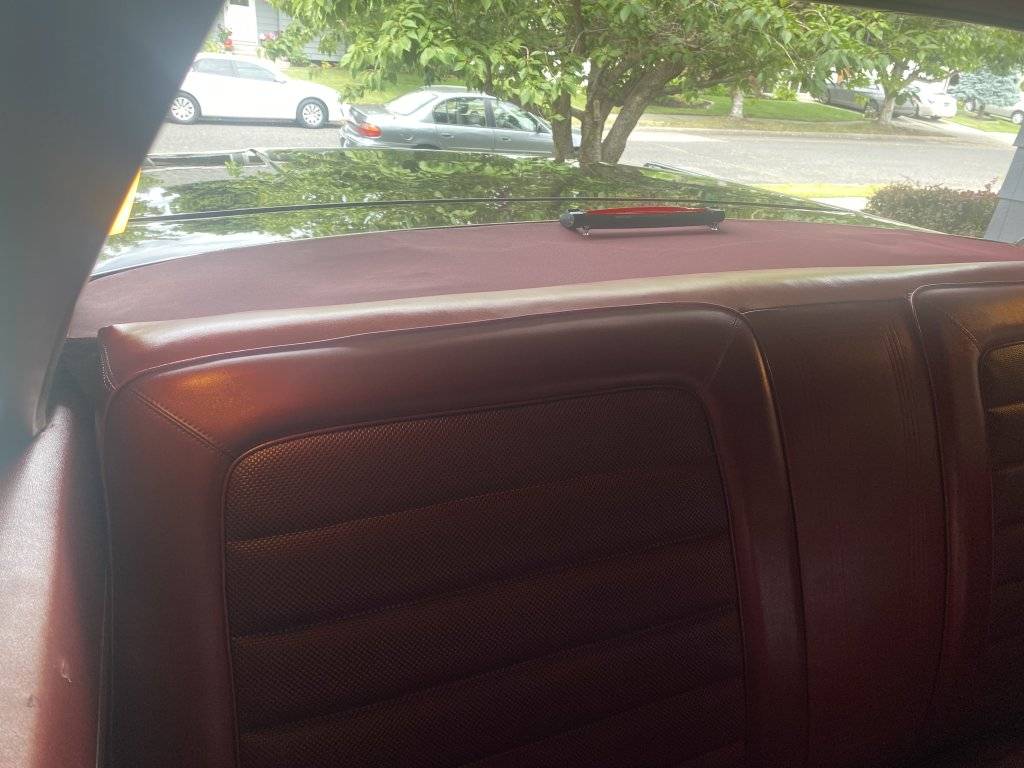

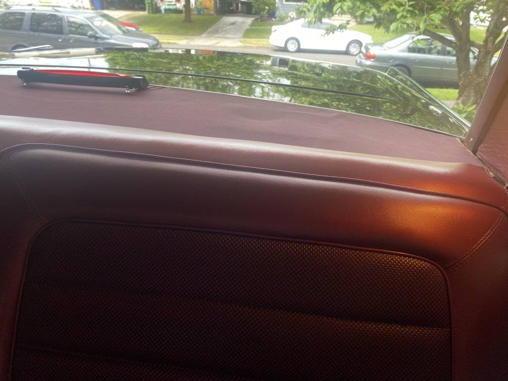

After successfully repairing the leaky rear window channel, I got my newly refurbished package tray installed. I used a piece of marine canvas that was UV resistant, mildew resistant, everything resistant, and it matched the color of the interior perfectly.

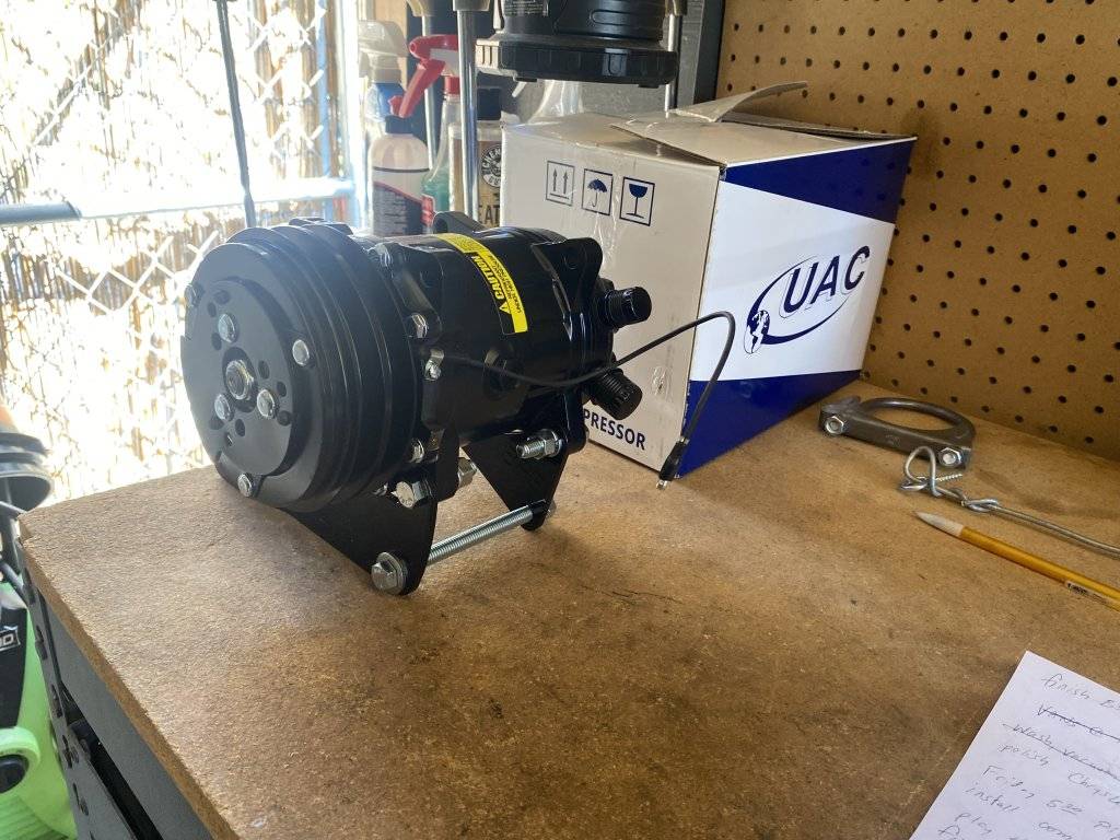

Well, after another HOT summer that made driving the Newport unbearable due to its non-functioning AC and Formal Black paint, I went ahead and got the “hard parts” for an AC upgrade. I’ll purchase and install the “soft parts” in the spring and get it charged up at that time. I went with a UAC 6664 “Sanden” style compressor paired with the 4710 bracket kit from Bouchillon. In the pictures below I have removed the RV2, and mocked up the compressor. I was trying to have the inlet/outlets facing 3 o’clock, but I discovered they are much too close to the valve cover that way, so I’ll clock them back to 12 o’clock. I’m planning to get all the bolts in place and the belts back on tomorrow so I can drive it again. I’m a little anxious about it all going back together OK because the PS bolt they provide is about 4” compared to the 3” factory one. Hopefully those AC belts will line up with the alternator OK.
