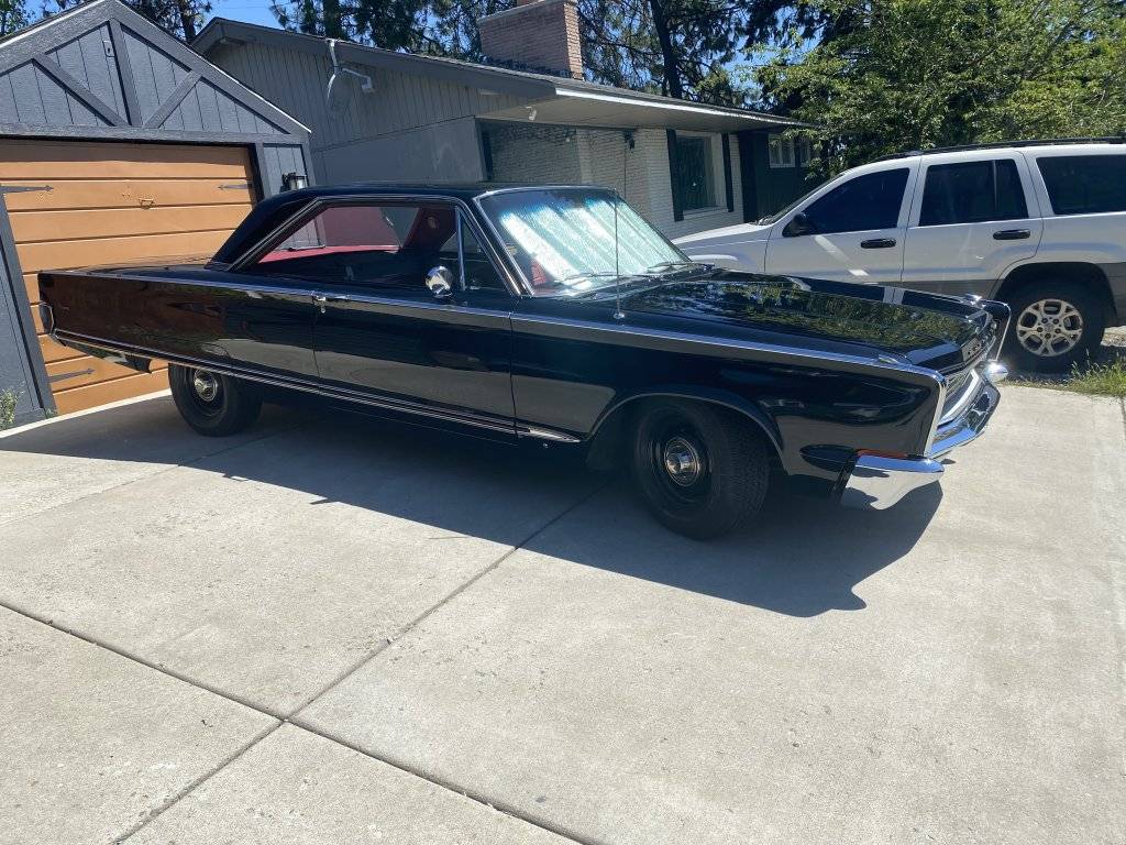

'66 Newport 2 Door hardtop

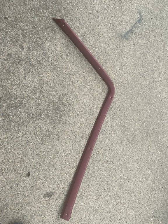

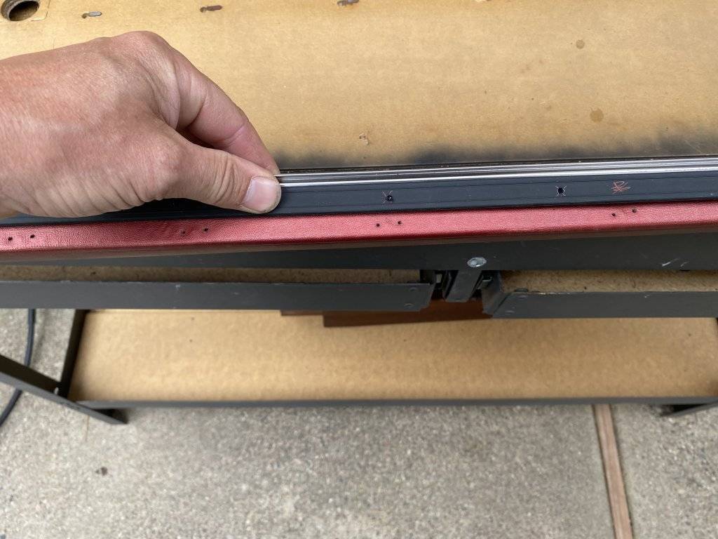

At least it has the 2 white parts, the ones at the rear are the most common ones to break and the front one seems to go AWOL a lot.
yes, on the passenger side the white roller on the front lower angled part was completely gone, and on the drivers side, the double white roller at the rear was broken off.
I have a hardtop finally!

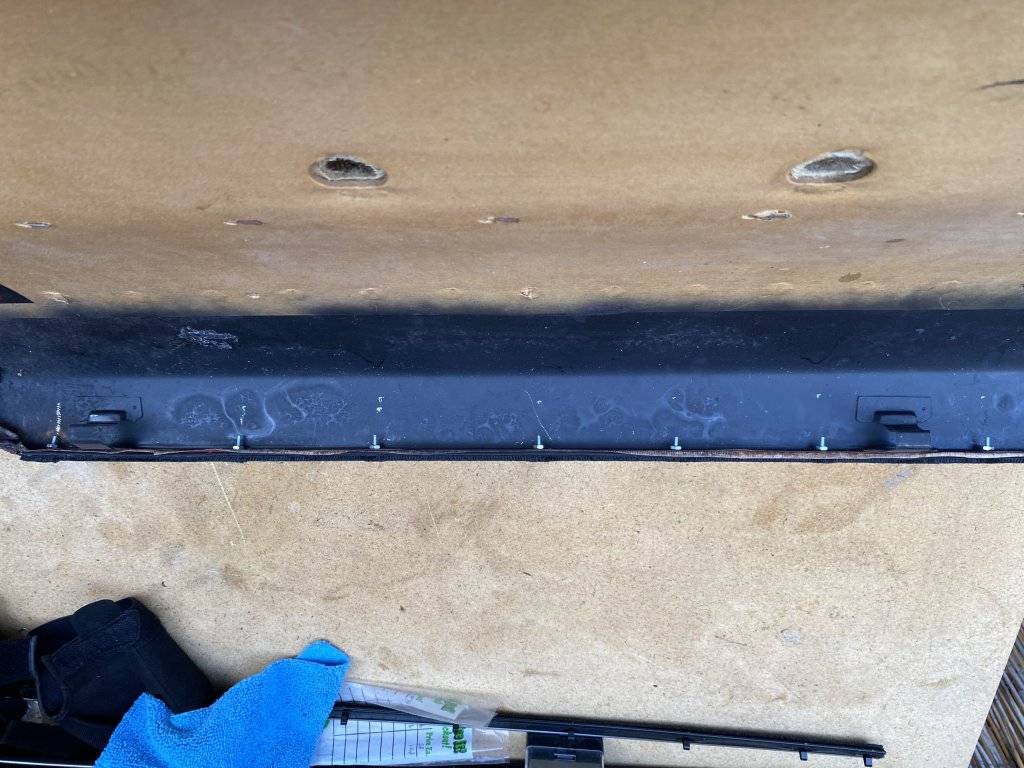

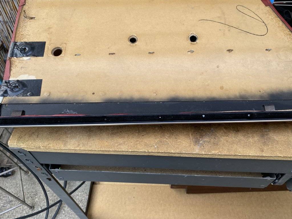

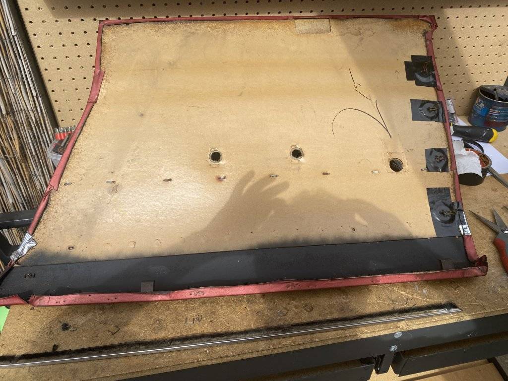

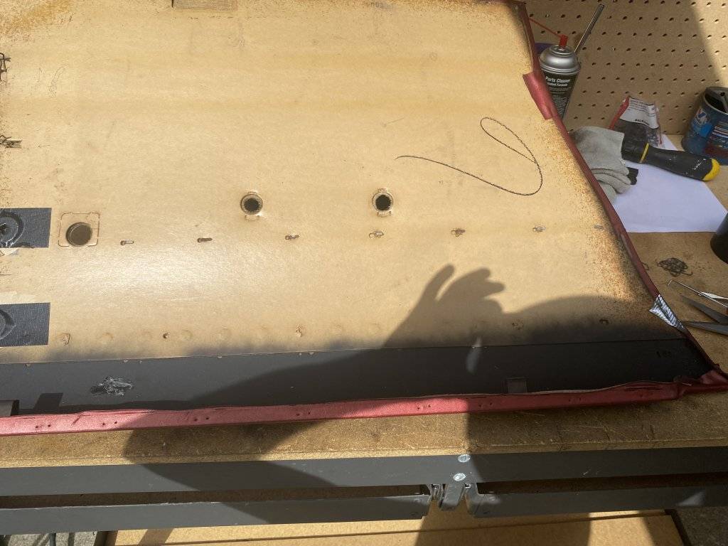

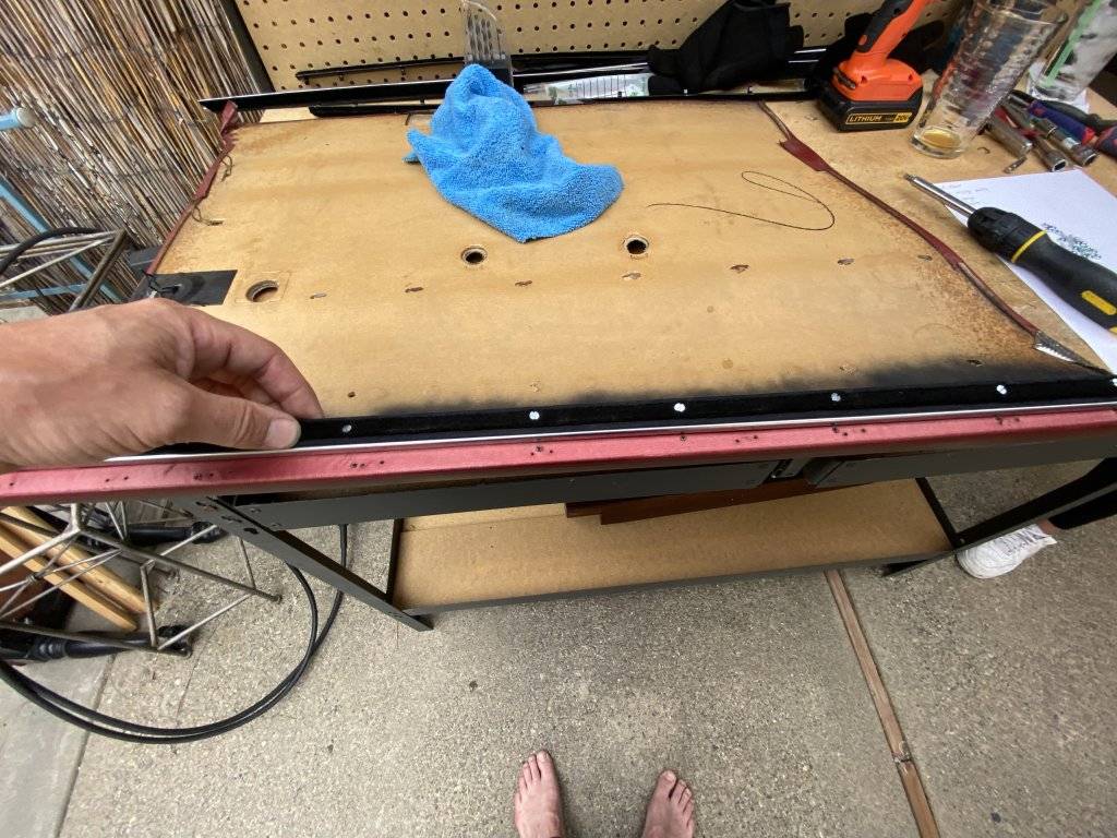

Originally I planned to write a tutorial and photograph the process of removing, repairing and reinstalling the driver's side window and regulator assembly. The whole process was such a nightmare that I decided to forgo doing all of that on the driver's side, and instead just replace the broken wobbly roller, and lube/grease the hell out of everything else.
I had broken the upper front track slider bit on the passenger's side, and on a whim, I put it back together with JB Weld. I thought for sure it would break upon the very first time I tried rolling the window down, but to my surprise, it's holding up so far. Lots of grease seems to help. I have 2 more coming from eBay in case it does break and I have to replace it. Hope I can remember how to get it all apart and back together if it does - it took about an hour of trial and error just to get the front rail and two sliders installed.
I have new cat whiskers coming from Dante's Parts, so I'm waiting for those to arrive before I put the interior back together. I'll take pictures of that process . . . .

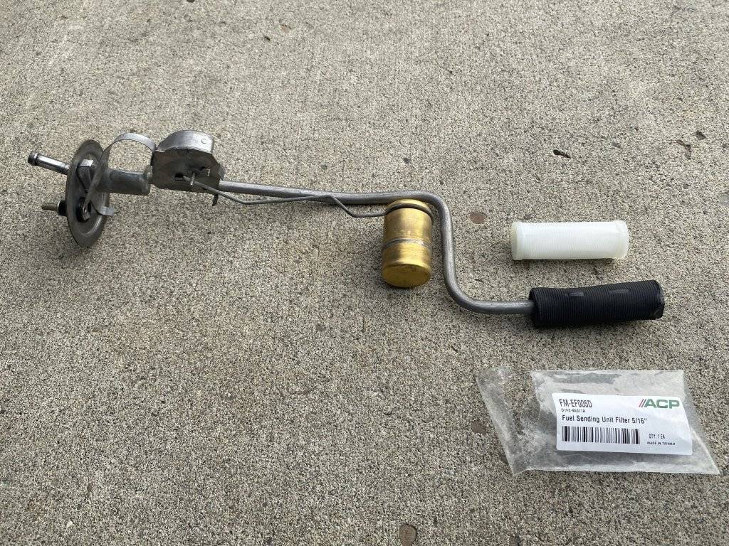

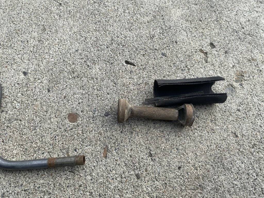

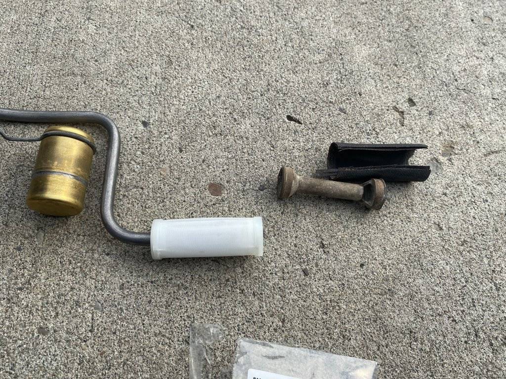

I swapped out the 57 year old in-tank fuel filter today with a new replacement I got on Amazon for only $15!

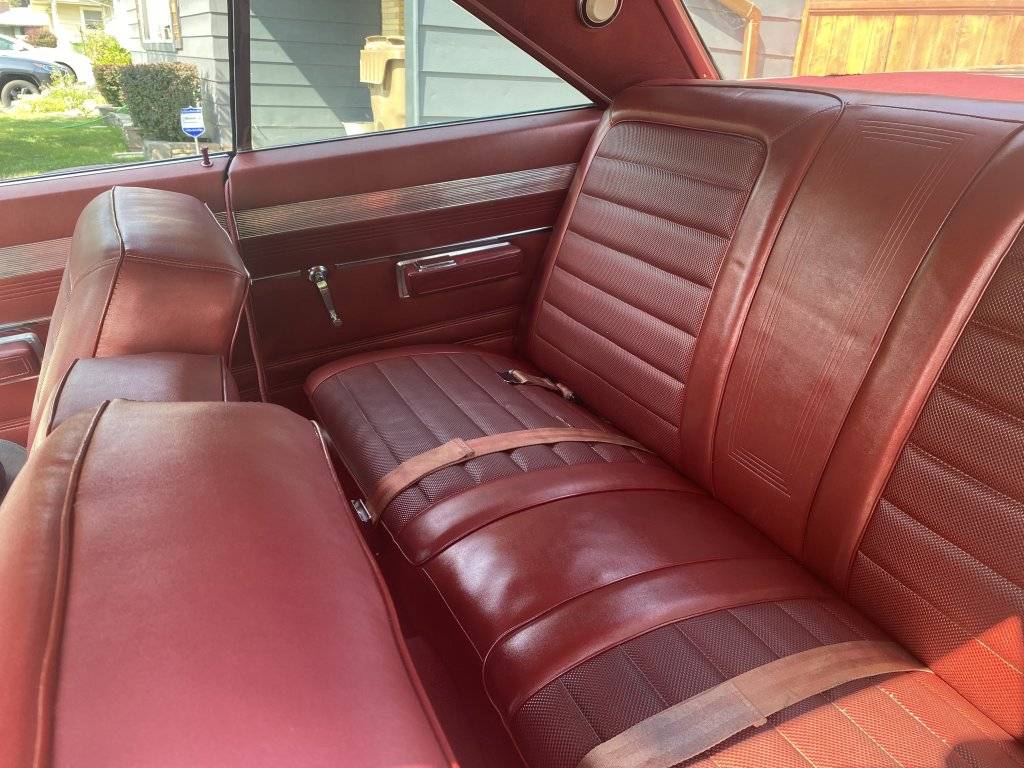

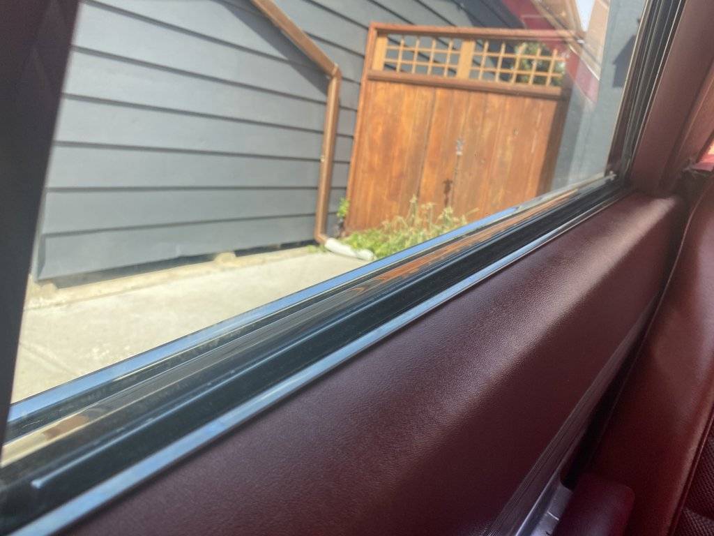

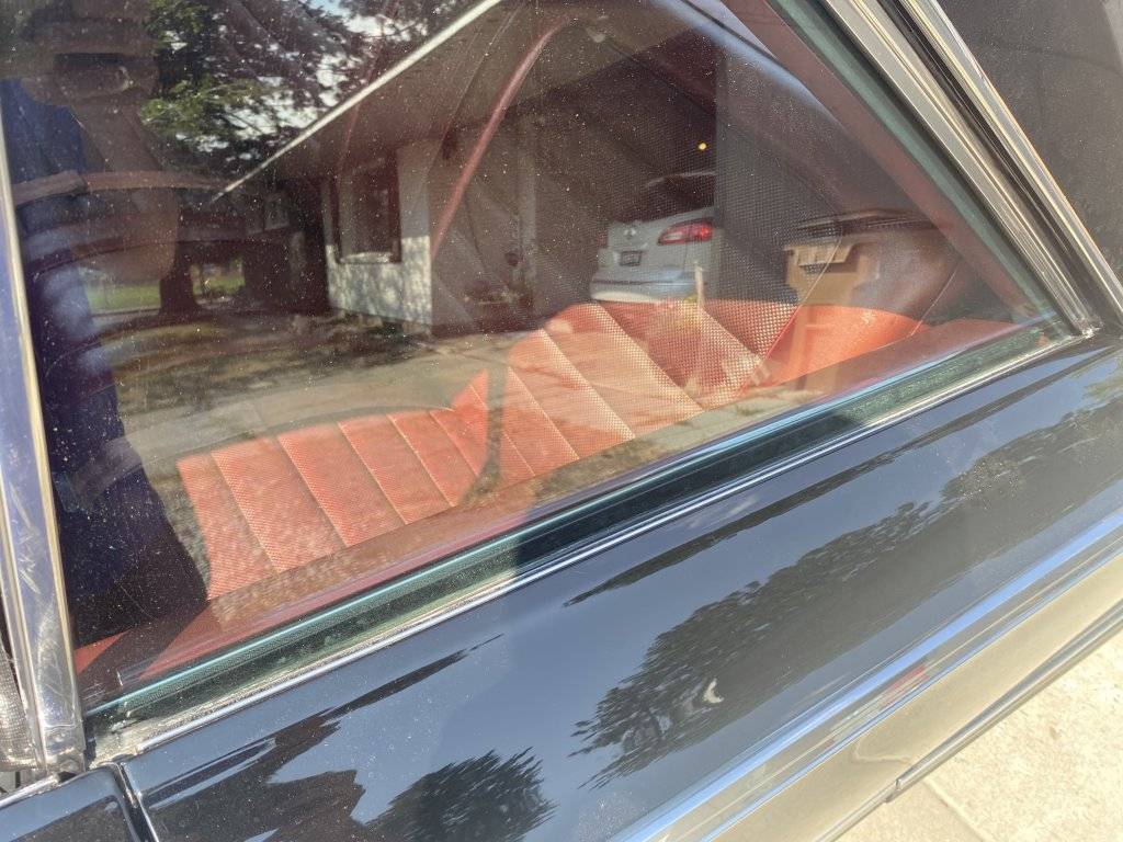

Well, a month later, it’s all put back together. Rear quarter windows technically work.
The driver side rear quarter works pretty good on its own, but it does like to have some assistance pushing in the back corner as you roll it up, otherwise it hangs up on the rubber trim. Would’ve loved to kick the glass out towards the rear a little more towards the outer cat whisker as that would’ve fixed the problem, but I was out of adjustment.
The passenger side is much more finicky and likes to pop one of its roller wheels off if you go up and down too many times in a row. It seems to work pretty well on its own without assistance, but having it occasionally throw that roller makes me nervous to roll that window down, ever. I’ll probably just leave it up 99% of the time.
Would I do this again? Absolutely not. I probably have 30 hours into rebuilding, repairing, and adjusting the rear quarter window regulators and assemblies. Adding new cat whiskers and window seals certainly added to the amount of time, as the windows want to catch on them and hang up if anything is even slightly out of adjustment. I’m sure as the new materials compress it’ll become easier and easier to operate the windows without things catching.

* replaced mini voltage regulator for fuel gauge
* replaced leaking fuel sending unit float and disintegrated filter (gauge now works!)

* replaced broken/missing nylon/plastic rollers in rear quarter window assemblies (greased everything too)

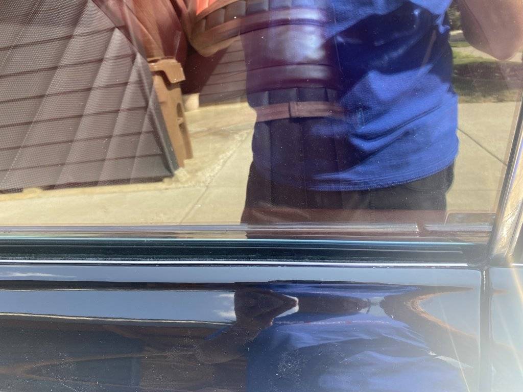

I’ve been super concerned about visibility at night ever since I got this car, so after many other distractions I’ve implemented @CBODY67’s good advice and applied white reflective tape to the side trim. In indirect light you can’t even see it, but in direct light, it reflects white. I can now drive at night time with less anxiety!
