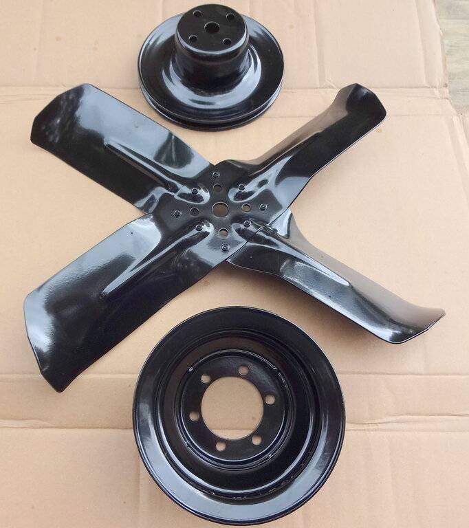

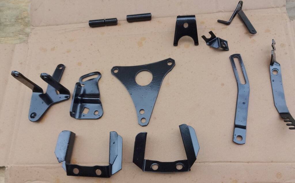

Today I got the parts back from the powder coater. They did a fine job, as usual.
Sweet Will, nice work! Will you be driving this up to Michigan this summer?

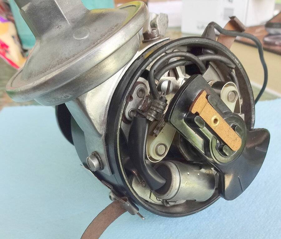

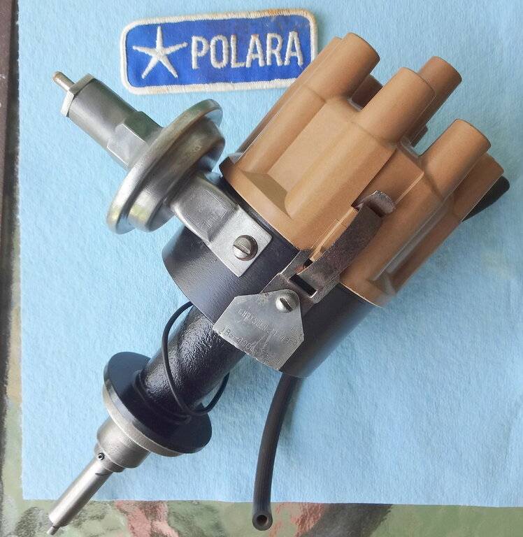

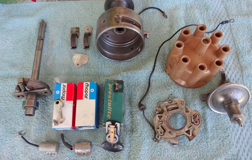

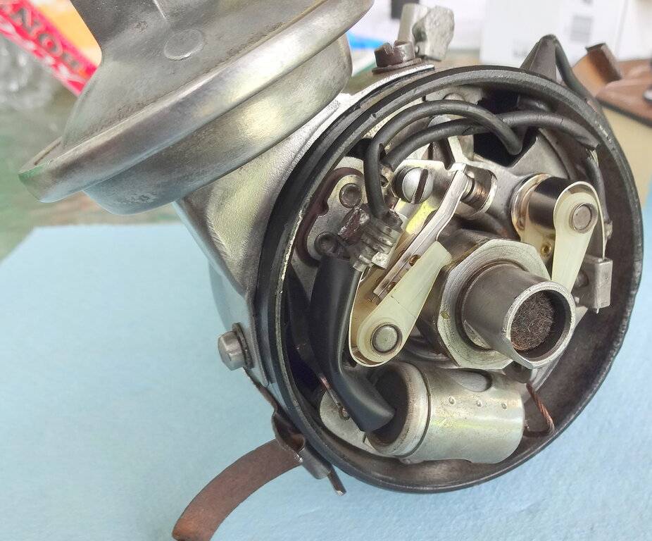

I refurbished the distributor yesterday, reassembled it today. A through cleaning, refinished the housing, NOS Mopar points, and prestolite rotor, and a new cap I got from Ray. One more thing done.

Wil: I love it! So glad to see you are installing NOS points, condenser, rotor, cap, etc. The engine is gonna run great.

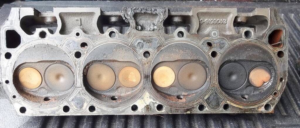

Just for reference, the Polara I have came out of a long time storage and was made to run by the seller. I did a full tune up and made all the necessary adjustments but it still had a "skip" in the engine. I drove it approx. 6-700 miles, (a 550 mile road trip), which was the first mileage on the car in 45 years. The skip was still present. A compression check showed zero in #1 cylinder.
This condition did not occur in the time I drove the car so it may be the reason the car was parked in 1974. 86Kmiles.

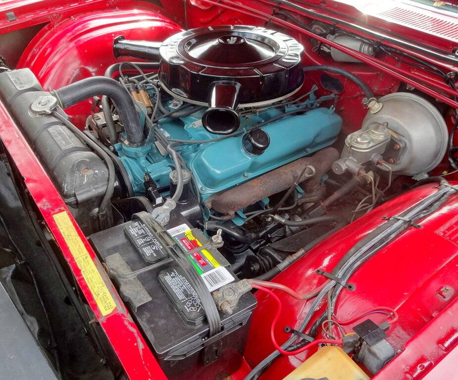

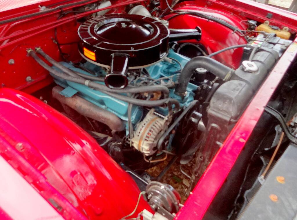

The 383 is back together and runs great! It was my intension to keep it as original as possible, but after disassembling for the valve job it made no sense to put it back together without detailing. I painted the engine but only cleaned, polished and detailed all else under the hood. No modifications except a mini starter.

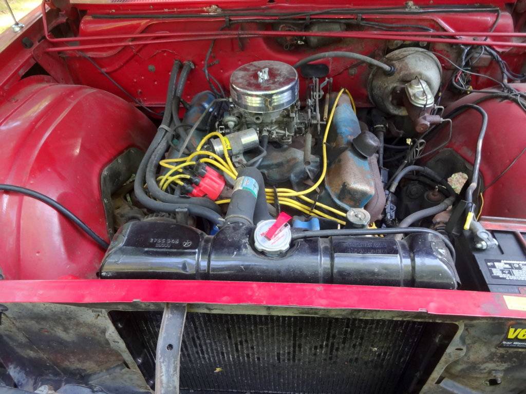

Before.
View attachment 406716 View attachment 406717 The 383 is back together and runs great! It was my intension to keep it as original as possible, but after disassembling for the valve job it made no sense to put it back together without detailing. I painted the engine but only cleaned, polished and detailed all else under the hood. No modifications except a mini starter.
Show-off!

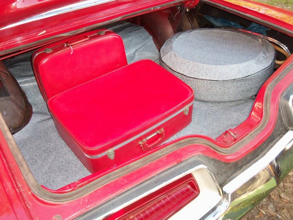

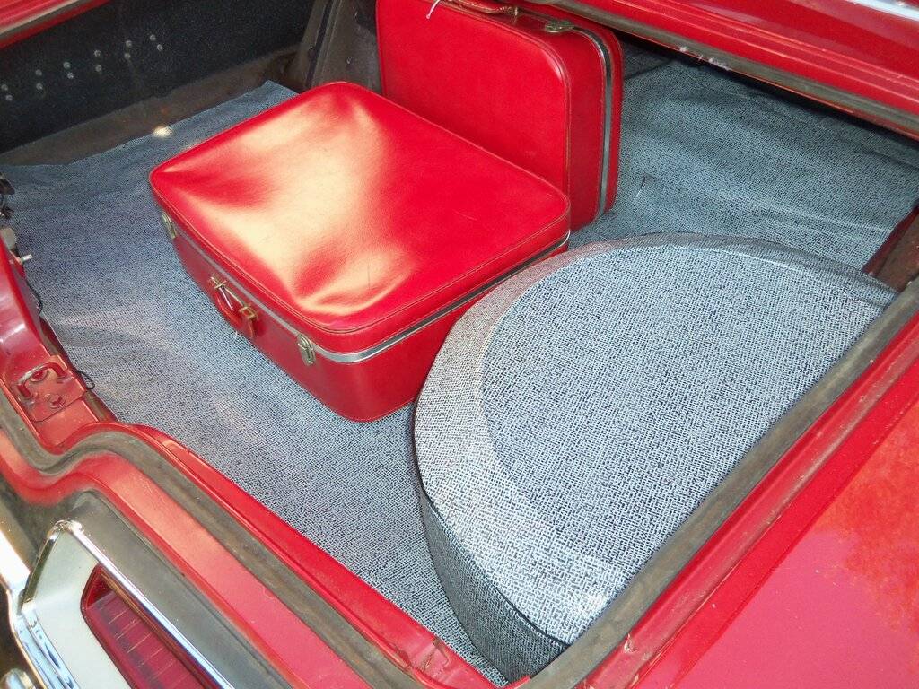

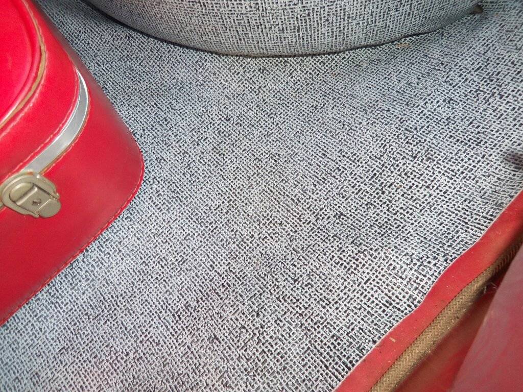

I finally got the correct 67/68 trunk mat, well almost. Had to fight my way through one A** hole and a couple of Morons. Only took 6 months to get it.
The mat is reproduced by REM. If they won't sell direct to you than Vanns is probably the safest route to buy from. Just be specific about your application and the herringbone pattern.
I found the luggage in a junk/antique shop in Michigan, Great place to store my cleaning/detailing stuff.
