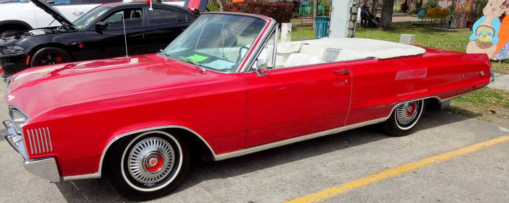

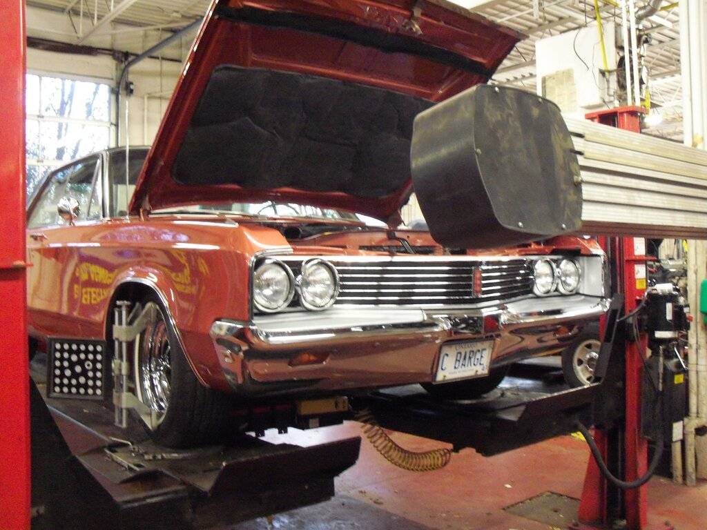

I had the front end aligned in anticipation of the drive to New Orleans tomorrow.
The torsion bars had been cranked up way back in 1974 by the PO. I took a full 7 turns out of the adjustor bolt but it still sat to high for me. I had the alignment guy set the front 1" lower than the rear, (measured at the rocker pinch flange, front and rear), figuring it would compensate for a full tank of gas and a moderate load in the trunk as well as passengers. I now think it's to low in the front, but not to bad. I'll make this trip, (drives great now), and decide if I want to bring the front up an inch later.

This how it looks now with a full tank of gas and some junk in the trunk.

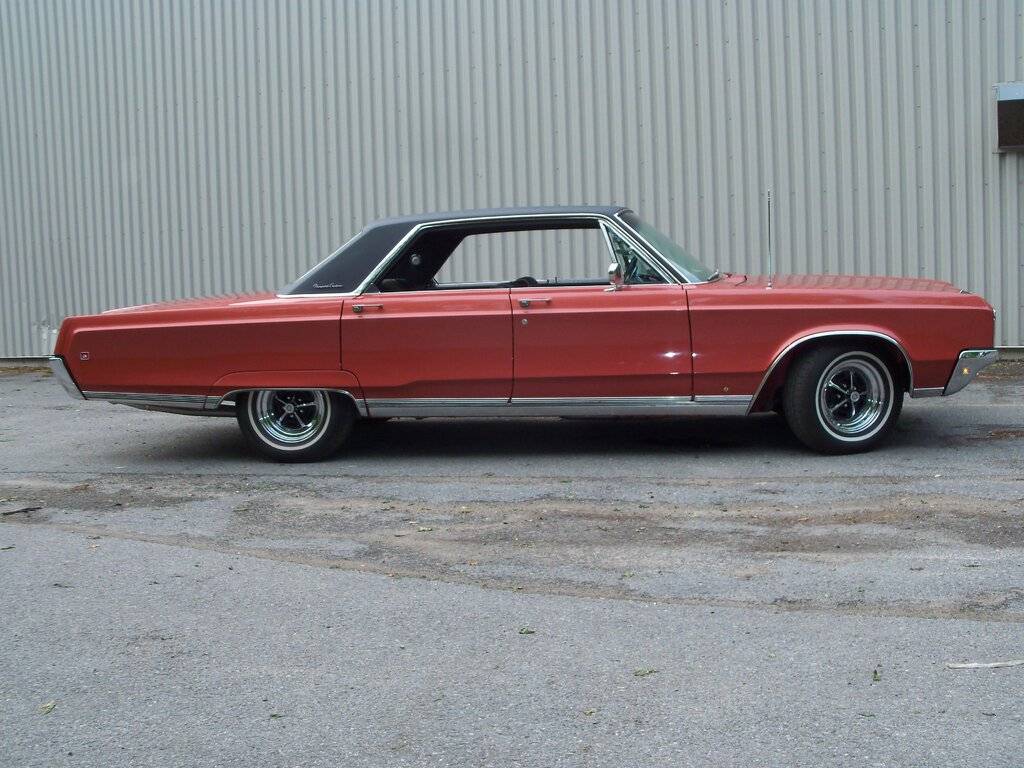

With 15 inch tires,and measuring from center of the front wheel lip to the ground should be 27 to 27.5 inches.
Anything less will be too low.
Your whitewall should not be that close to the wheel lip IMHO.
Basically,the top of the tire should just be at the wheel lip--no gap.

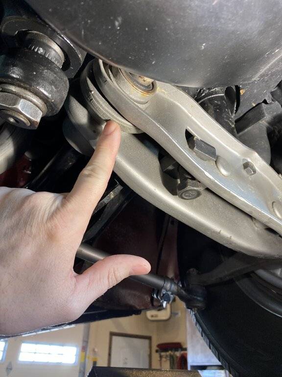

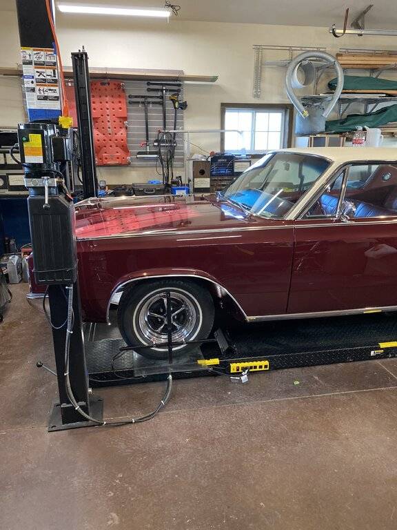

Or you can check the factory spec for the front. 1-1/8” difference from the bottom end of the lower ball joint to the adjusting blade +- 1/8”
With that measurement my front is 8-1/4” from front pinch flange an 9” from rear pinch flange. That is with full fuel and original springs with one spring leaf replaced with a heavy duty one 35 years ago.
side photo from about 8’ ft back car 6” off ground for perspective.

The procedure in the manual was used to set the front height side to side. Actual height was measured at the pinch flange with the front being 1" lower. I think it's just a tad to low in front now... The only thing I dislike more that the front being to low, is the rear sagging. I'll raise the front just a little more and all should be well.

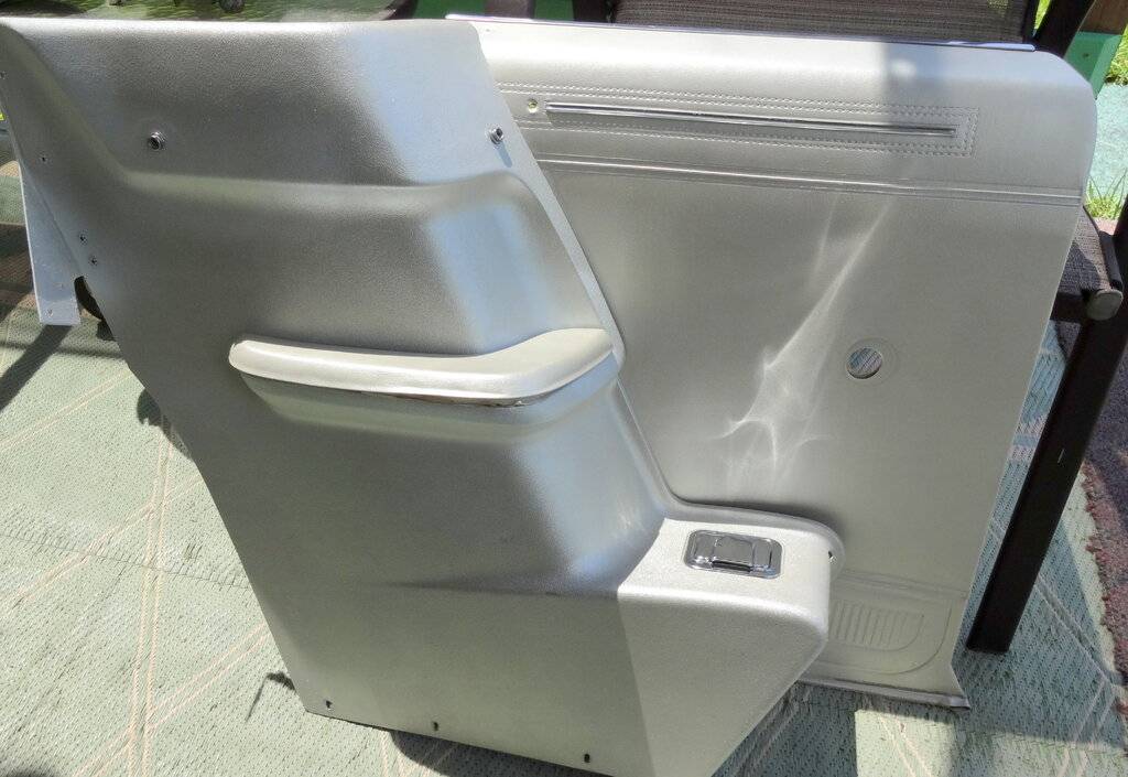

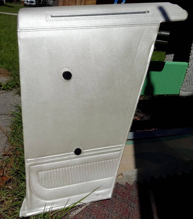

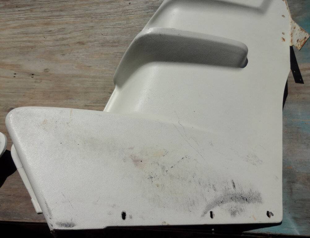

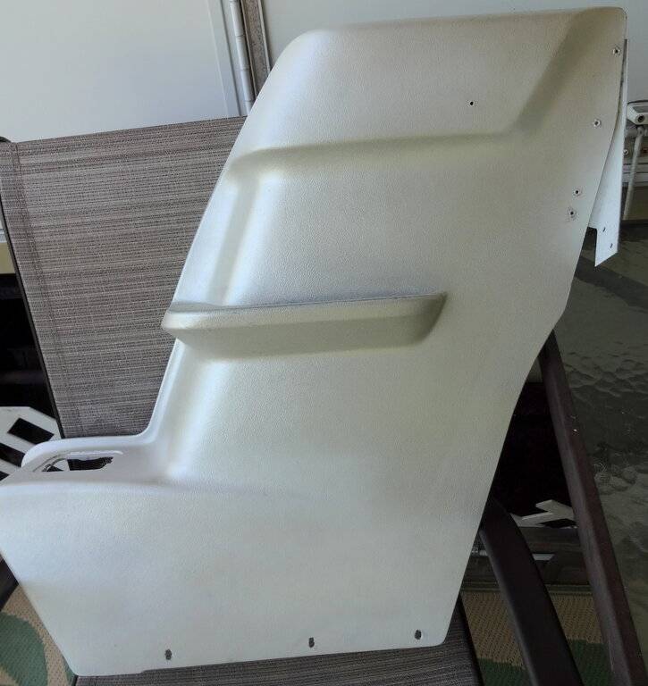

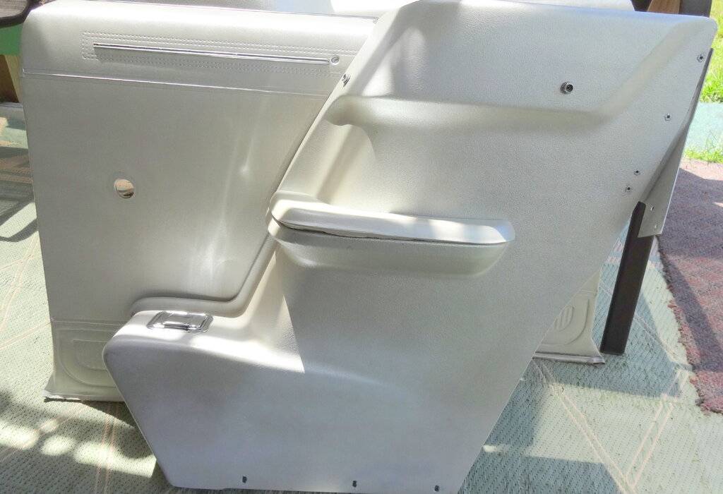

While the Polara is in the trim shop for the new top I decided to refinish the rear interior side panels and arm rests. I used Herbs products, adhesion promoter and interior paint. Great products!
Lots of cleaning and prep involved. The white pearl paint was interesting to apply. Many mist coats with waiting time between them. I wasn't sure until I looked at them this morning, very happy now.

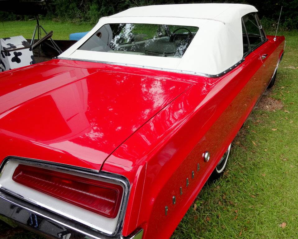

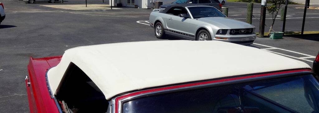

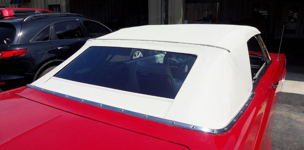

The new top is in place. Looks good. There are some wrinkles but I think a couple days in the sun will reduce them. Works great and seals around the glass nicely. It got rained on the first night it was home ad no leaks.
