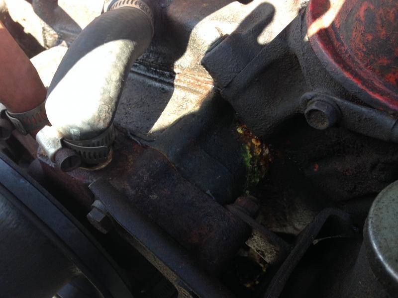

I'm hoping that the coolant is just leftover from the time the thermostat blew a few years ago and sprayed coolant everywhere. Probably not a good sign it happened though.
