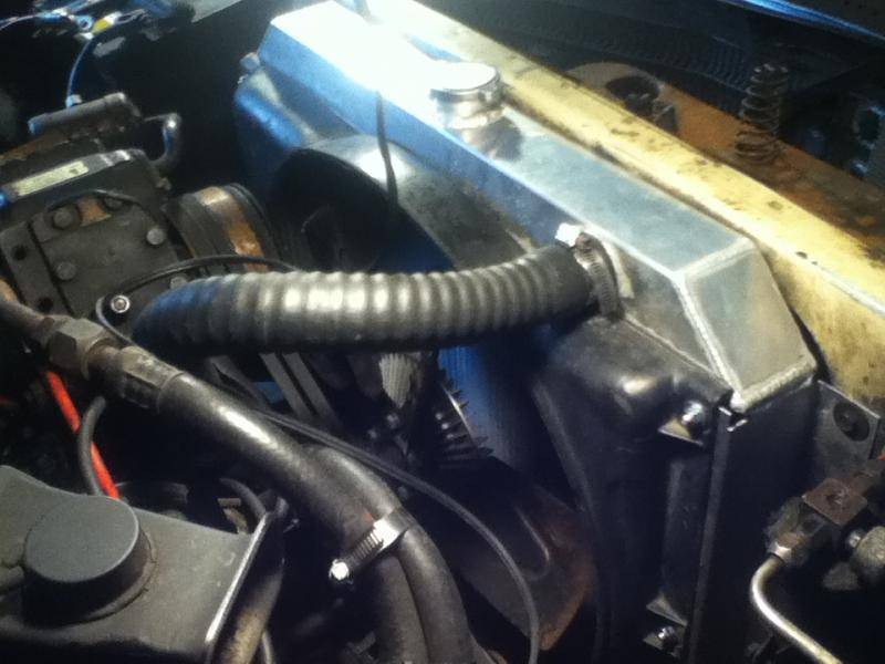

Wow. Lets start with the obvious. The heater bypass hose looks like it's going to cough its cookies at any moment. The upper rad hose may be the right general shape, but it's way way too long and that kink in it is probably contributing to your overheating immensely. Undo the rad end of the hose and let the hose sort itself out. You'll see immediately how much of the disconnected end you need to cut off.

I do plan on just ordering a new radiator as well. I'm having trouble finding any let alone an aluminum model for my car. Would I be better off just buying an aluminum radiator based on measurements and hose locations and not a direct fit? Seems so.
I was looking at something like one of these two with similar size specs and inlet/outlet placement however none of these have the top tank that the stock radiator does. Issue?
http://www.summitracing.com/parts/gri-1-26222-x/overview/
http://www.summitracing.com/parts/sum-381425/overview/
